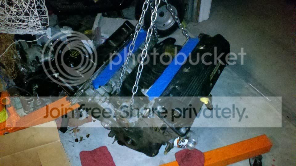

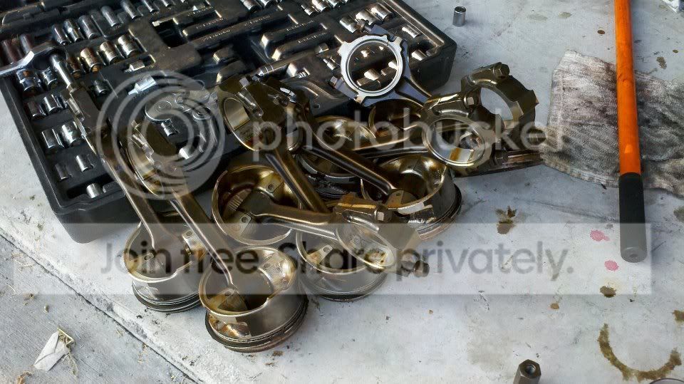

my "project motor" is an 01' pi motor

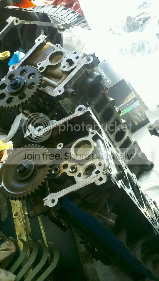

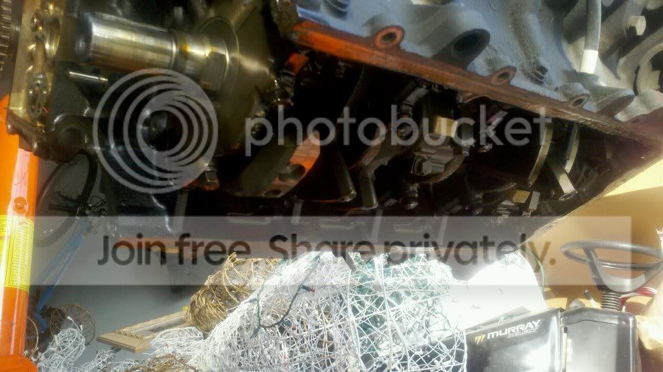

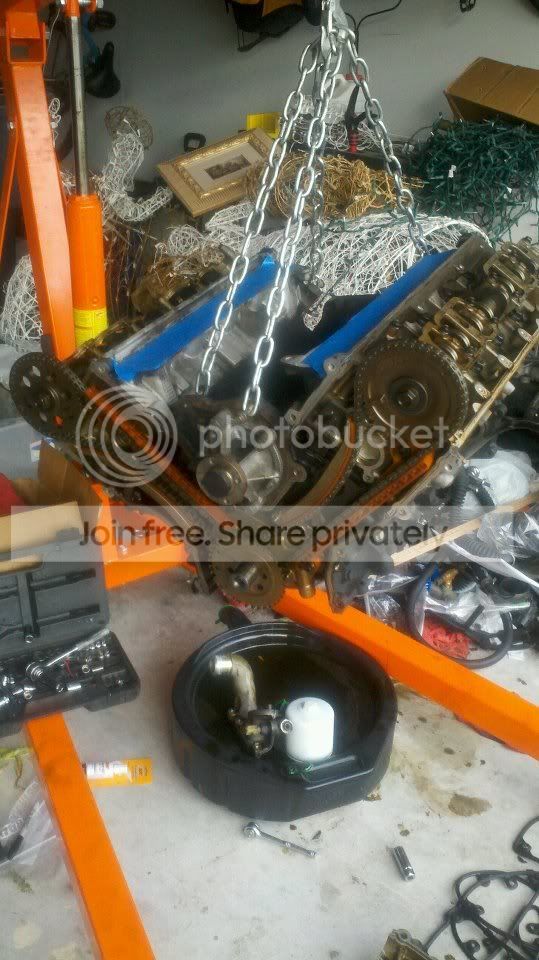

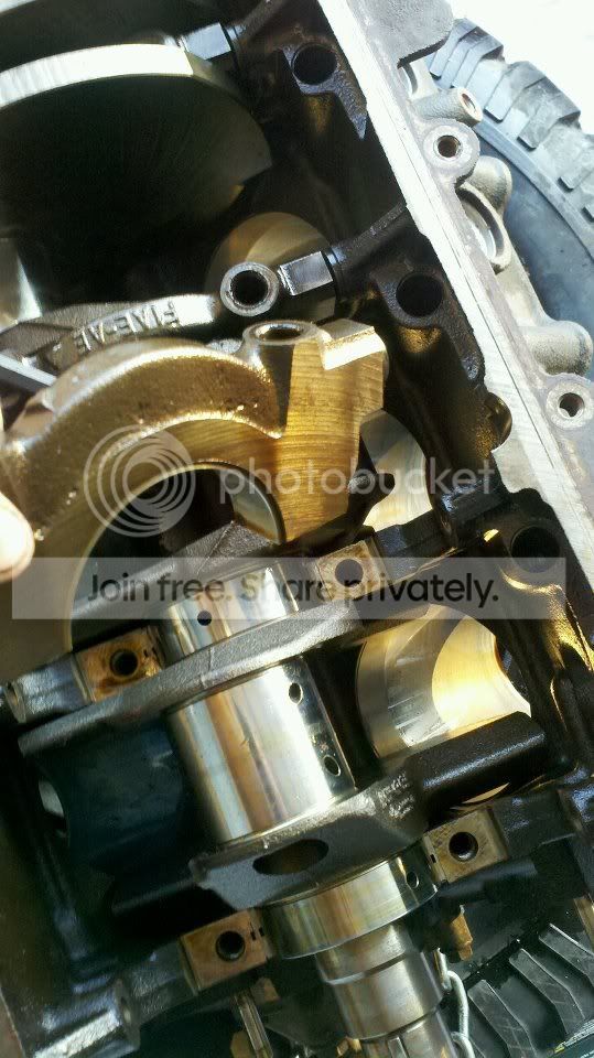

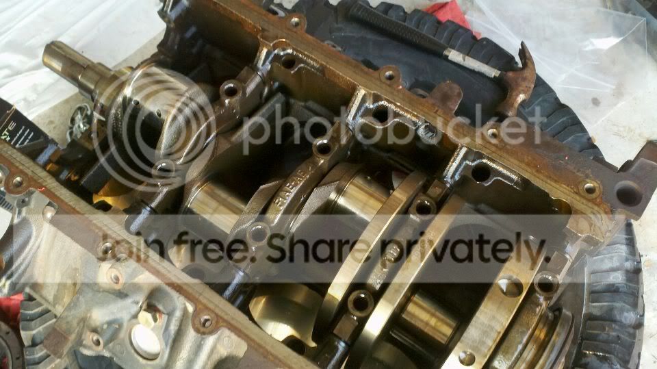

im not going to write out my whole dissassembly..but i'll post photos of it.
the plans for it ar as follow.
01' cast shortblock
manley rods and pistons
stock crank
B cobra heads <---ported
cobra intake <---ported
comp cam stage 2's
planning to hook it up to a t45 or 56. (car is auto)
