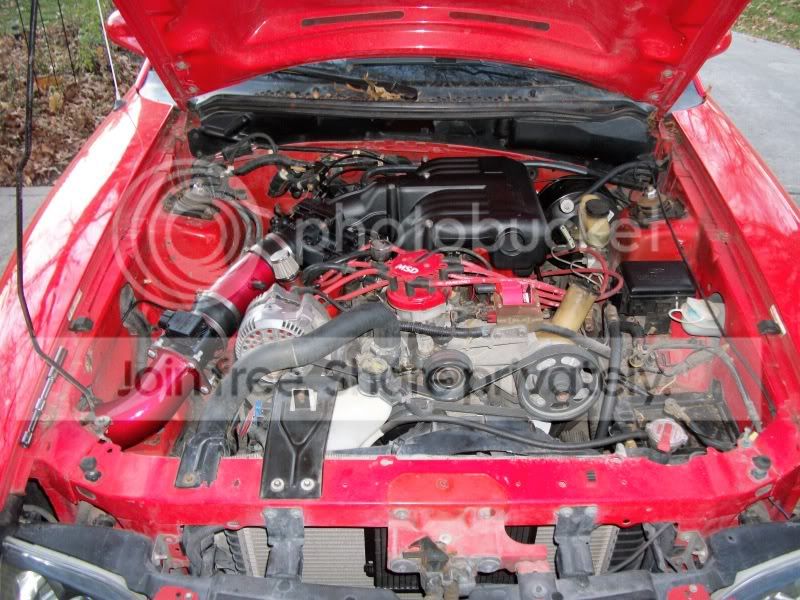

jthorn9 what would i need to put a gt-40 on I'm looking at one right now,and it's at a good price.I'm asking you because you have one on any info would be very helpfull thanks
wytstang
Jan 11, 2006
2,152
If you use a 93 Cobra you will need to bend the egr tube and extend the throttle cable since it has the egr built in. Adding the elbow will move everything forward. Aftermarket fox intake don't have the built in egr so the elbow lines up with no issue. Also I like the Ford Motorsport SVO 94/95 Cobra intake version.
That's the one I used to have before, that I bought from Summit prob. 8 years ago if I remember right. Then I got my Kenne Bell, sold that and bought just the upper GT40 from Summit.

I like the cursive scribing. When I clean up the engine bay I'm going to polish the center of it.
That's the old Ford Racing Performance Parts logo.
Ford Motorsport SVO.
