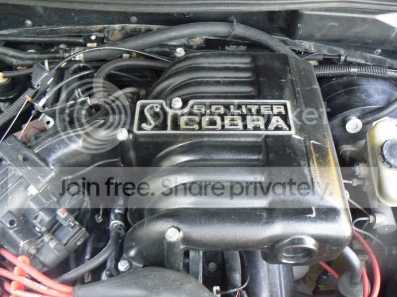

BackinBlack
May 6, 2007
63
I got a 95 Cobra intake. I painted it black and polished the top. Then I had a friend mildly port and polish it. It pulls all the way to 6000 rpm now.
