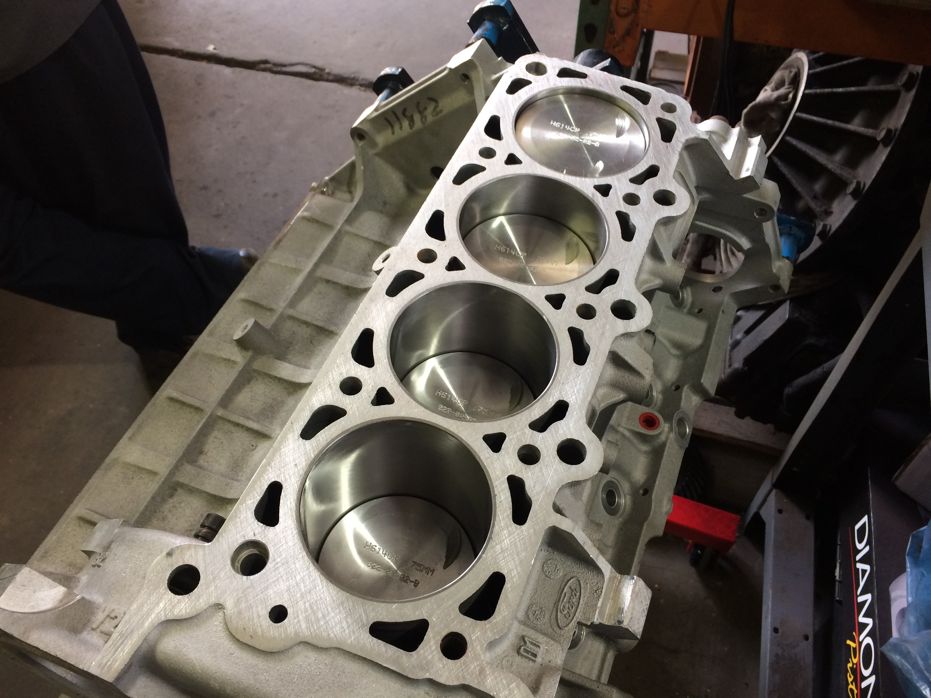

Ok, so I know Ive been slacking in here. Ive got a solid update for you guys though.

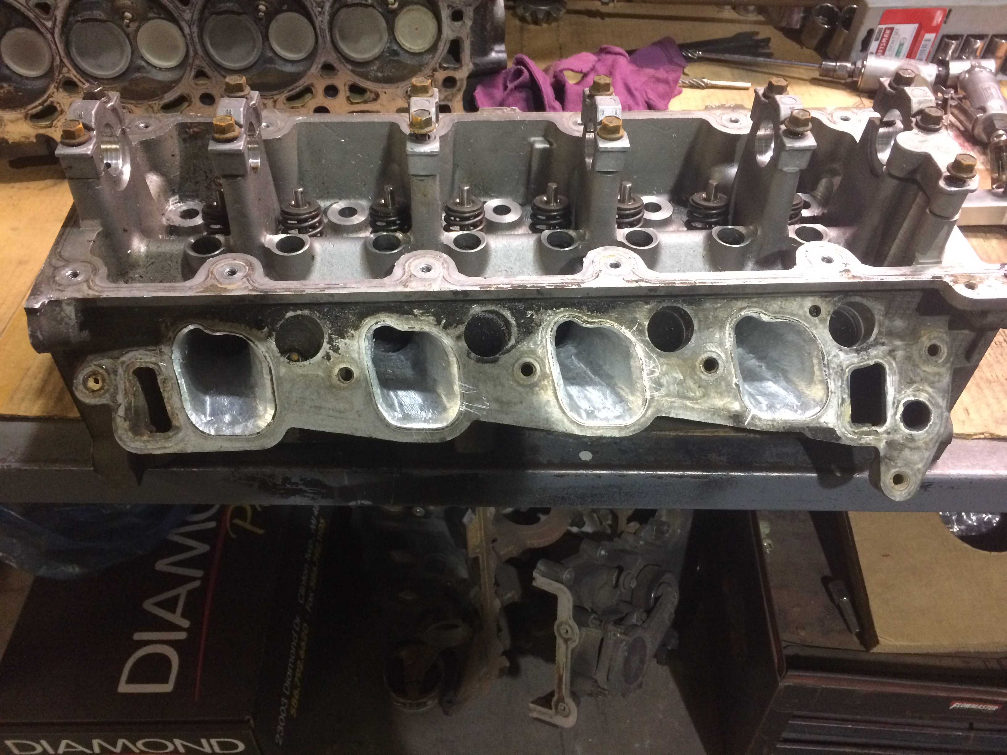

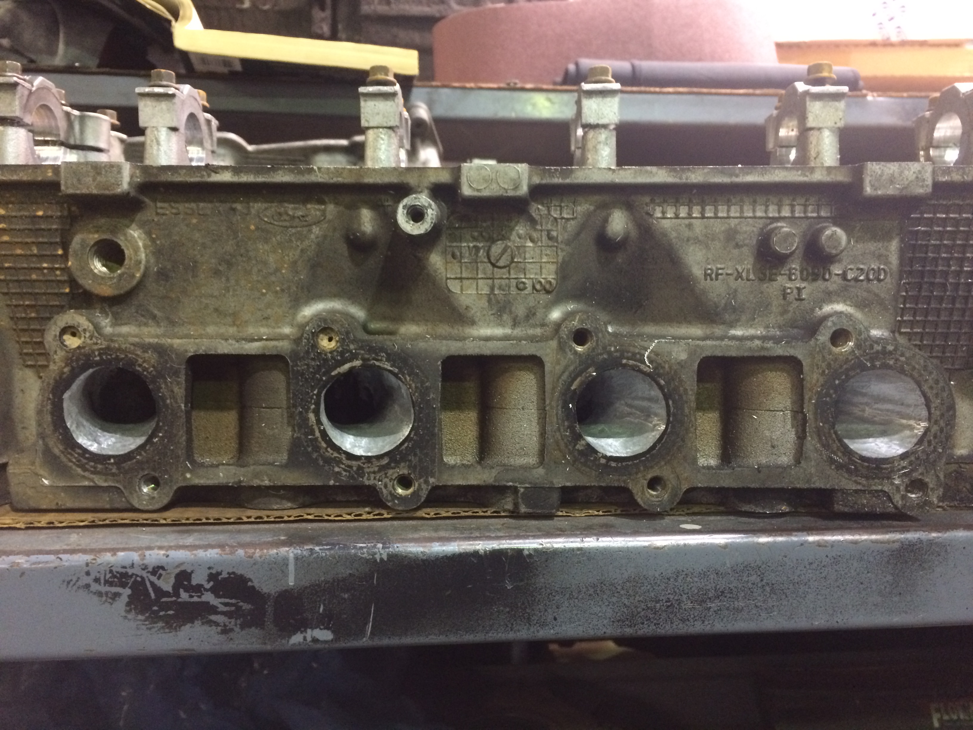

Tore down the heads and did some porting. Nothing too crazy just a little something to help it breath better.
Untitled by William Luketich, on Flickr
Stealth Mare’s engine by William Luketich, on Flickr

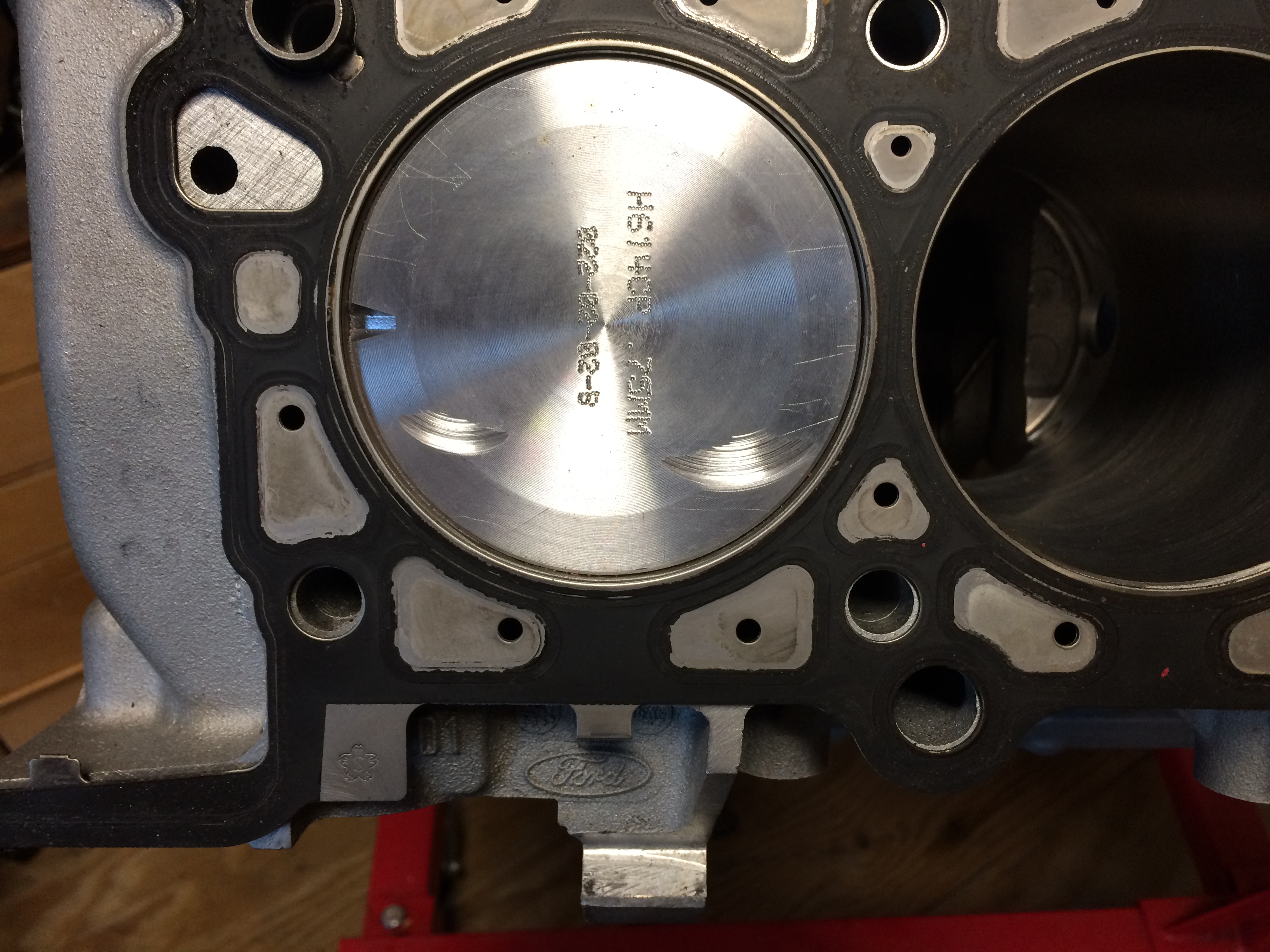

Then hung the pistons and set it up to do valve reliefs.

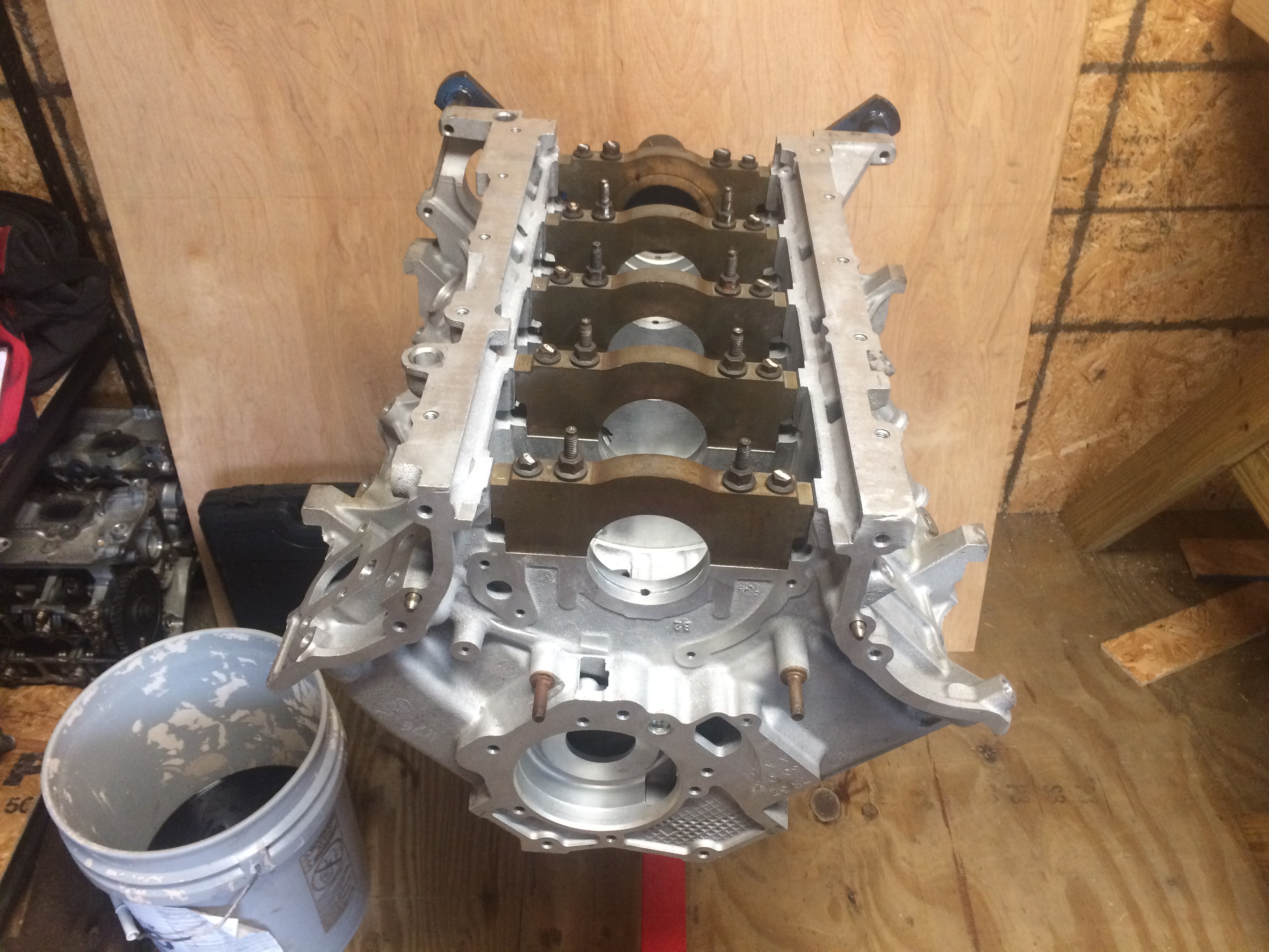

Then brought it back to the shop for cleaning and assembly
Had to drill a new hole for the timing cover

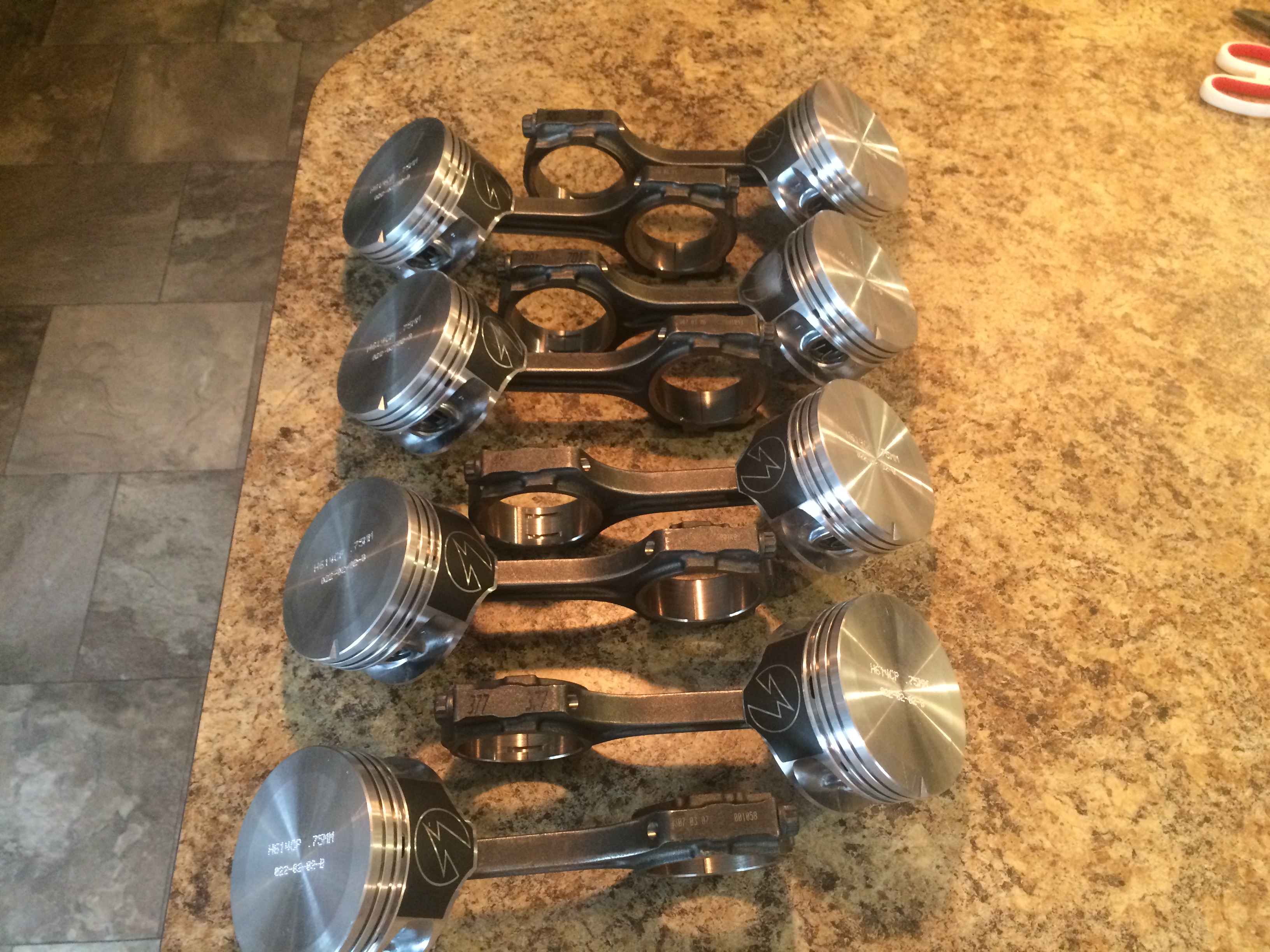

Assembly!

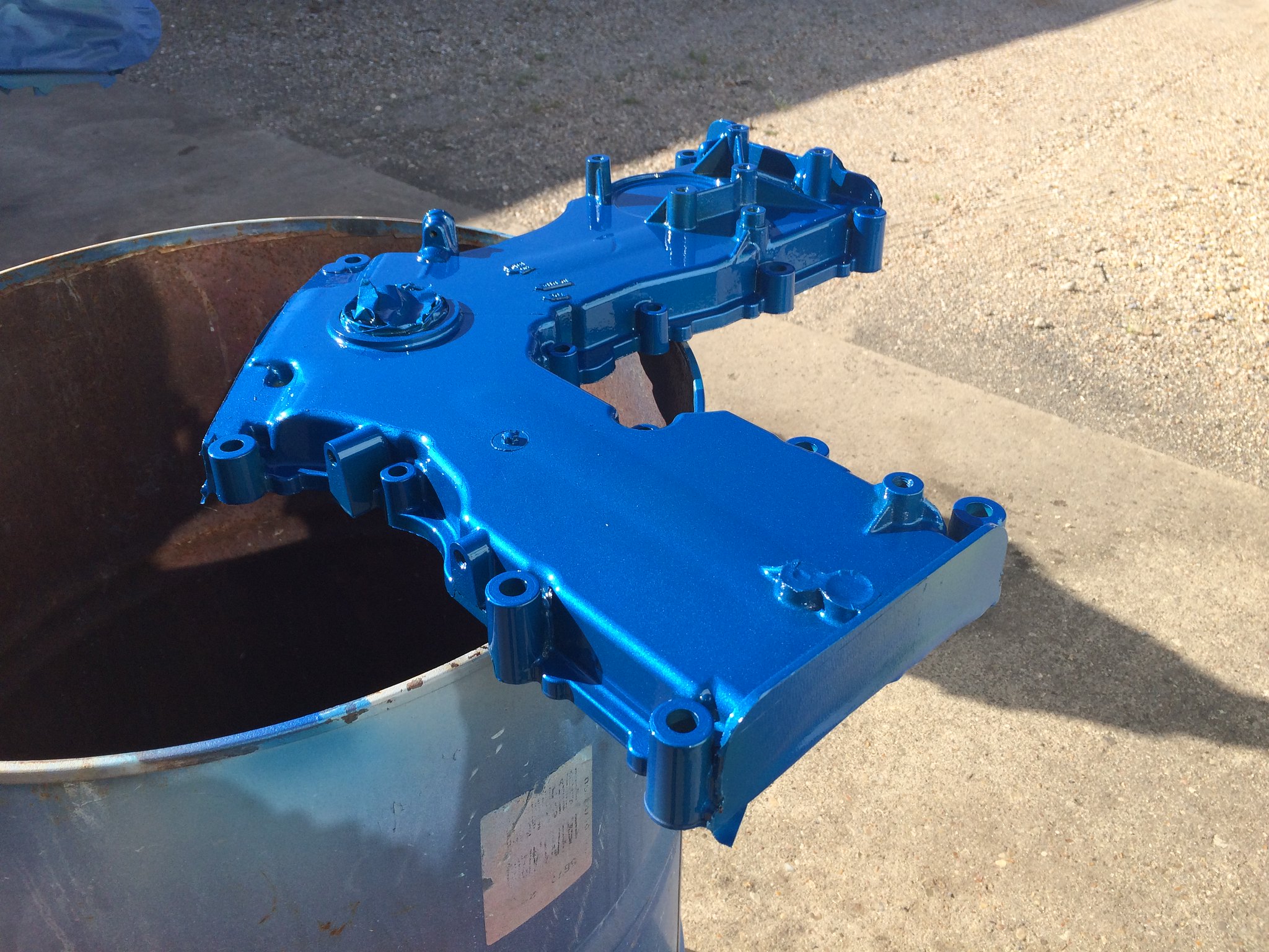

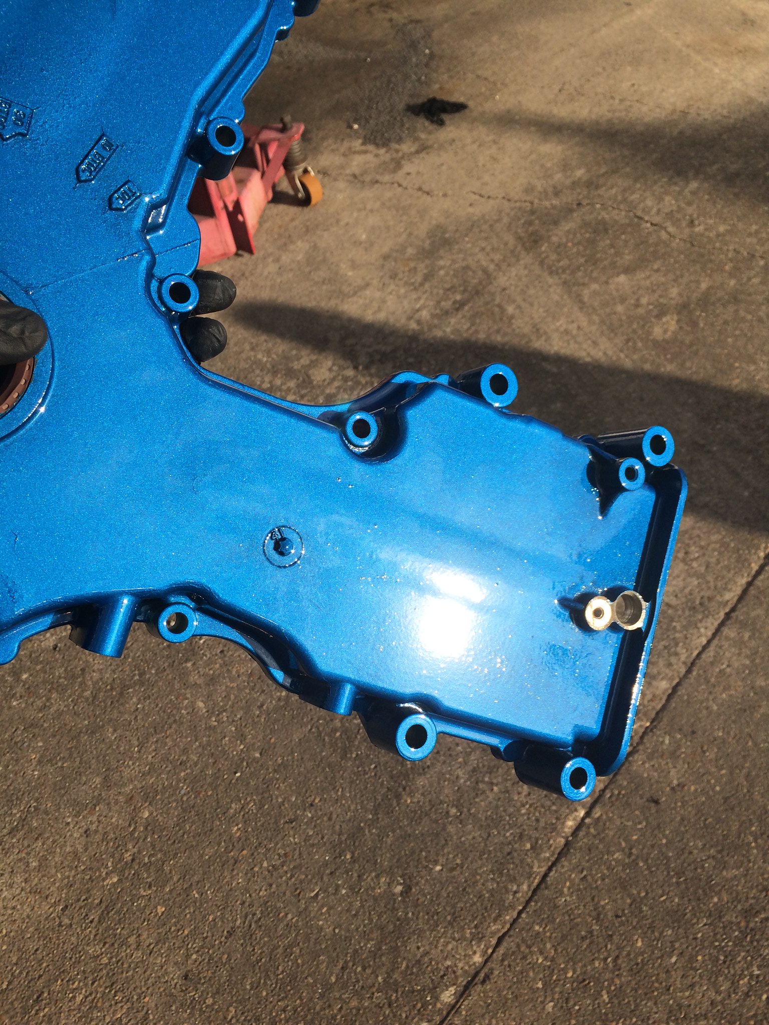

Got the engine assembled and rolled it out for some look good paint! Bright atlantic blue, basecoat/clearcoat.

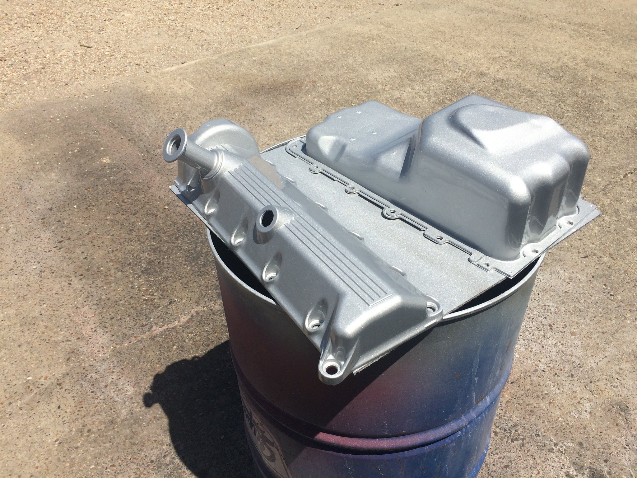

Then we did ingot silver metallic for the cam covers and the oil pan. Again basecoat/clearcoat
