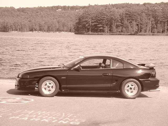

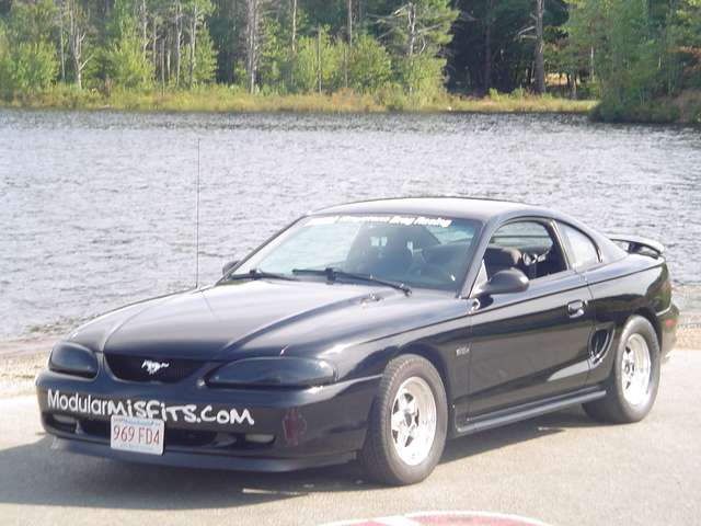

This is my car on 4cyl springs

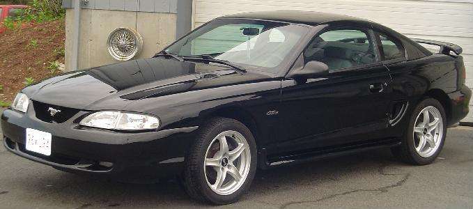

and this is stock with 98 cobra wheels when i first got it...
duff daddy
Jun 29, 2008
8,213
22
sleepn_sn95 said:
^Are the springs cut at all in those pics? All 4 corners?
Bottom pic is all stock.
Top pics are front stock 4cyl fox and rear stock sn95 cut 1 coil.
