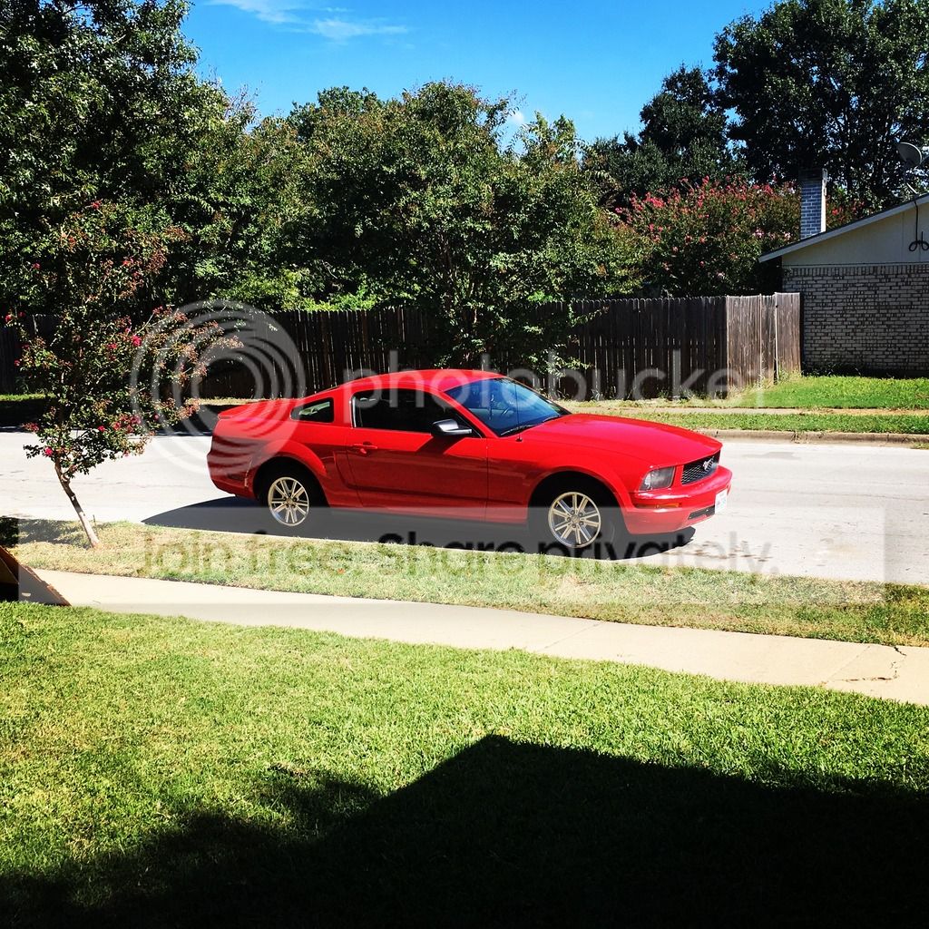

As y'all know she picked up an S197 recently too.
Here's what we discovered with her car recently..

Took her door molding and stripes off

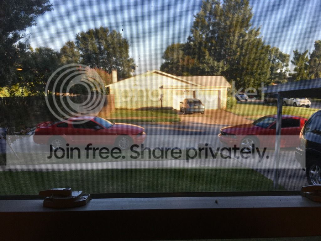

His and hers
