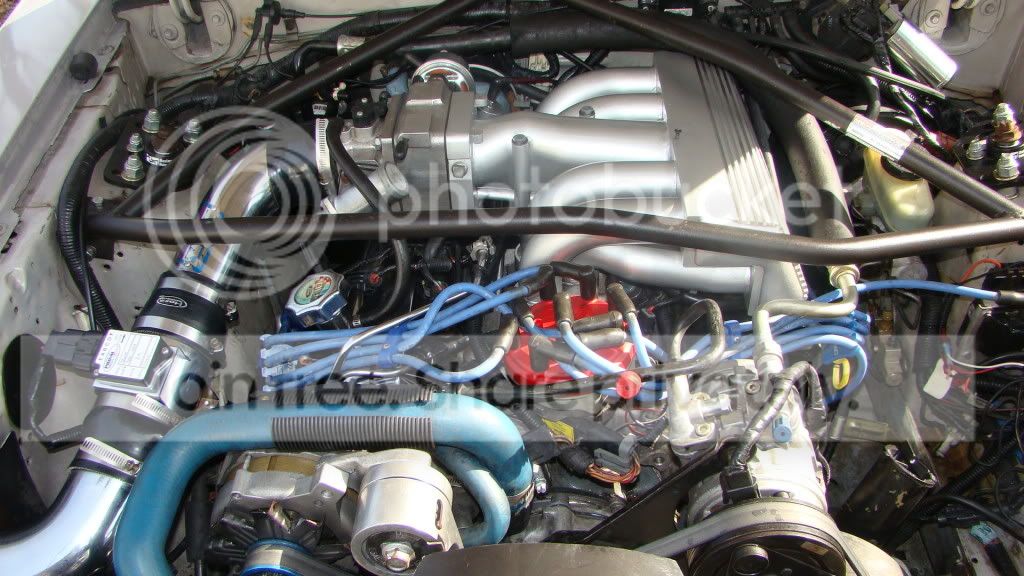

Win
Nov 20, 2006
9,508
17
Kennesaw, Ga
Venom351R said:
95_5.0@15 said:
Well I wasnt gonna put the Cam in right away, I've got a gt40 intake waiting also. Im gonna get some gt40 heads before I even think about doin it.
Which GT40 Intake? The poor mans Explorer lol or the ubber cool tublar?
i think he just has the Normal GT40 Explorer intake. Although this is is going into my car within the next few weeks :)
