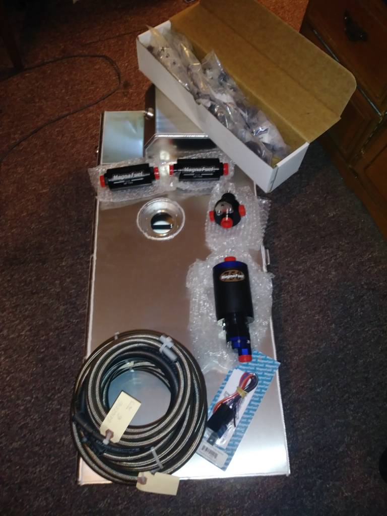

Got a few things in today. Mainly a complete fuel system from Behind Bars Racecars. Should have plenty of fuel for the switch to E85 with this setup along with 95lb hr DeatschWerks injectors

I’m not familiar with them. How’s their kits and prices compare to glens?

I thought long and hard about the18 gallon intank setup

Im wondering if they could install different sized feed and return line fittings. Looks like they are using -10 I would need a -8 feed and -6 return. Regardless the price is sure right

Its goes from 10 out of the tank to prefilter, pump, filter, then all the way to the engime to a y block that splits to 8 and feeds the rails in the front. From rails to regulator to rteurn is all 8. And yes you can get whatever fittings you want. Just give him a call or an email.
