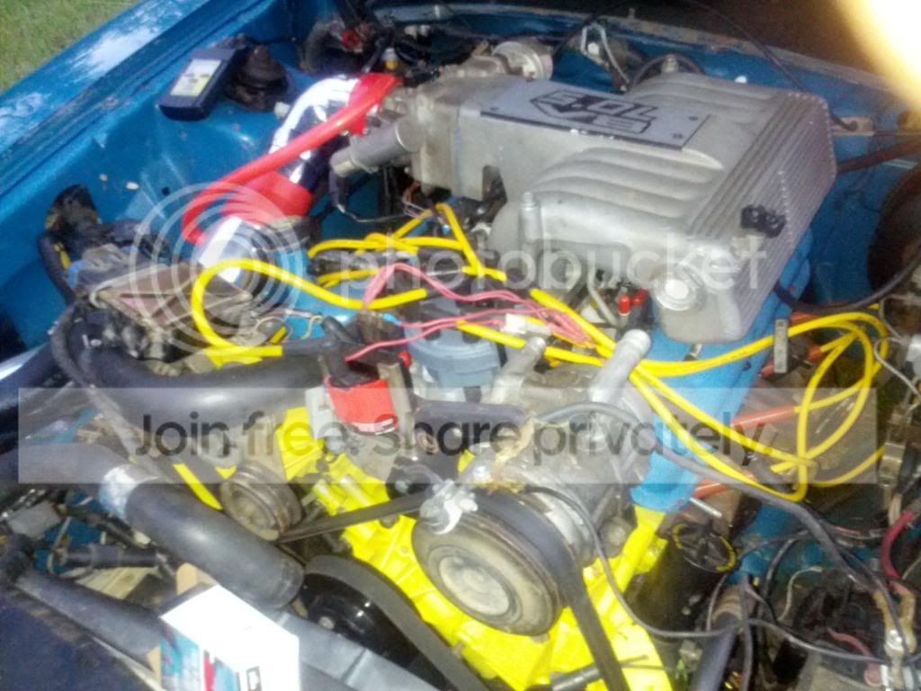

Hey All, just thought I'd post up pics of my project.
Bought v6 coupe for my daughter, for about $400. Replaced battery, starter and ignition switch. Got it running. Changed oil and it spun an bearing. Fixed door and fender and bumper. Drove to house and here it sits.
I did rebuild v6 myself, and did the windstar intake and drove it for awhile. Blah, blah, blah.....

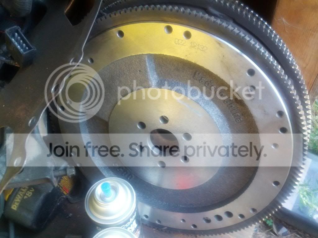

I rebuilt 302 shortblock from 1999 explorer. E7 heads. Explorer cam. Explorer intake..... You get the idea. My recent purchase was t5 out of 1997 mustang v6 for $50. The flywheel is 11" 164 tooth from O'riellys for about $60, I told them it was for a 1989 ford truck.
Manual computer came in today. updates to come. enjoy,

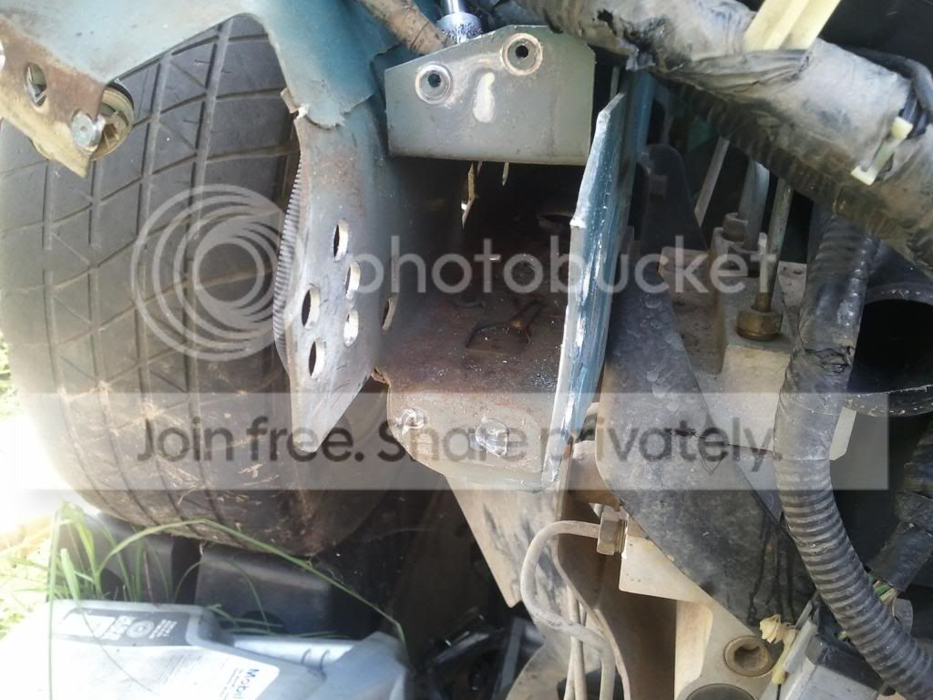

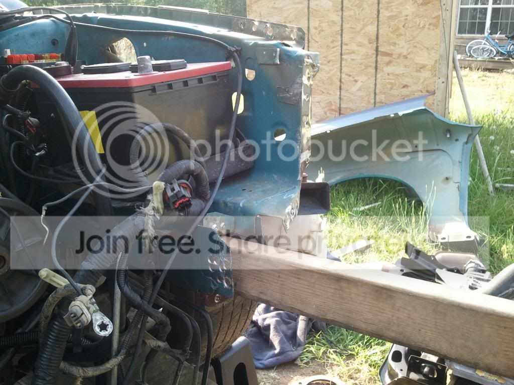

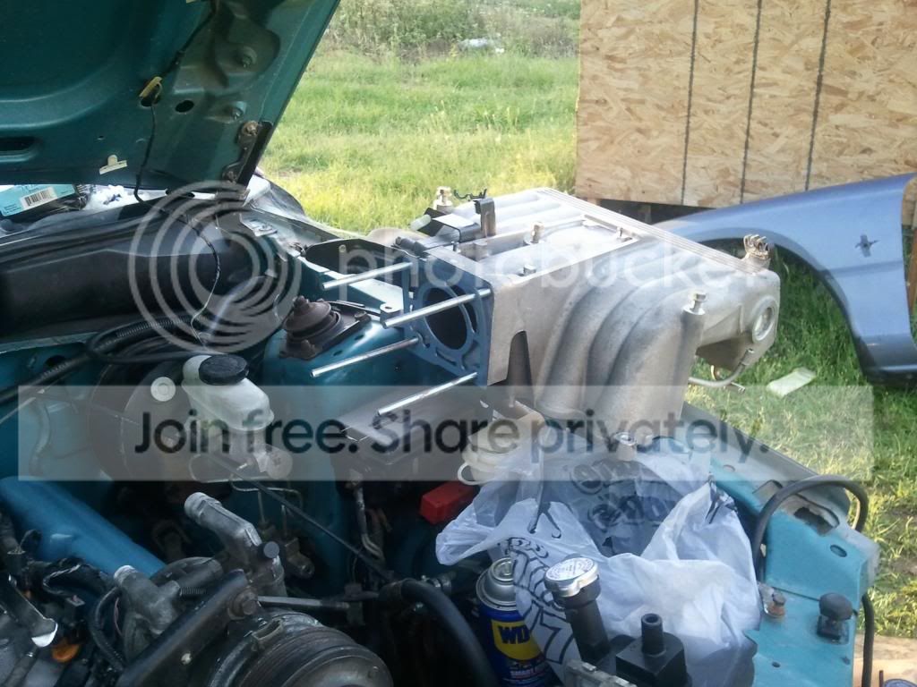

I'm back. Haven't had a chance to work on car because of the hurricane. I have some pics of some progress. I had to replace radiator core support. Removing spot welds was something serious.

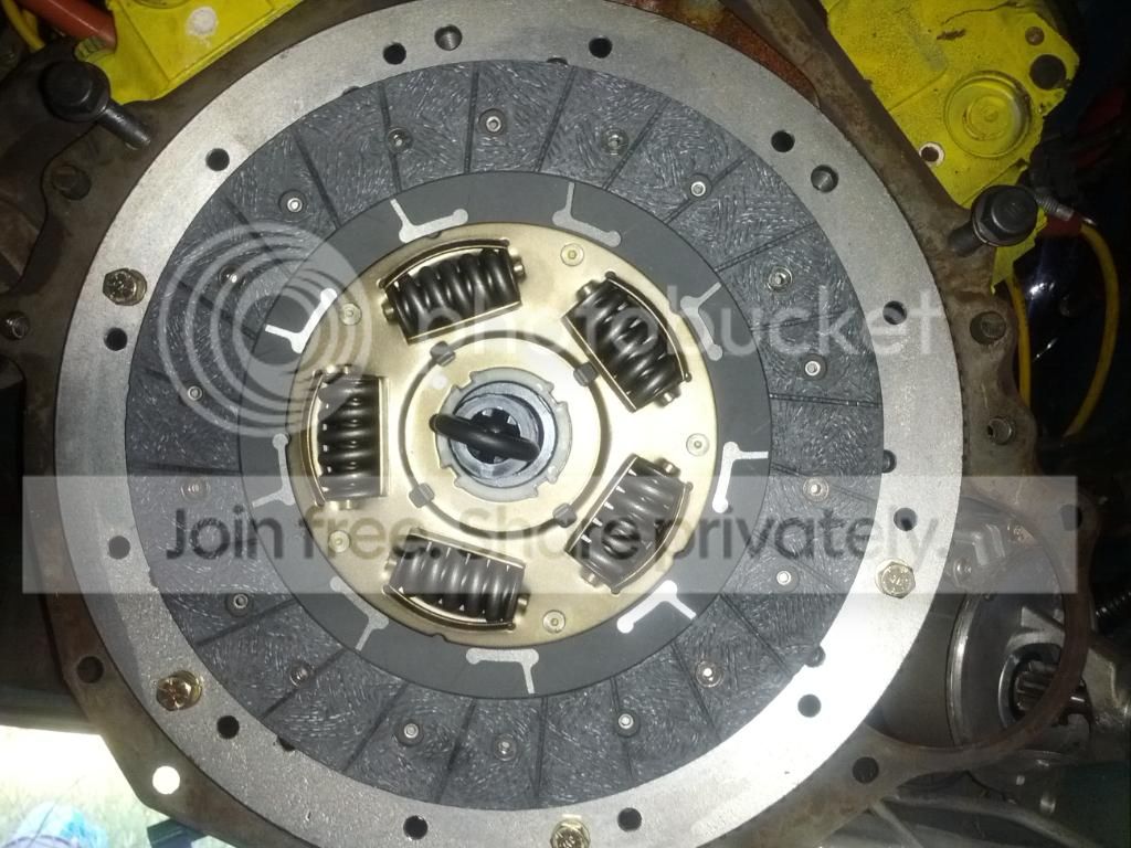

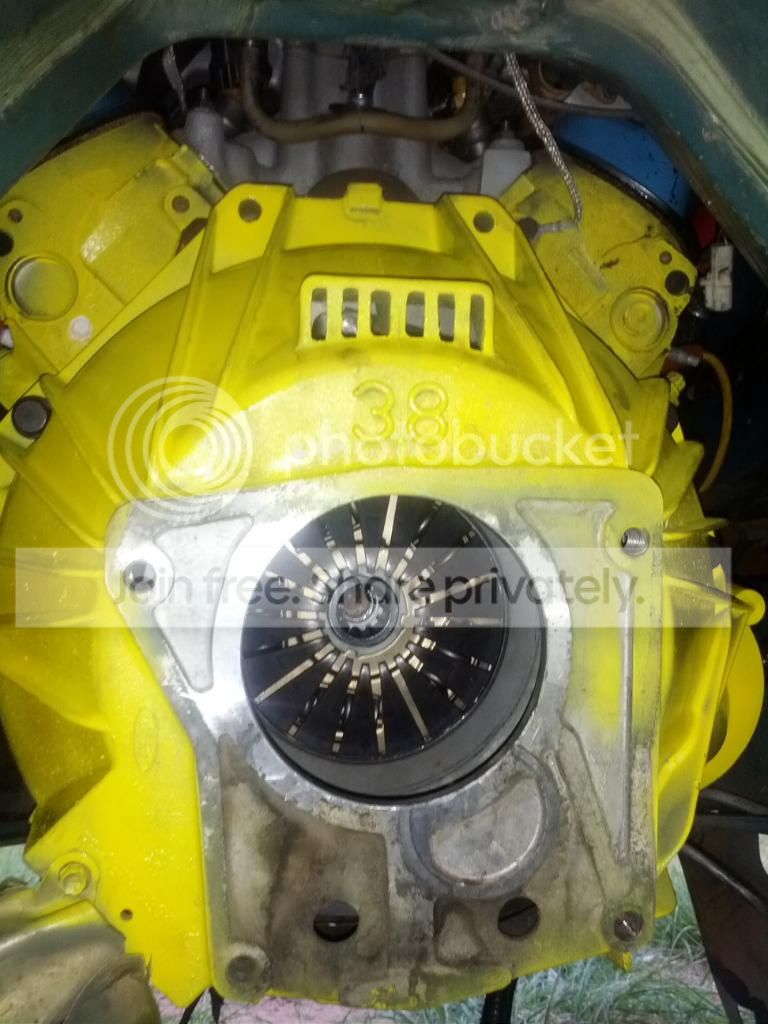

Picture is the 89 truck pressure plate and the 3.8 mustang pressure plate. 3.8 is yellow. The clutch kit cost $85.00 at O'riellys. I have to get you guys the part number. The pilot bearing fits nicely to the 3.8 mustang input shaft.

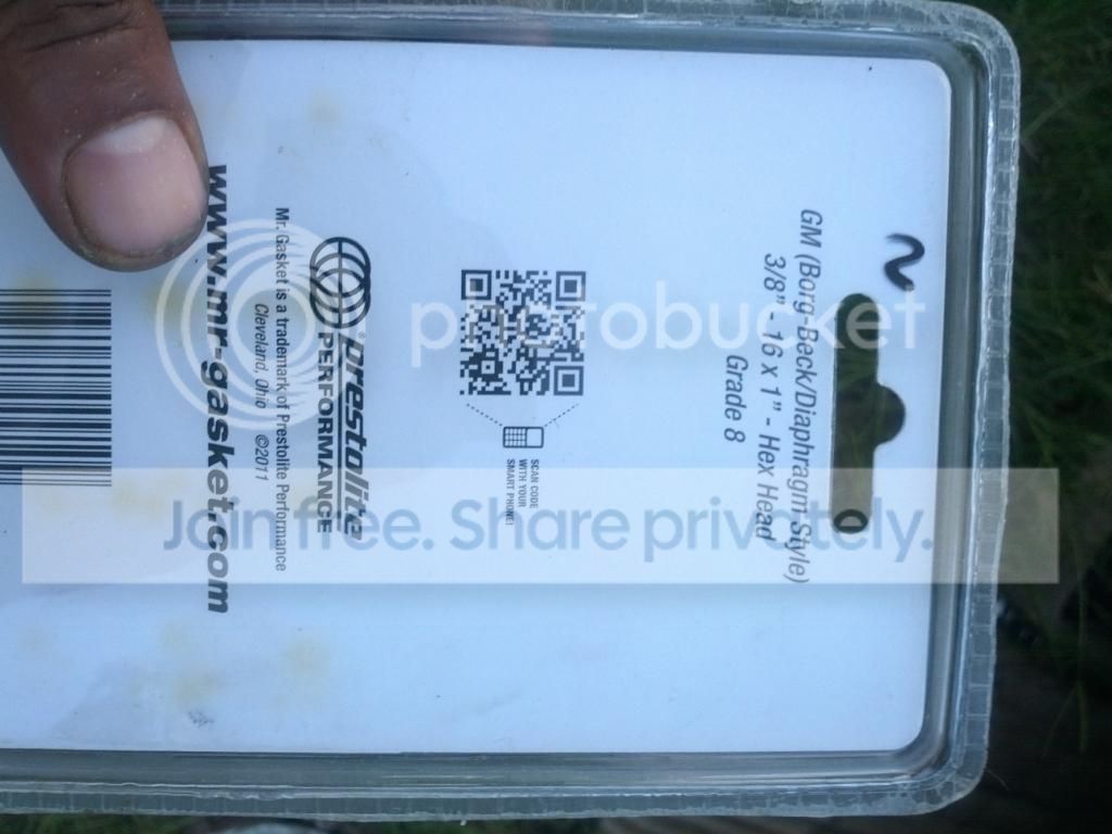

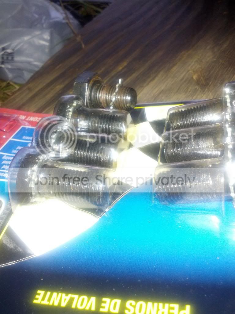

I bought 5/16 bolts and they didn't fit. I went to Orielly's and found these. They are for chevy flexplate??? But they worked.

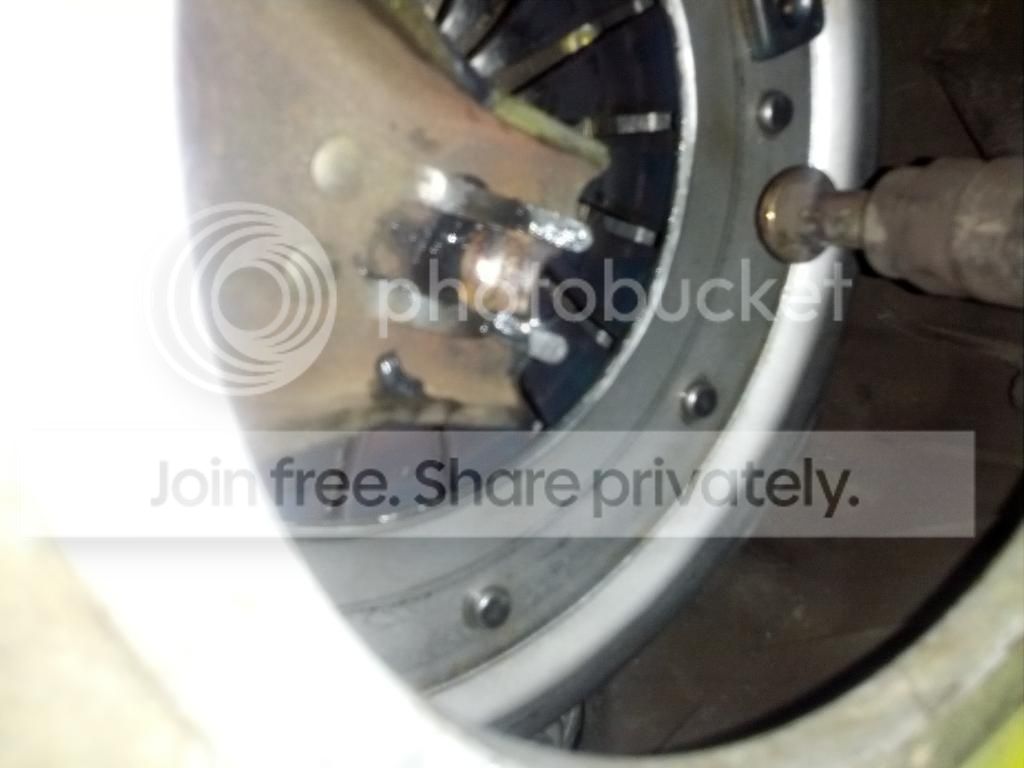

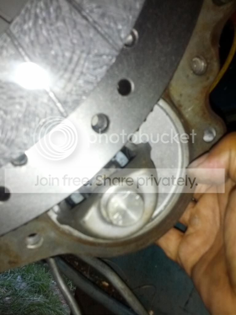

This is where I stopped today, getting kind of dark and the mosquito's around here are the worst. But I did run into problem. The pivot pin need to be moved in to clear the pressure plate. Maybe a 1/4".
The starter will not need any adjustment at all. I checked clearance. I used a 3.8 automatic block plate, if anyone was wondering.
I'm doing this swap simply because there is so much mis-information out on other forums. Some say it can be done, others say it can't. You don't have to buy those expensive flywheels, there are other alternatives. I'm thrifty "cheap" :D. Hope to finish tomorrow.

Did u have to remove the AC condenser to be able to take the rad support out ? Im doing mine tomorrow and im wondering if i can just zip tie it to the engine just so i dont loose my 134a .
