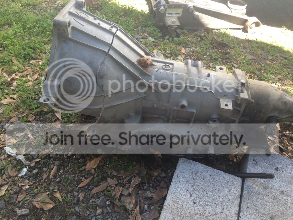

coming home

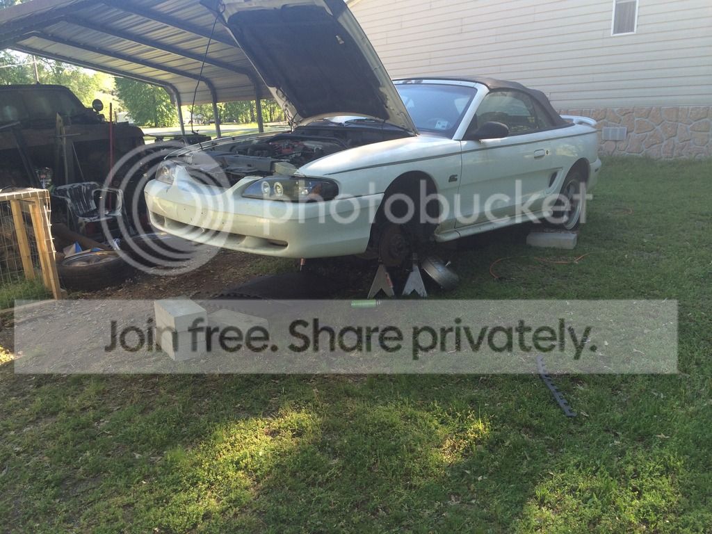

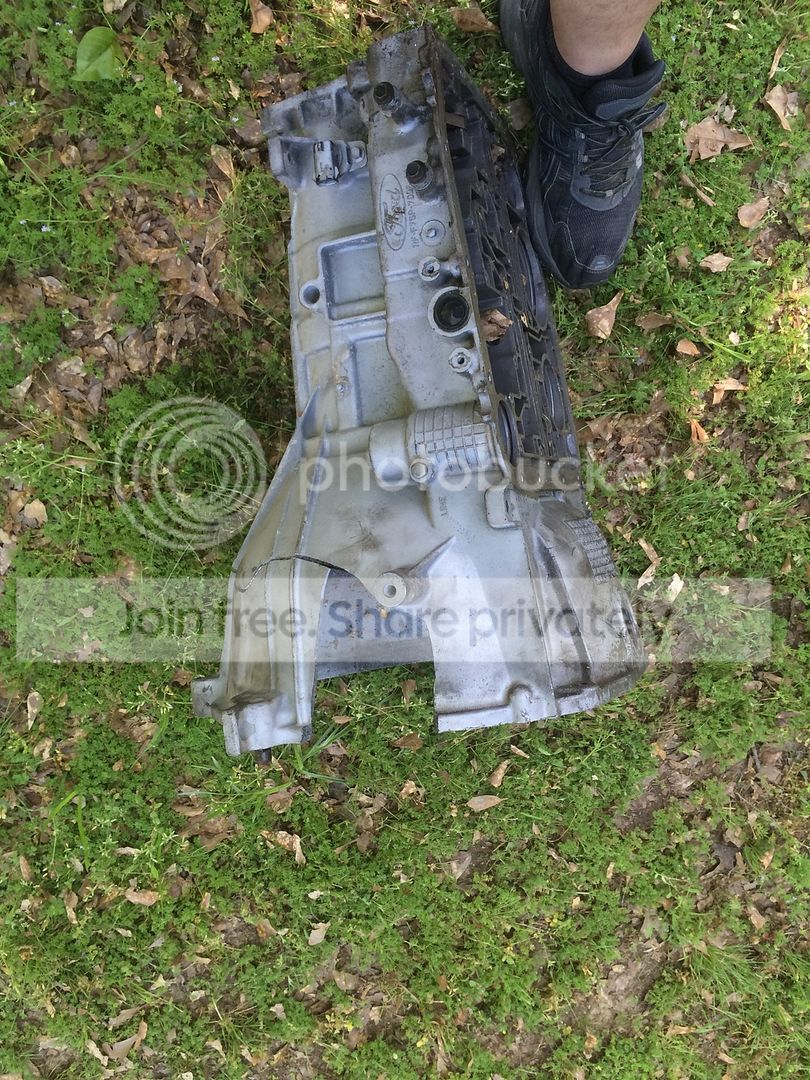

on stands right after I got the tranny out...looks like its on grass but the jack stands sit on concrete footers I made for just this purpose, just difficult to see.
when I first got the tranny out
after I tore it all down

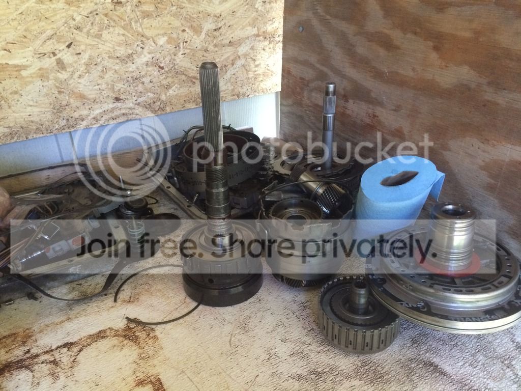

I did not, I haven't even taken the valve body apart yet. The second transmission that I mentioned I kept and I have that torn down and the plan is to just swap the internals over into the good case. Everything from the cracked tranny looks great, the second tranny on the other hand had a leaking od pin bore and I think at some point when it was installed I either didn't align the converter right or something like that because the pump gears and bushings were messed up.

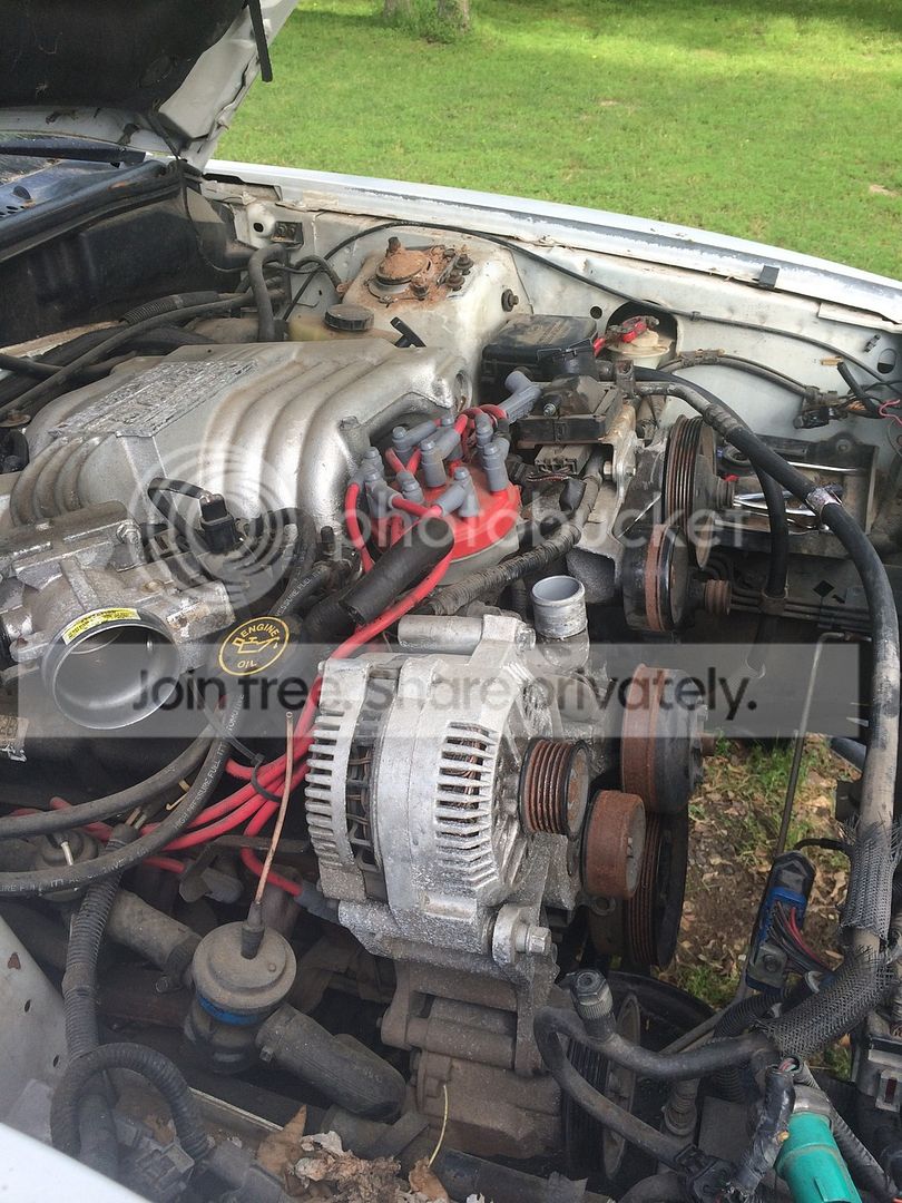

Just a little update, before the vehicle was put on hold an oil leak had developed from the oil pan area so while the transmission is out I will be doing an oil pan gasket and rear main seal. I will also be looking for a set of headers in the near future. I haven't decided if I should just pull the motor and do all these items or leave the motor in. I will have to do motor mounts on it from the looks of the mounts.

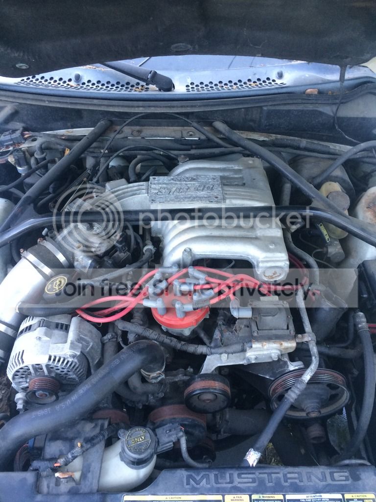

and heres a few more pictures of the front and engine bay.

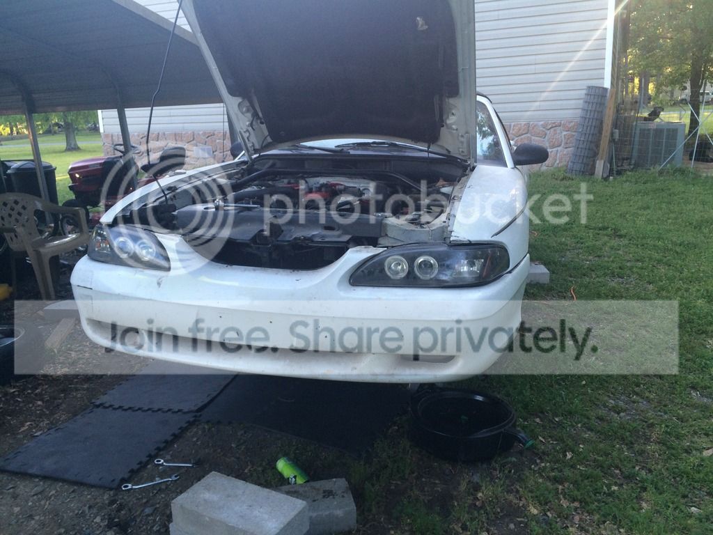

Not much of an update after this weekend, had a crazy Friday and Saturday at work so took it easy on sunday. I have decided to pull the motor out, just too much I need to do to try and work around it. Found out I will need a new booster as mine is starting to rust through. Just need to pull the fuel lines and heater hoses and unbolt the motor mounts and ground strap to get it off. Heres a pic after I pulled the fan and radiator.

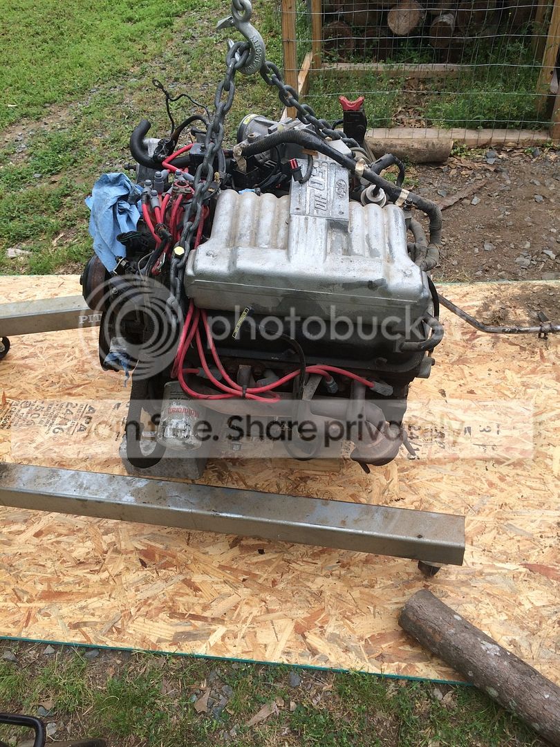

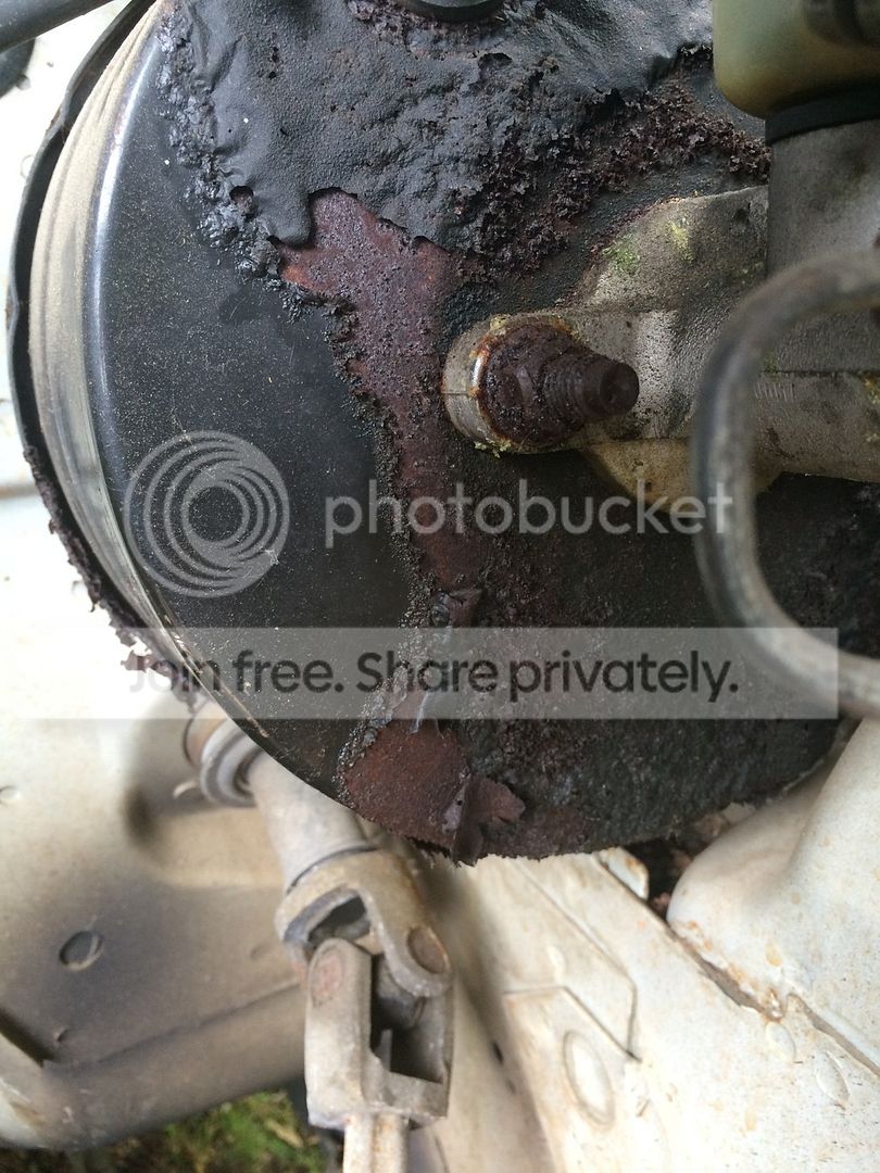

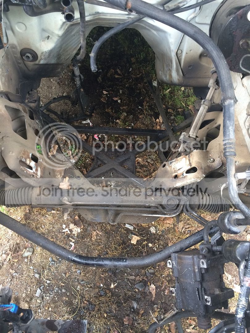

Another update coming...finally got the motor out. Will be replacing motor mounts, brake booster, and securing a set of headers while it is out and of course doing the oil pan gasket and rear main seal. I also need to clean my rack and k member up before reinstalling the engine as I had a nasty power steering leak and its all greasy and grimey under there. haha. Heres a few pics of motor out and my booster for viewing pleasure.

Just for chits and giggles, heres a pic of my trying to get the booster out. lolz :D (excuse the gut, its also a project)
