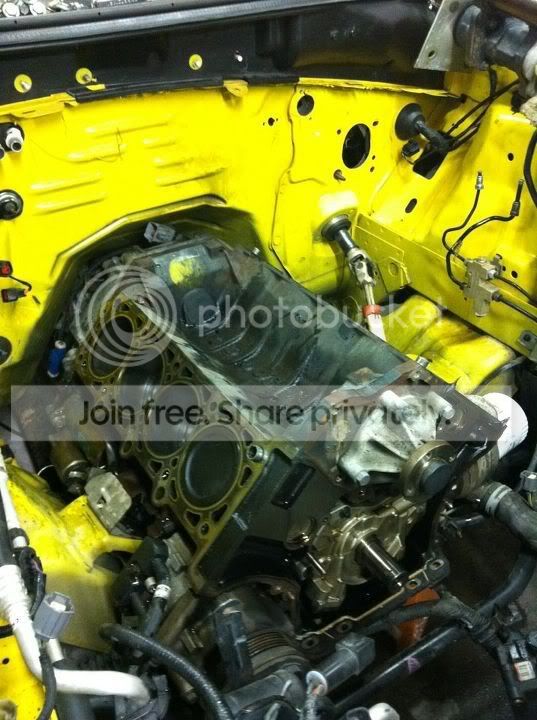

Alright, got a few pics uploaded that my father took and sent to me of the tear down and what he found inside.

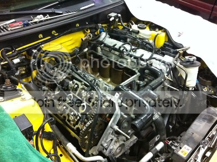

Valve Covers and Supercharger off
Heads and front timing cover off

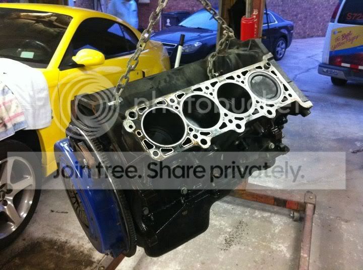

Short block out, you can see the SPEC clutch that the prev. owner had installed here

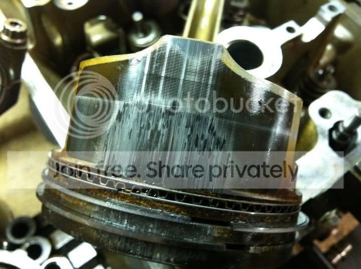

And here is the damage, father said the piston was able to slightly rock back and forth inside the bore...

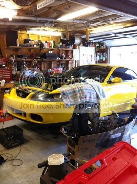

This is how she will sit till I get home
