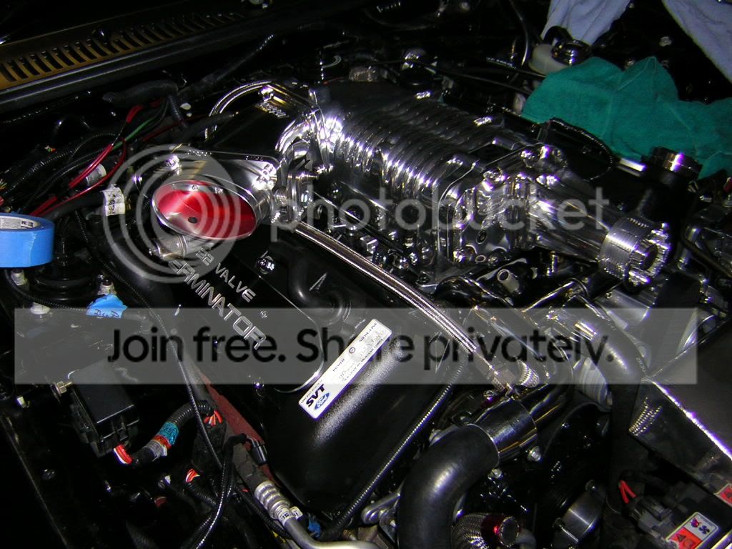

Also picked up some AN fittings for my custom head cooling mod, just awaiting an email from MMR about their AN fitting that go into the head to complete the kit. The real kicker is it will cost $15 more than the GEN II Evenflow kit and have full AN/SS lines! Should look similar to this when done:

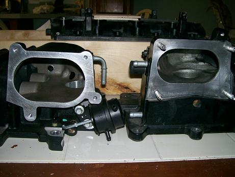

Going to ditch the M112 blower that came stock on this car in favor for a bigger/more efficient stock ford blower. I'm going to go with the M122 that comes on the Shelby GT500! there is a guy named James on another forum that makes adapter plates to bolt right onto my pre-existing intake and best of all you can get the blower used off of a shelby owner for around $350 which makes it an excellent alternative to porting and spinning your m112 to the moon like i was planning. Below is an example of the much better design of the inlet coming into the rotor pack:
James said he made 613 on race gas with a 4# lower pulley and 2.76 upper! that is whipple territory! lol I'm very excited about this if you guys cant tell.

Broski, this is going to change the inlet side to the drivers side now?

what throttle body are you going use to bolt onto the GT500 blower? that picture comparison shows that there is no way your getting a 03 style on there and the GT500s use drive-by-wire...
Going to use a dragon TB for an 03-04 cobra. It has the stock TPS and what not. However it will be the only restriction in the system. I might try to figure out a way to use the CobraJet TB later on, they make one with a cable driven setup as seen here:

i still don't understand how a cobra TB will bolt up when the the gt500 blower has a bolt all the way on the bottom instead of the 4 corners. it also looks like the top two bolts are offset. and sorry if they address this in the thread you posted but i'm not going to read through 98 pages to find it...

I understand, its in the kit he sells, TB adapter plate, along with supercharger adapter plate, and a throttle cable bracket
