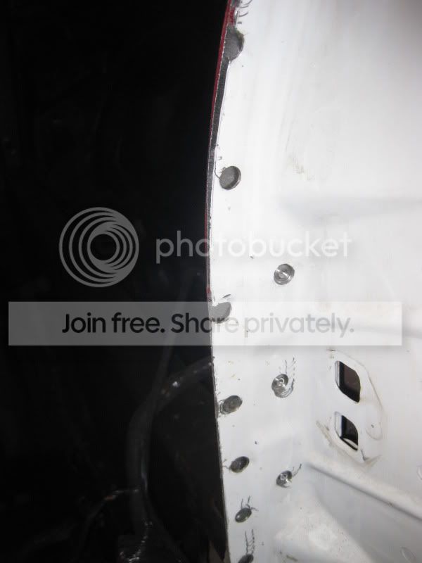

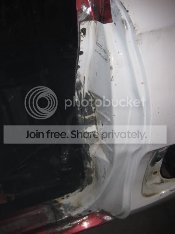

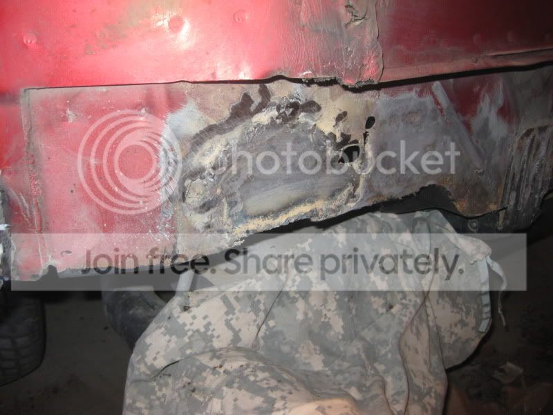

Did some more work on the car this evening. I Finally got my buddies grinder from him, so I went to work grinding down the gouppy ass welds..
After these photos were taken, I ended up touching up parts of the welds (with welding), then ground down those small areas....

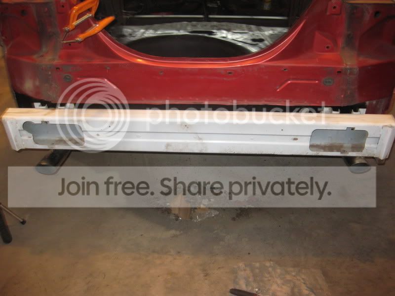

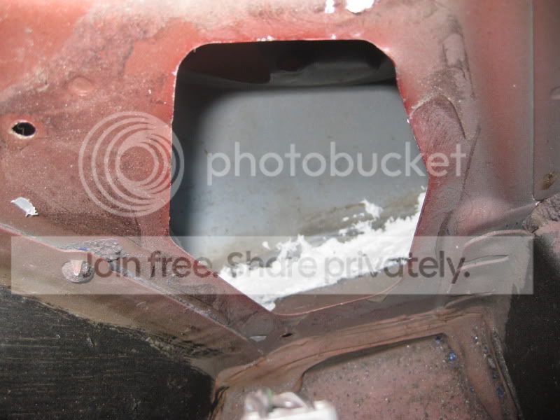

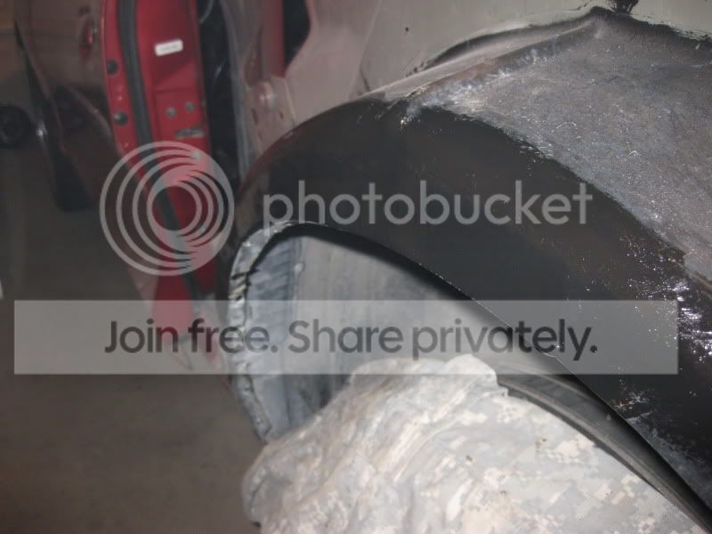

Prepped the middle and pass side of the rear bumper area:

As soon as it is all dry, then I will bolt the replacement metal bumper, and test fit the quarter panel some more.. I am at the point now where I think I cannot disassemble anymore, so it should be back together from this point. After those two things, then I'll have the windshield pulled, order my hood, and it's off to paint..

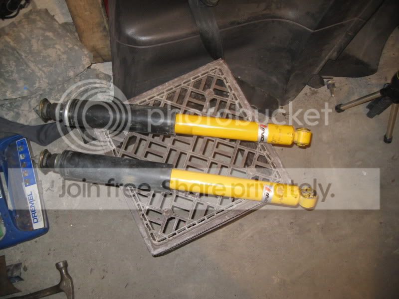

Starting off I got the matching pair of koni single adjustable rear shocks (thanks to Javi) to go with the single adjustable struts I bought a year ago.

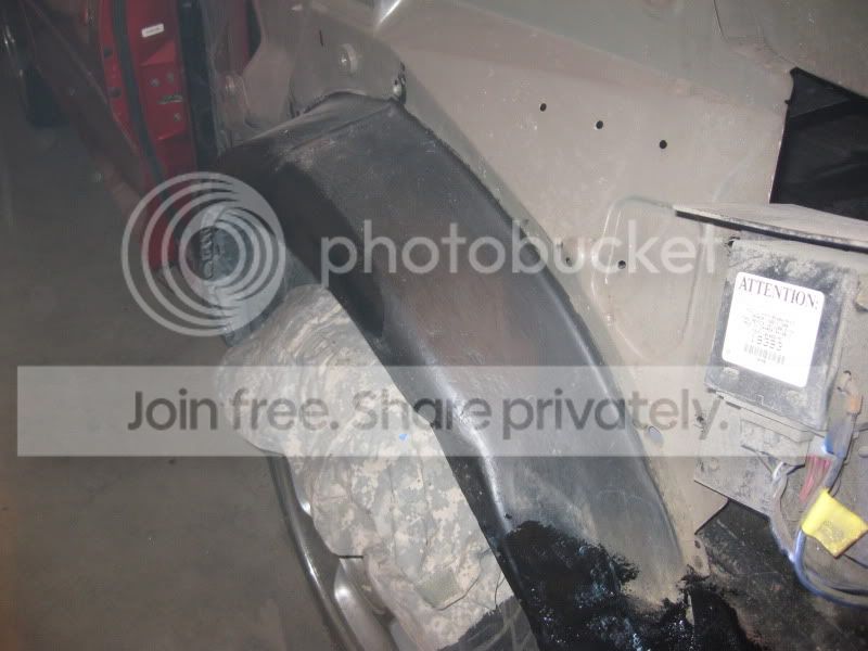

I didn't get any pics with the POR-15 dried, due to the camera battery charging, but I did bolt the replacement rear bumper on:

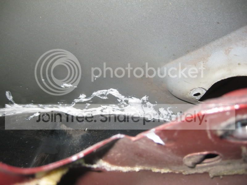

I noticed a small "crease" in the replacement quarter panel, so I did the best I could with a buddies hammer and dolly set. (picture shown is "before", I forgot an "after")

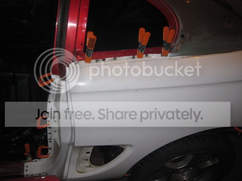

Then it was on to the final test fitting of the quarter panel.. I intentionally cut the replacement one so that I would have a good reference point such as the B-piller (also called sail panel) mounting... hole.
Door pillar alignment looks good:

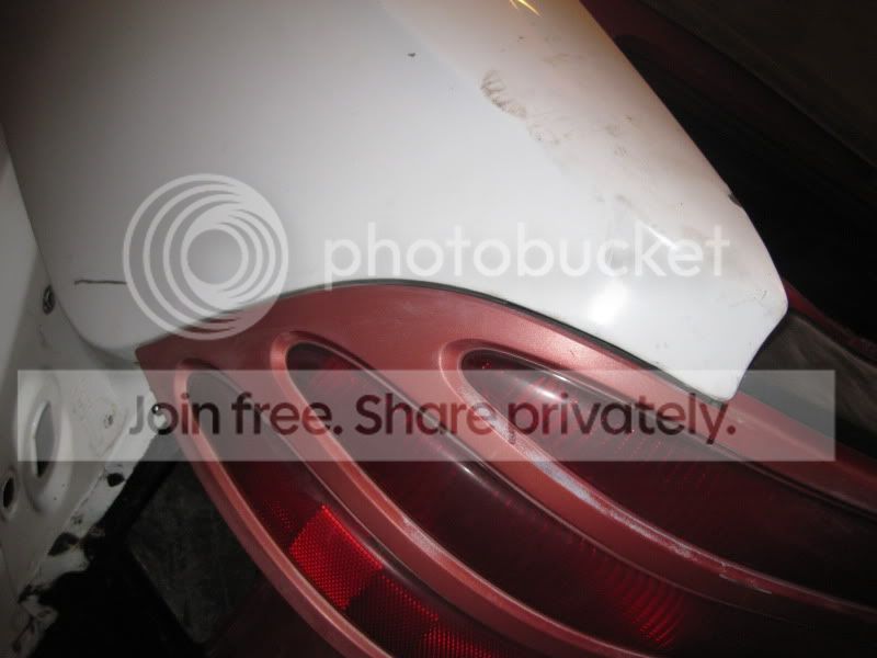

Tailight alignment looks good also:

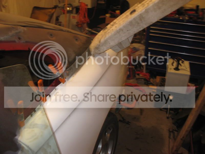

Clamped everything down to check measurements and fitments.

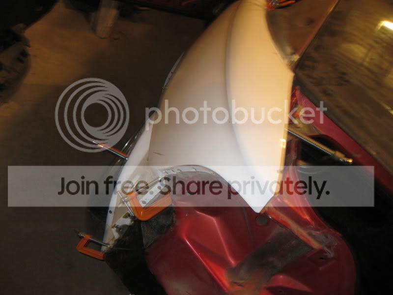

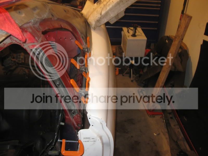

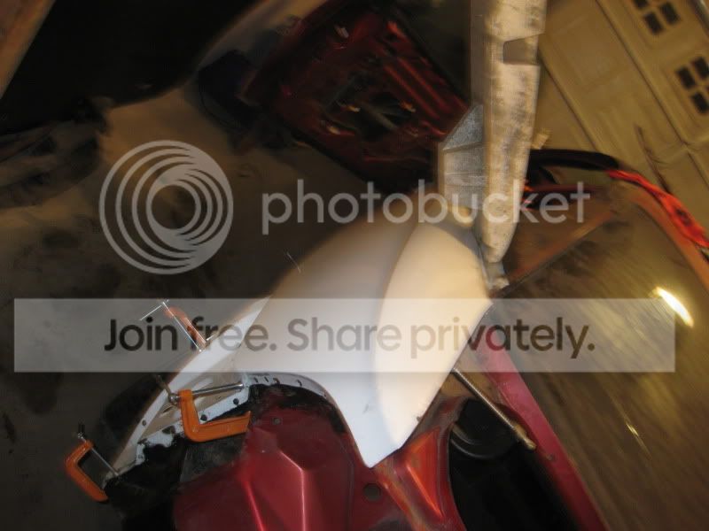

Double checked it with the trunk on, it looked pretty good too.
Then it was the big moment, time to stick these two large pieces of metal together. My homeade applicator gun worked until about halfway, when a combination of the cartridge and the threaded rod broke, so I pulled an audible and used a paintbrush for the rest...
panel adhesive applied, clamped down:
The very top portion wasn't sitting as close to the car as I'd liked, so the rear bumper foam got to double as a leverage support.

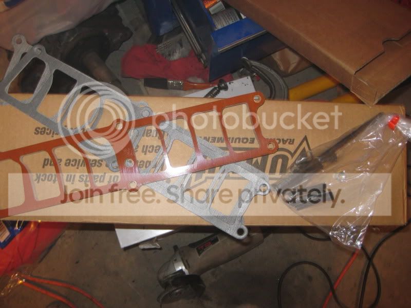

First off when I bought my Holley Systemax intake (used) it didn't have any hardware or gaskets with it. So instead of paying $30 for gaskets alone and trying to piece together hardware, I just bought a 3/8" spacer kit for it, which includes gaskets hardware and of course the spacer:

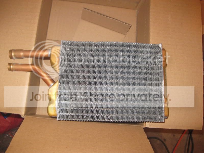

I also figured that since this cars body has 150k on it, that while I have the dash out now, i should change the 17 year old heater core sitting in there. I still have to take the heater control box out of the car, but that will be a job for another night:

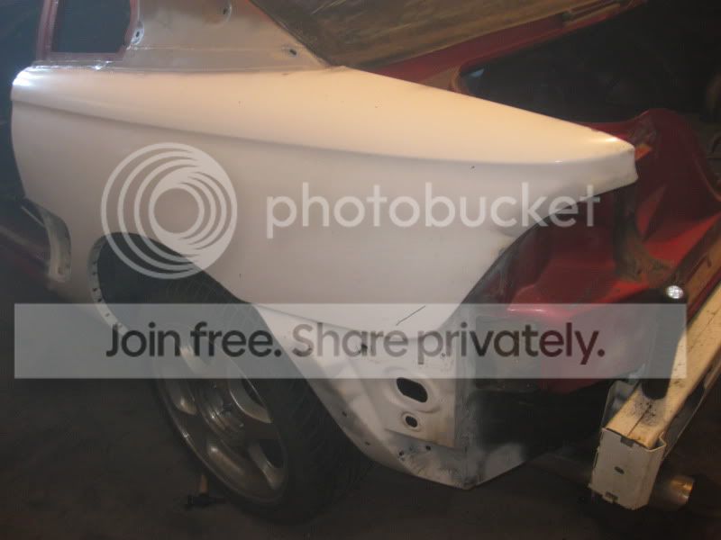

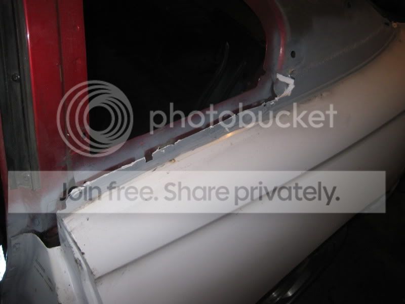

Moving on to progress. I let the adhesive cure a good 48 hours because it is around 30 degrees at night here, so I figured just to be on the safe side. A couple pictures as it sat after I pulled all the clamps off:
2slo95fiveoh
Dec 31, 2006
2,559
Lawrence, Kansas

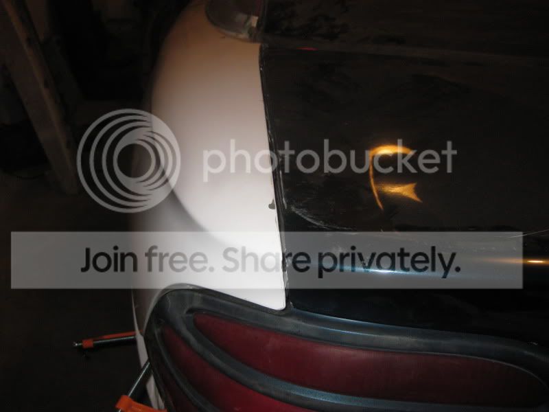

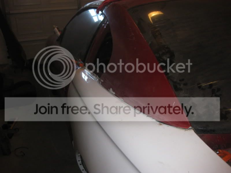

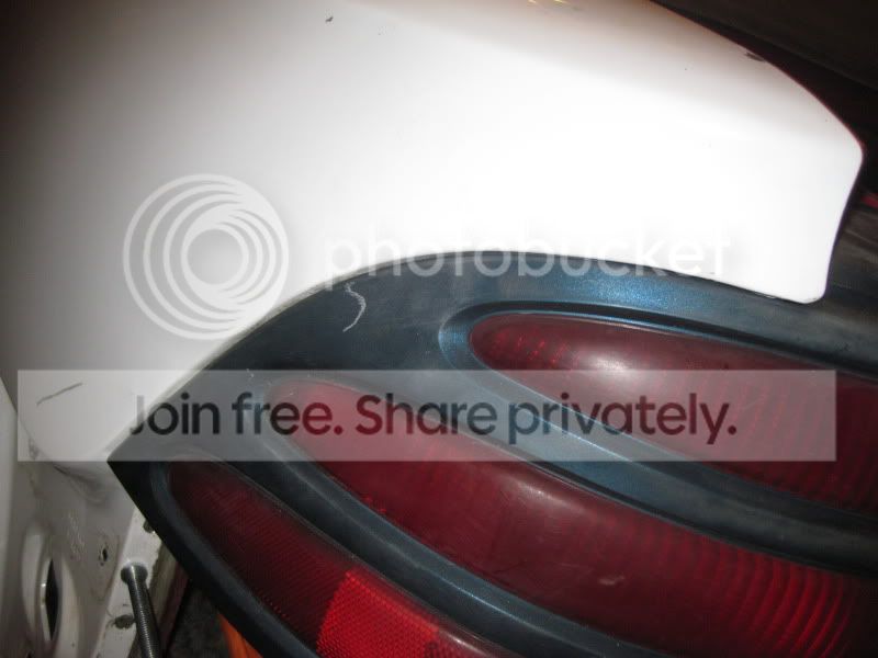

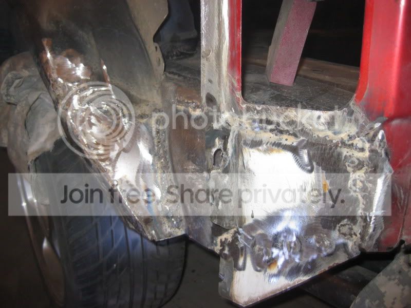

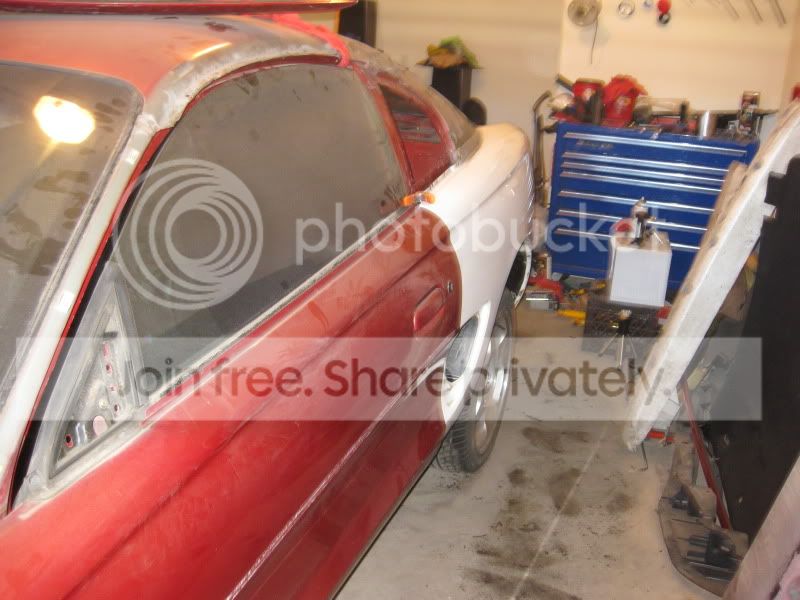

I was pretty pleased with how it turned out. Then I test fitted the tailight and B-pillar:

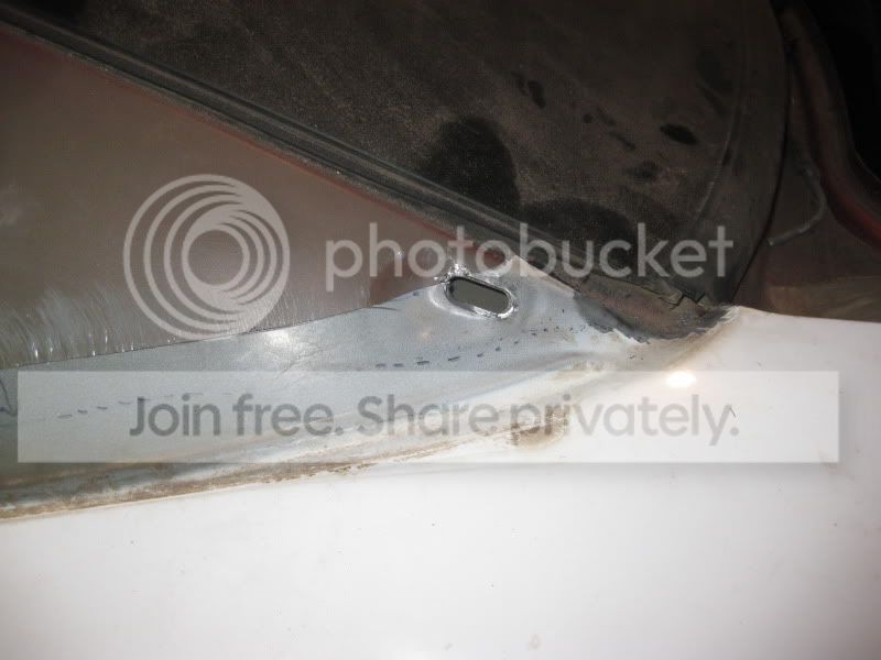

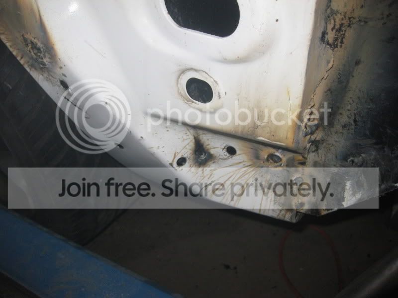

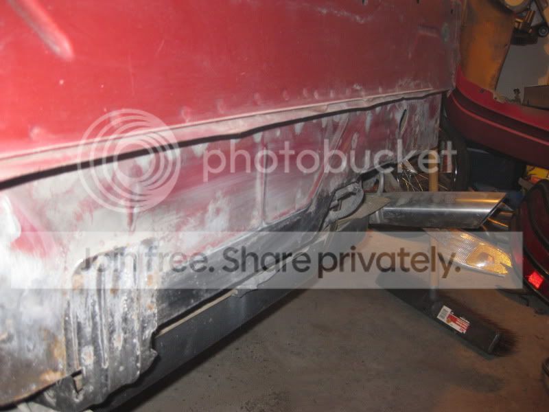

The gaps look pretty good, but there were some points on the quarter panel where either the adhesive must not have mixed right, or cuts where 3m recommends those portions be welded (such as the panel between the quarter glass and rear window, and the trunk)..
This lower portion of the quarter was not attaching well. I think mostly to blame is the fact that I didn't have any metal there, so my recreation might not have lined up as good as, oh say a car with metal there... So I went about welding it in the spot weld locations:
Some of the door seal area was also not as solid as I had wished:

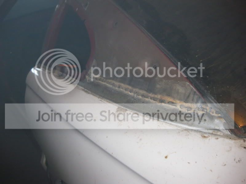

Then onto the sail panel area:
Ground the welds down:
And a quick shot of primer for the exposed welds:
I already body some body sealer, so next chance I get I will apply that to all of the seams in the quarter panel, as well as the trunk hinge.. Also I need to get the heater control box out of the car and swap the heater core out. Definately getting closer to paint!

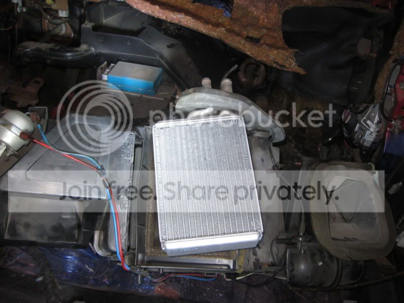

A little more progress tonight.. I removed the 4 bolts holding the heater box in, and removed the heater box..
Another 4 bolts later and the heater core was visable.
I'm starting to think the heater core was replaced.. It looks to be in really good shape, and although sitting under the dash wouldn't get too much dirt, this looks very very clean.. hmm... I'm contemplating leaving it in.. maybe I will take a look at the inside and see how it looks.. or flush it out and see what the contents look like.. I'm not sure.

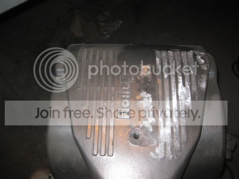

Next I started on my intake.. Here's where it started:
2slo95fiveoh
Dec 31, 2006
2,559
Lawrence, Kansas

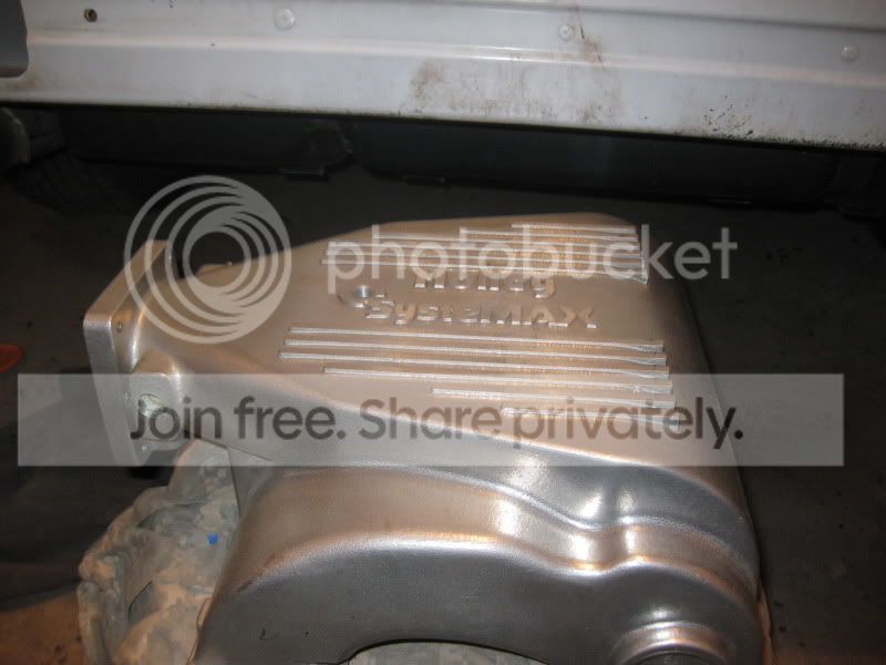

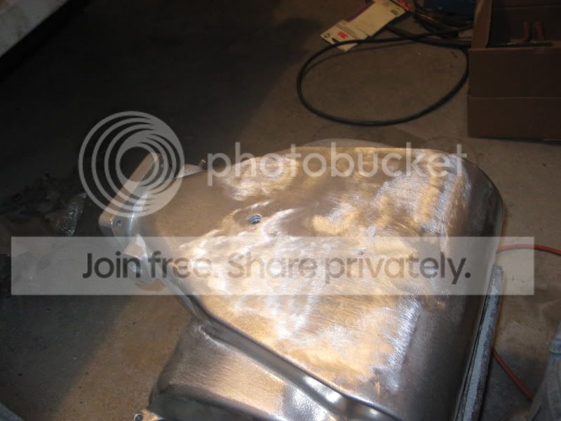

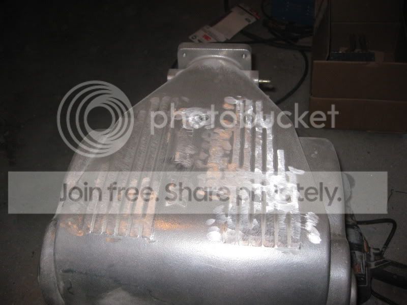

Started removing the fins/lettering.
About halfway done with the fins:
The rest of them. (rough)
Then I sanded some more to start the uniform look:
And that's where I left today. My back was starting to bother me so I called it a night. I will probably work on more sanding the intake here within the next couple of days, also I need to get a different caulking gun to apply the seam sealer for the quarter panel..

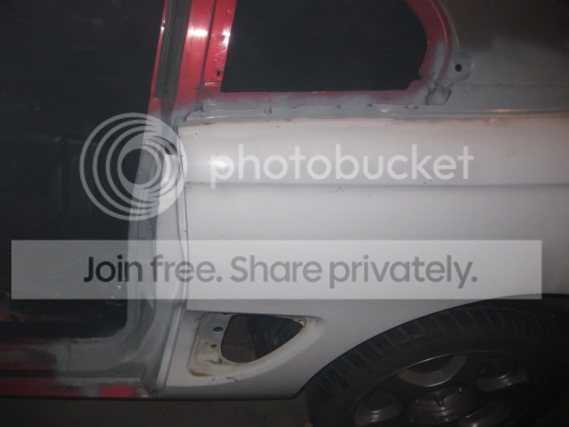

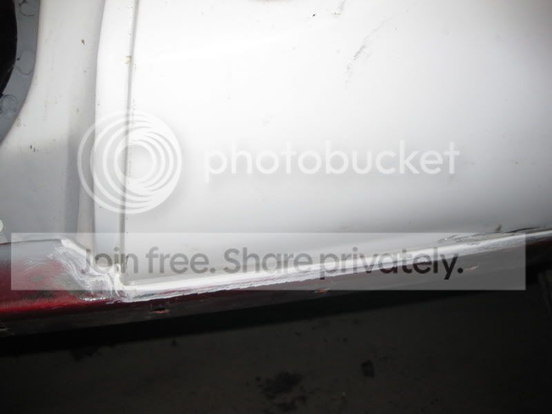

Did a little more work today. Now that the quarter panel is on, I needed to seal up the seams like it is from the factory. The panel bonding adhesive I used also works as a sealant, but I figured adding some seam sealer couldn't hurt..

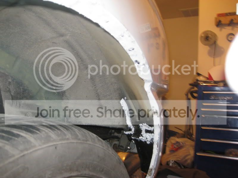

The lower quarter panel: (picture is right below the side scoop)
Before:
After:
Fender lip sealed up:
Quarter window seal area:

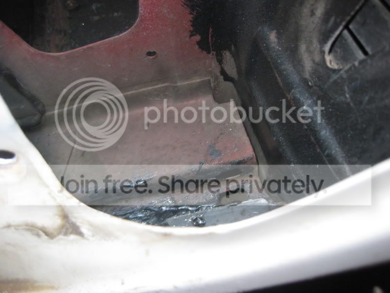

Rear fender/quarter area sealed. A good view of the new sheetmetal I had to add:
Lower quarter:

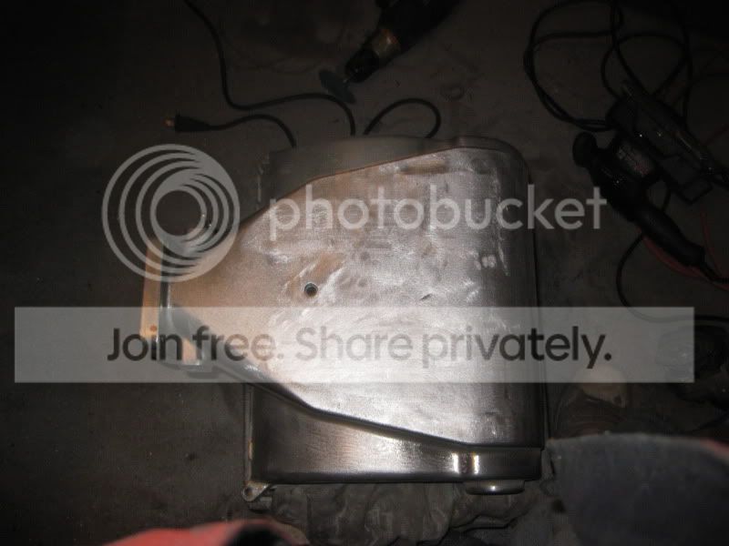

And I did a little more work on the intake manifold. I have about 70% of the casting flash gone, I am not in a huge hurry to get the intake done. I'll work on it and some of the other engine components more when the car is at paint.

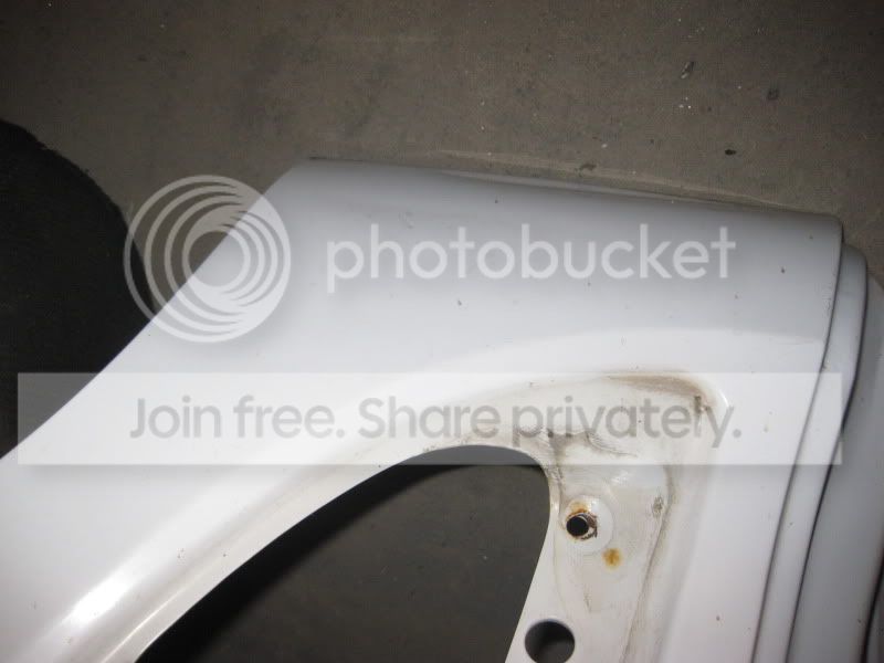

Real nice work man... you mind doing a favor for me though? I need picture of the inside of the actual sail panel. I think the front lower screw on my sail panel is stripped or disconnected. A picture would help me out if you have one. No biggie though.
Slykin
Jul 11, 2009
3,538
118
Tyler, Texas
I need to see exactly how the sail panel(removable part behind the quarter window) attaches. In the 3rd to bottom picture on this page, the main hole(right side) is what I think is stripped on my car. It flaps a bit going down the road.
