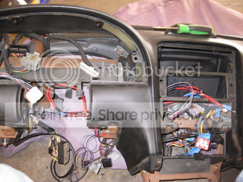

the wiring for the gauges is about 90% done. I just have a few things to button up and it should be ready to go. As it sits (doesn't look like much):

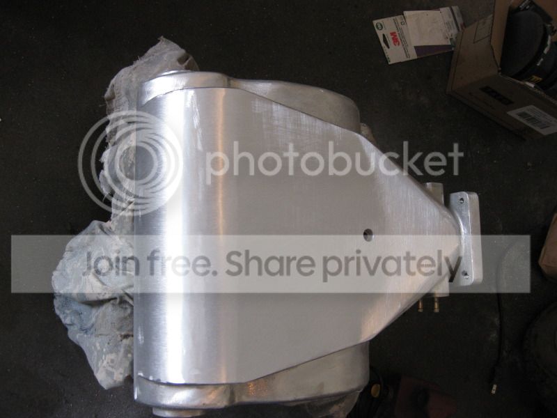

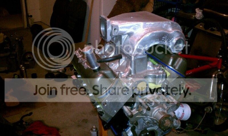

I put a little more time/effort into polishing the intake manifold. This is only 320 grit in the center section, but it is just about free of any major sanding lines, so soon I will begin the quicker process of moving up in sanding grits..

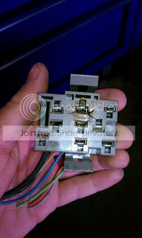

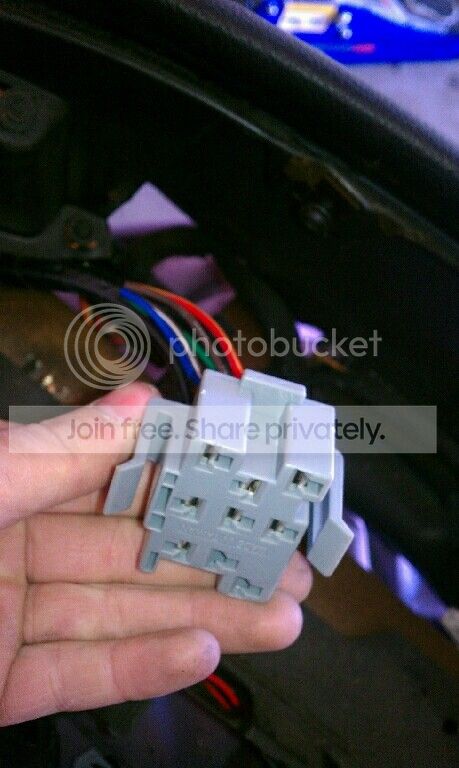

Also when I was working on the gauges wiring, I noticed the plug for the headlight knob looked like one of the wiring locations got pretty hot and melted and cracked the plastic around that wiring location.Also just about all of the wires are pretty loose in their respective locations, so now I am on the hunt for a pigtail for the headlight switch. Hopefully painless has it, if not I will have to settle for one out of a wrecked car..

I was pleasantly suprised when the local advanced auto parts had a headlight pigtail in stock. So I went to work soldering that in.
The old.. I hear it's a common problem but I have never heard why..
The new pigtail soldered, heat shrinked, and electrical taped into the dash harness:

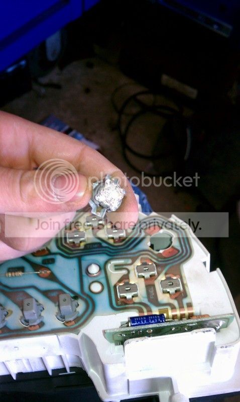

Swapped in some bright white LEDs while the cluster was out:

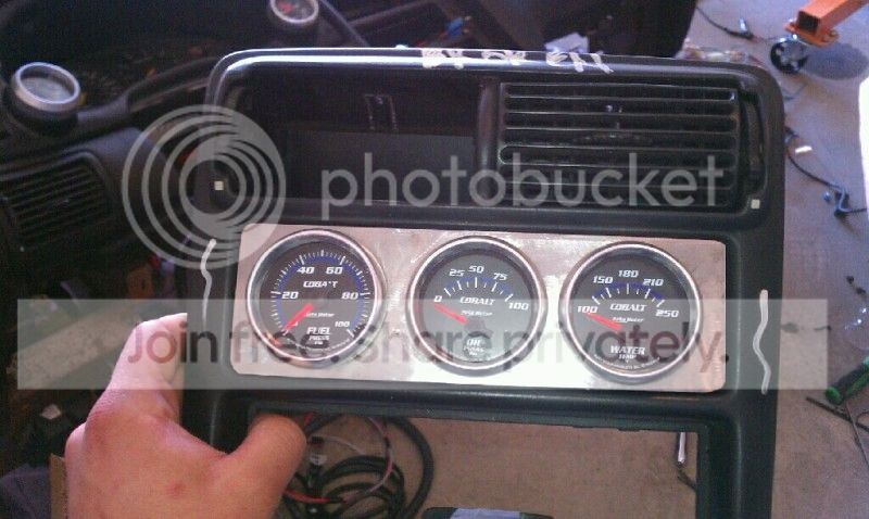

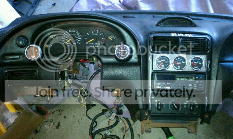

I finally got all the wiring setup on the dash. I have a little bit of mock up left with the gauge bezel and HVAC controls, but here's the mock up:
I think it turned out pretty good. From left to right: (wideband, boost, fuel pressure, oil press, water temp)
I ran all the sending units to one location, then electrical taped them and wrapped them in wire loom. That loom will then exit though the middle of the firewall and to their respective locations.
The cobalt gauges should go pretty well with the cars blue exterior and black interior.. I may have to figure out how to power the dash when it's out of the car just so I can see everything all lit up.

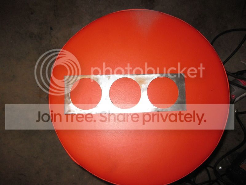

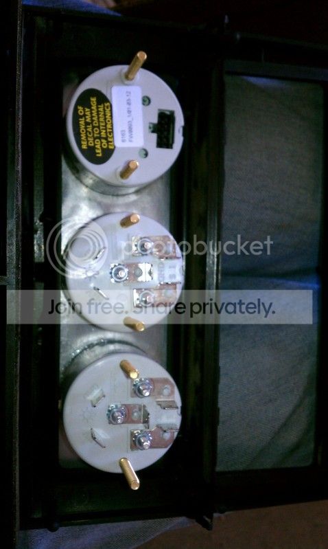

Just a small update as of now. I trimmed the gauge plate a little more. I like this fitment a lot more:
viewed from the rear.. I am still in the design phase of securing the gauge plate. I think I will make another plate very similar, except with the gauge holes wider than the external version. Then drill holes in both plates, so essentially the screws will be pulling the plate in front of the bezel and the plate behind the bezel together, sandwiching the bezel between them.. But we will see.

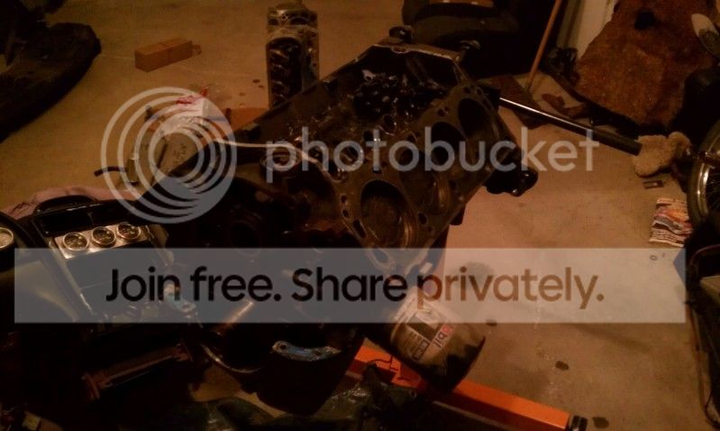

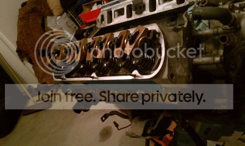

school is done for the semester, so that same day I did a little work on tearing down the engine...
valve covers off... (trickflow rockers sure are purtty...)

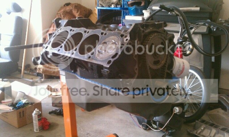

and down to the shortblock (plus an oil pan)
The old cam is long gone, so it is fairly bare (pistons, rods, crank and block remain).. Today I may get the chance to take the oil pan off, start cleaning everything up very thoroughly, get out some block cleaning brushes for the oil/coolant passages, and get this thing looking nice again. Then probably some engine enamel black for the block color. I'm keeping things fairly simple with the colors of of the engine components (black, charcoal gray, polished, or plain clean aluminum)... updates soon to come (much more often than before.. haha).

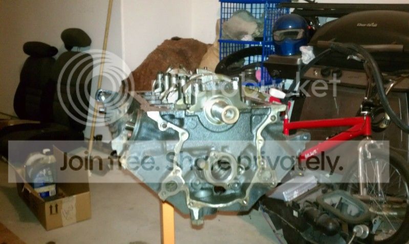

Well I got some more work done.. Mostly just cleaning and starting the reassembly of the engine...
The block all stripped down (crank, pistons, and rods only remain)

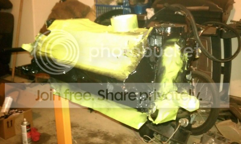

Masked off and sprayed with semi-gloss black high temp engine paint:
After it dried, new melling oil pump and new oil pump driveshaft installed:

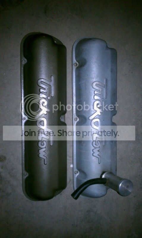

I chose to clean, prep, then repaint the engine oil pan the same gunmetal color I am going with for the accessory brackets, and the valve covers. So far I like the color..
A comparison of the gunmetal color (just one coat so far), vs the silver powdercoat the trickflow valve covers came with...

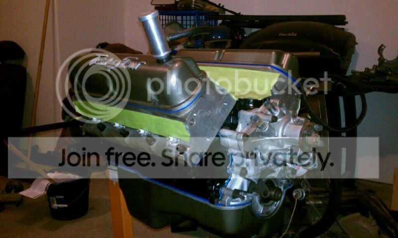

A little more work to the engine... It's starting to come together now.
Headstuds installed, heads on, pushrods installed, valve lash set, valve covers on (I'm really liking the color)
Just a quick mock up with the intake manifold (I still have a LOT of polishing left on it...)

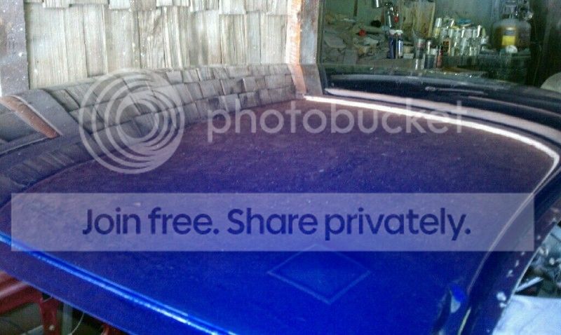

I'm excited to be able to say.... the car FINALLY has some paint on it... it's been 13 weeks, but I can't complain about how it looks so far...
The roof, already wet sanded and buffed.. Its a little dusty, but it felt as smooth as glass, and I looked for a solid 5-10 minutes and I couldn't find an imperfection yet... There will of course be a more thorough final inspection though:

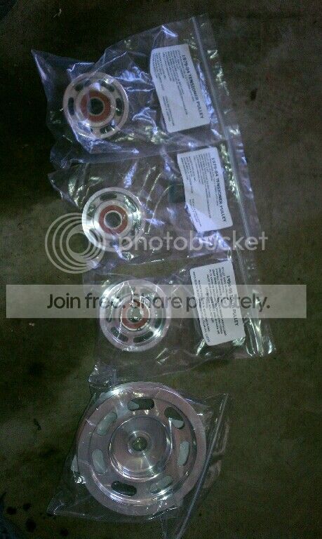

-Wazee pullies:
(2) tensioner pullies (1 for regular tensioner, other for vortech tensioner)
(1) idler pulley (for regular belt)
(1) p/s pump pulley (obviously for regular belt)

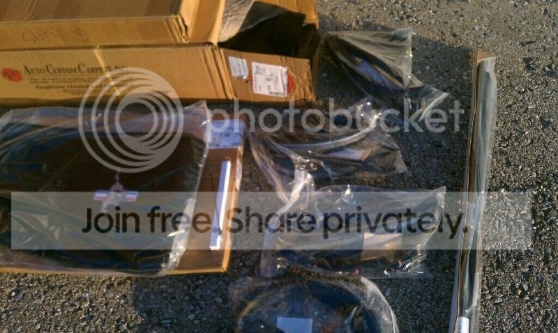

some of my ordered parts came in (unfortunately the more boring of the bunch, but important nonetheless..
New black carpet, floormats, door-to-body seals and roof rail seals, door-to-window rails and a shorty antenna:

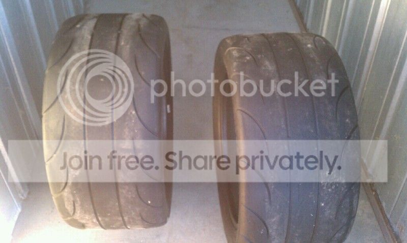

I found a pair of used Mickey Thompson ET streets on craigslist.. 275/40/17. The guy was asking $150 for the pair, when I went to look at them one of the tires has a small cut in the shoulder of the tire (that he "didn't notice") that I'm not sure if I can repair, so I paid $60 for the pair.. If the one is trashed, oh well I will look for another used one or sell the one good one.. I plan on putting these on the set of 17s I have as spares for track use, as the 18" chrome saleens will be the primary wheels on the car.

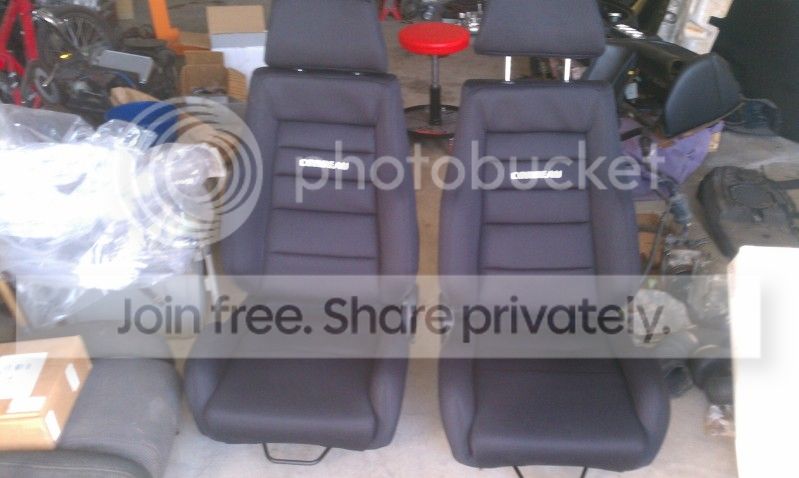

My bigger, more exciting order of parts finally came in..
I love it when you know whats in the box, before you open it:
Assembled with seat tracks (The plastic bags went on over them right after this pic was taken):
And all the Wazee pullies.. I got the tensioner, idler and p/s pulley for the main drive belt, and an extra pulley for the supercharger tensioner pulley... Hopefully I will be assembling the front of the engine within the next few days:

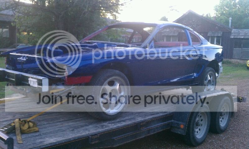

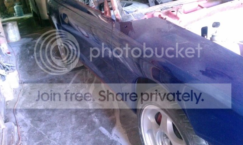

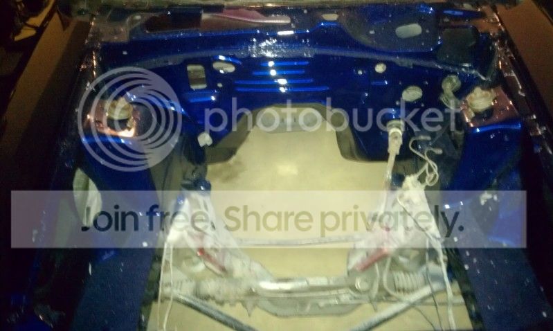

Got the car back from paint. overall I am pretty happy with how the body turned out. There are a few very minor imperfections, all smaller than a quarter, and all very low on the body panels, but the painter said once it's all put back together, he would fix them for me all at once. So, onto the pics (I apologize, they're all with my phone and don't do the car justice):
Loaded up:
Reflection in the door:

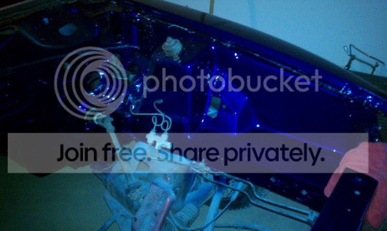

Underhood. (The kmember/rack look white from all the paint/sanding dust, but they'll be getting replaced so I'm not too worried about it)
Passenger side of underhood with phones flash on (shows off the purty paint):
Drivers side:
I will be working on the car more today, hopefully getting some good progress on the fatmat sound deadener, possibly the dash back in. I may roll it outside and take a picture of the paint in the bright sunlight, I always thought that's when sonic blue looks the best. Questions/comments welcome..
