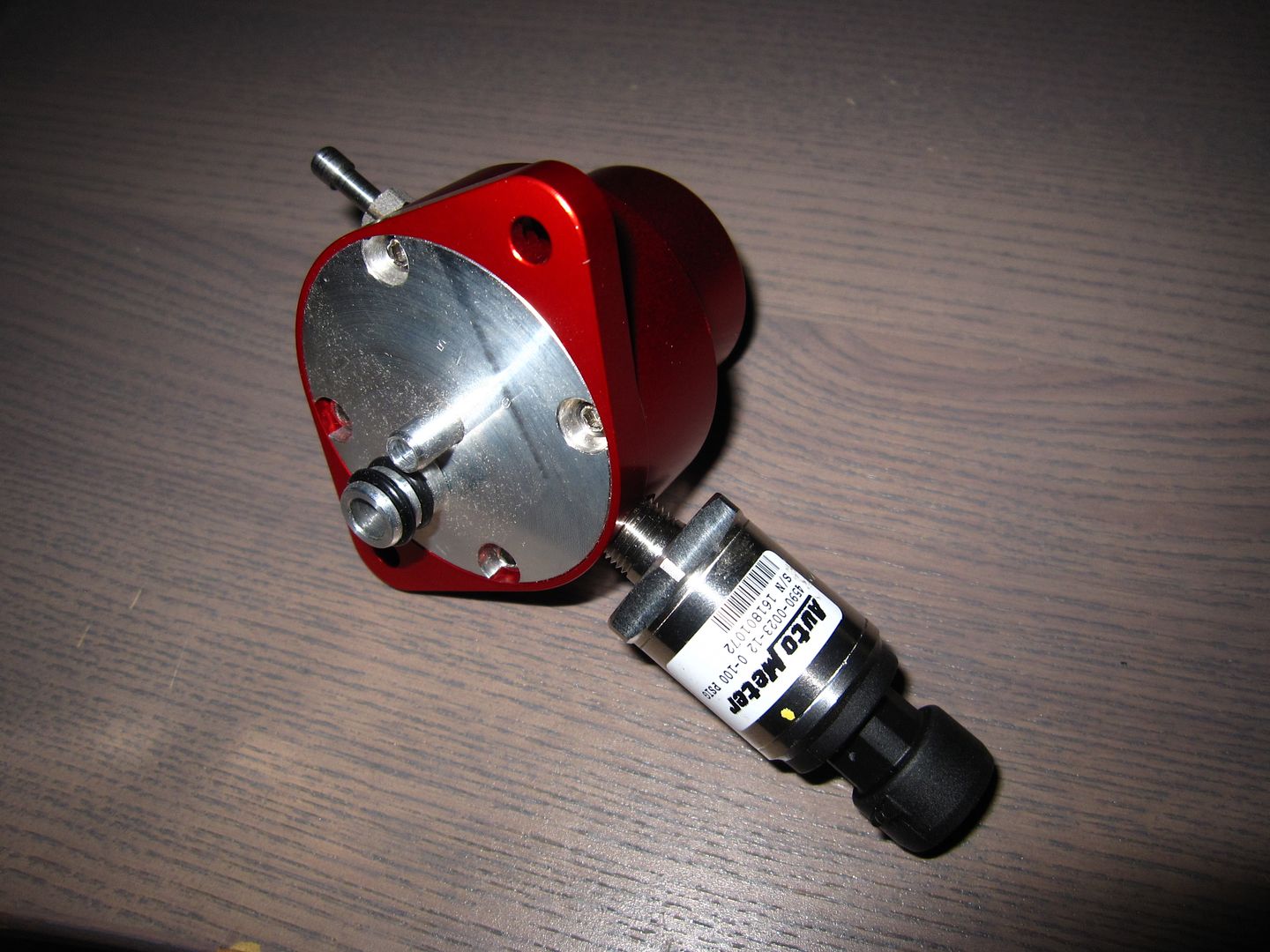

Super minor update: received the new fuel pressure gauge and Aeromotive FPR...
The Auto Meter sensor screws in to a port provided on the FPR:
I currently have a Kirban adjustable FPR, and it's been fine (other than the adjustment screw rusting). However, it doesn't offer a separate port (that I know of) to make installing a sensor easier. So, time for the Aeromotive. I've always really liked Aeromotive products, never had a chance/opportunity to use their stuff. Looking forward to it.
