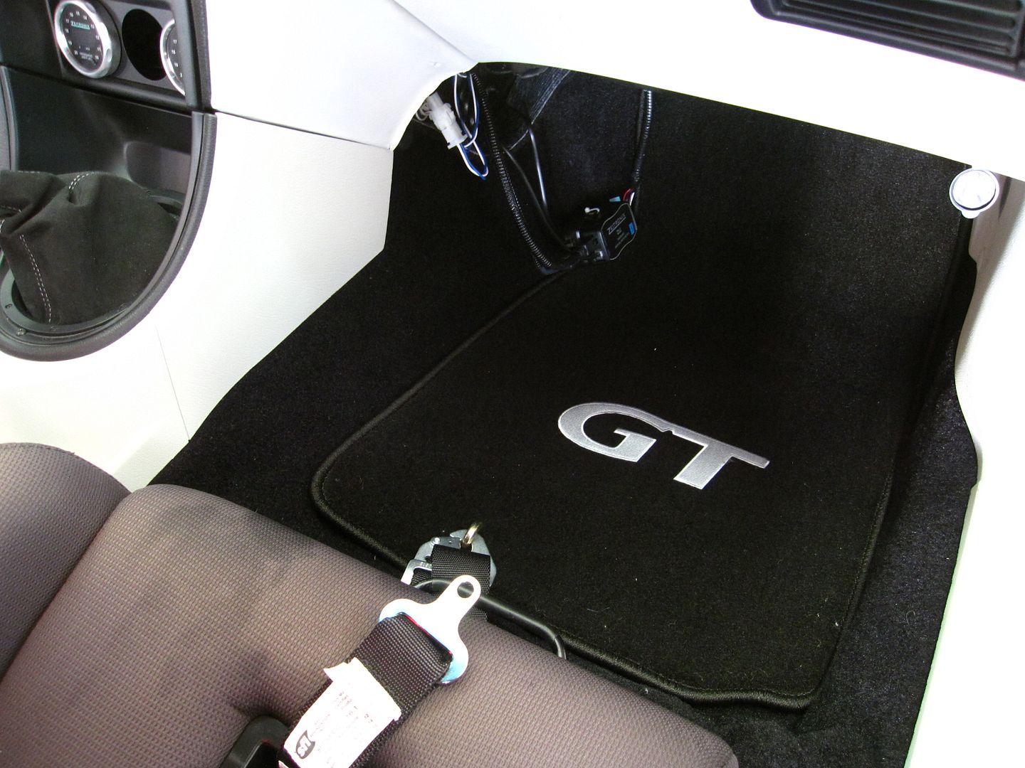

I also picked up some new floor mats....just because.
I had to cut a little hole in the mat so the eye bolt for the submarine strap to the harness can clip in ;) Of course, on the track, these mats will be removed. But the eye bolt is now a permanent fixture in the car, and I didn't want a lump in the mats. I think they look pretty good. The "GT" part is like a really light silver/almost white, so it looks nice with the white interior bits.
