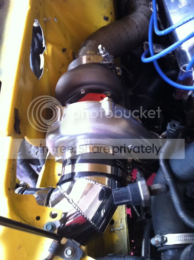

Feb 10, 2011 #3 OP OP alex302 Active Member Joined Aug 27, 2010 Messages 940 Reaction score 17 So far it's been good, had to cut some body work on the passenger side to clear the turbo flange and on the driver side the Ac compressor hits the header so I had to massage the tube and Ac to fit.

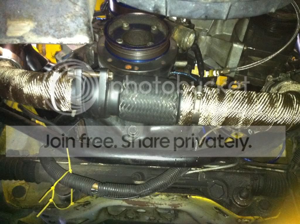

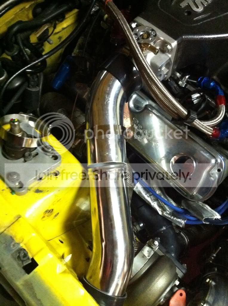

Feb 11, 2011 #9 OP OP alex302 Active Member Joined Aug 27, 2010 Messages 940 Reaction score 17 Down pipe

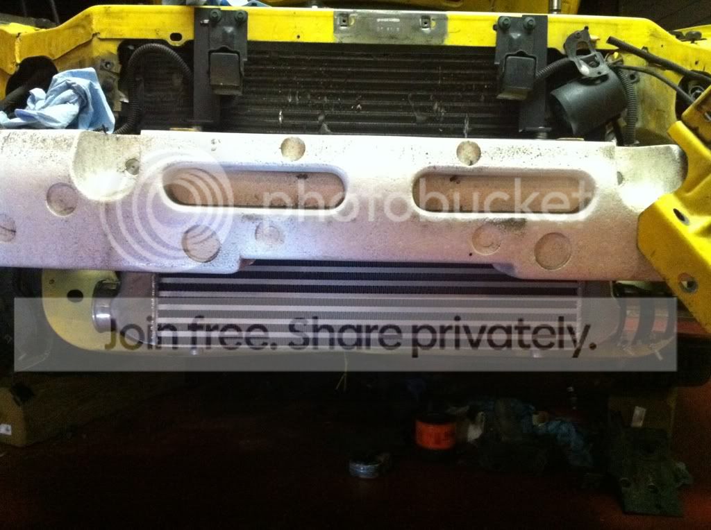

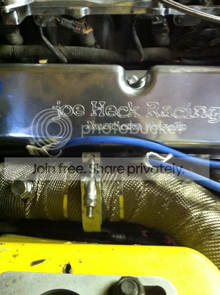

Feb 12, 2011 #12 MustangChris Mythic Level Joined Aug 20, 2008 Messages 27,282 Reaction score 951 Location Aurora, CO that downpipe didnt give much clearance for the wires! hope you dont mind tearing it down to change them you planning on cutting the styrofoam from the bumper? it takes up quite a bit of space...
Feb 13, 2011 #13 OP OP alex302 Active Member Joined Aug 27, 2010 Messages 940 Reaction score 17 Yea the plugs and wires on that side are know and all day event, but it's the price you pay. The bumper foam I'm leaving for another day.

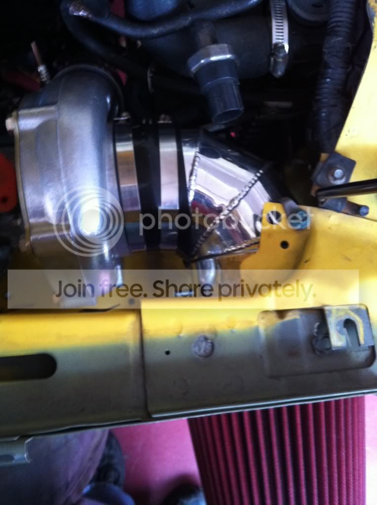

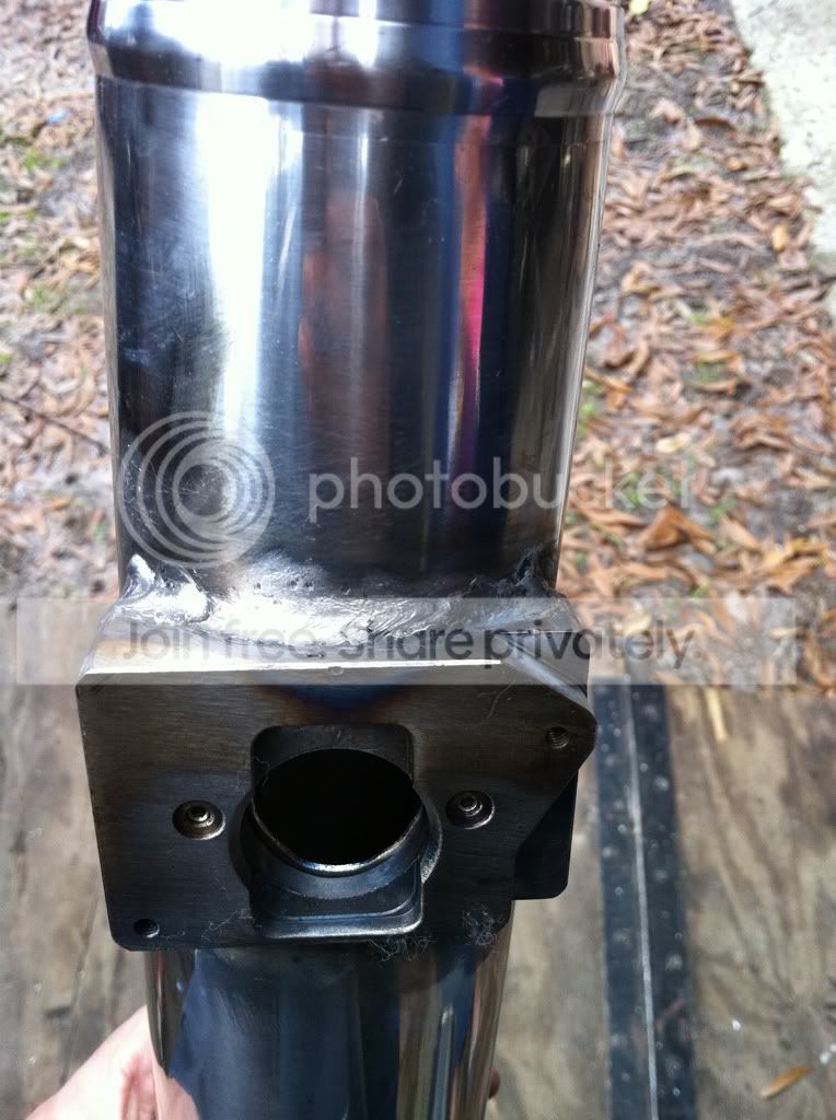

Feb 13, 2011 #15 OP OP alex302 Active Member Joined Aug 27, 2010 Messages 940 Reaction score 17 Had to do some mods to the intake tube due to the fox TB.

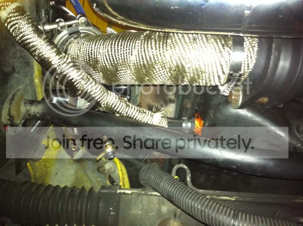

Feb 15, 2011 #18 W Win Legend Joined Nov 20, 2006 Messages 9,508 Reaction score 17 Location Kennesaw, Ga Is that oil feed line only being held onto the fitting with a hose clamp?
Feb 15, 2011 #19 Dalamar Post Whore Joined Feb 3, 2006 Messages 13,823 Reaction score 133 Location SLC, UT nice progress
Feb 15, 2011 #20 OP OP alex302 Active Member Joined Aug 27, 2010 Messages 940 Reaction score 17 The oil line that is on the oil pan with the hose clamp is the oil return line from the turbo.
