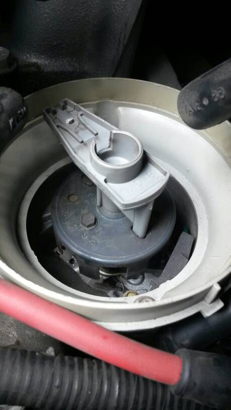

Well man, I don't know why I didn't pull the cap off sooner...

Yeah, oem replacements can't be too much to at least see if it happens again. Might get two so I have a back up. The tow cost me $100 last night.

New rotor didn't take care of it. Bought a cap too, but figured I'd try my old one first. The story continues.
