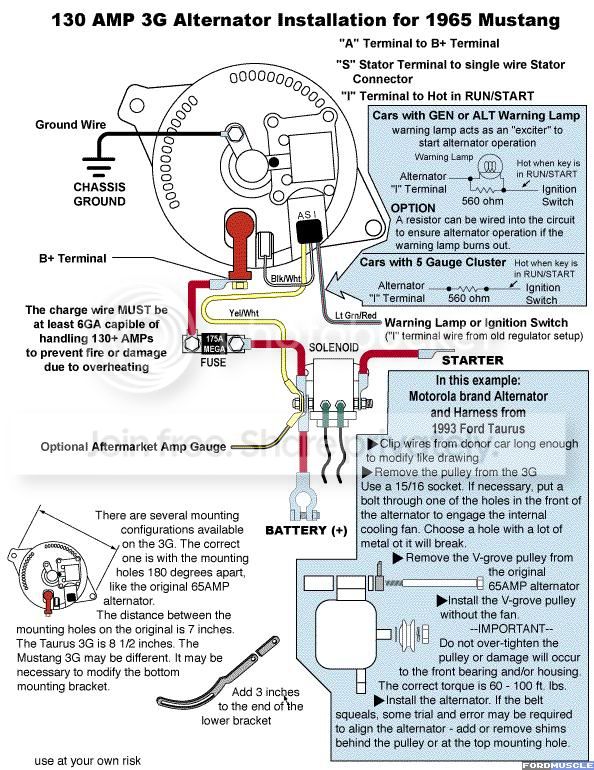

ok looking at that diagram it does look easy. Trace the wires back down as far as you can and make sure that there are no loose connections. Also see if you can find those fusable links as they might be failing once the motor heats up.
One other thought, there is a voltage regulator in the dash of the sn's that goes bad and can cause some funny problems.... Notice any heat from the instrument cluster.

i thought of the fusable links. when the alt wasnt charging. checked with ohm and found connectivity. Also when alt wasnt charging the volts read the same at the battery and "hot" wire behind alt. when the alt is charging he volts read the same as well...im thinking it has something to do with the signal that goes to the regulator on the alt.

thinking of doing this wiring test

the yellow wire to the fuse box and replaced the white stator wire and plug. not the green wire cause i figure if my gauge is working that wire is working...

okay...i have attached a jump wire to the the green wire that goes to the gauge and interior fuse box with is explained in the above "65" 3 wire conversion diagram as the exciter wire...and the alt meter and the alt gauge jumped to 13.5 v.....trouble shooting is now focused on tracing the green wire, replaced the #18 20 amp fuse for the hell of it. no change...
