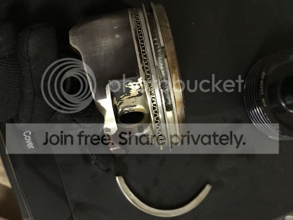

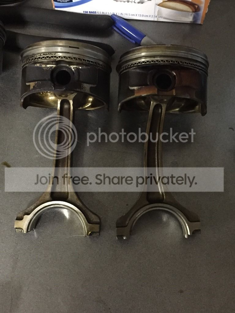

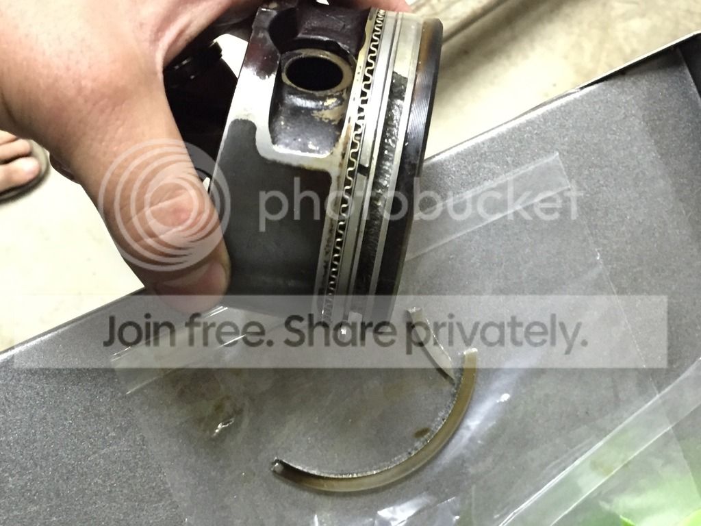

Well gentlemen, all Pistons are cracked aside from 3/7/8 and the #8 rod is bent pretty bad. I think this would explain a lot of things eh? Working on getting the main caps off. Got one off but can't manage the others yet. Me mechanic buddy told me to screw the bolts back on and rock them a little and they should come out. Any other suggestions?
Meth kit, 2.75" 8 rib Vortech pulley, Diablosport MAFia, Edelbrock Vic Jr. Intake, Accufab 90mm tb, plenum Elbow may end up being for sale here very soon so financed a new stock engine for his thing. Let me know if you have interest in any of these items guys. I may sell my 6 rib 3.12 Vortech pulley as well, as I want to be no more than 10 lbs of boost with blow thru and front mount. I think a 3.33 would be more in line with my desired numbers. This could all change, just putting the word out.

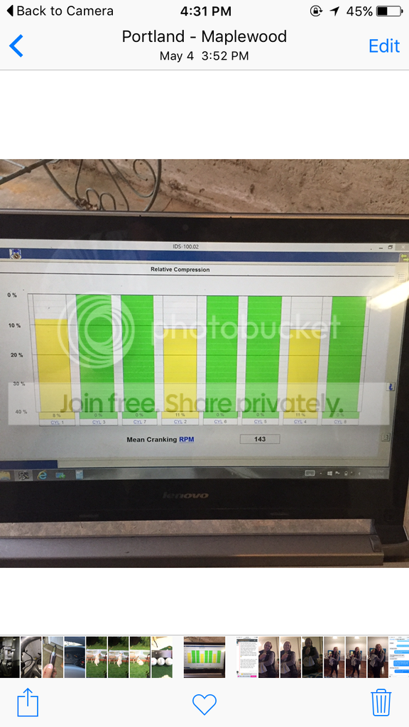

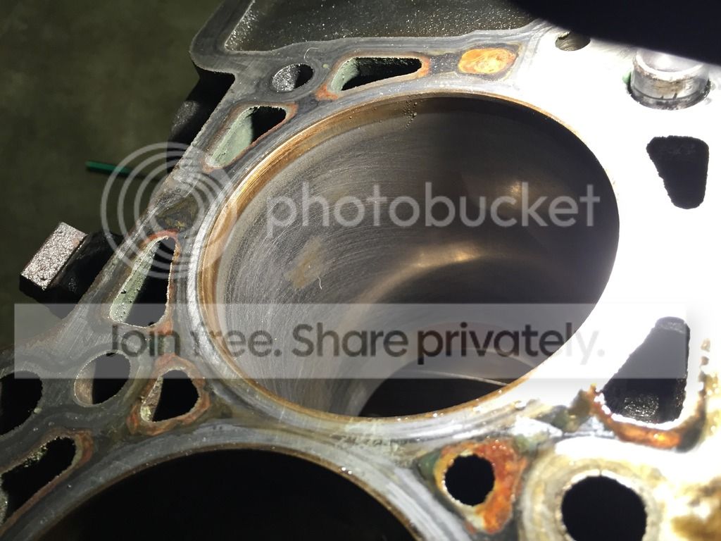

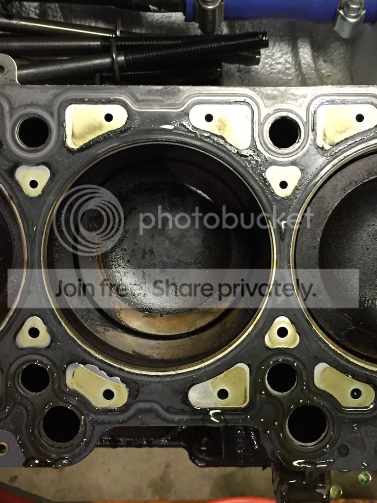

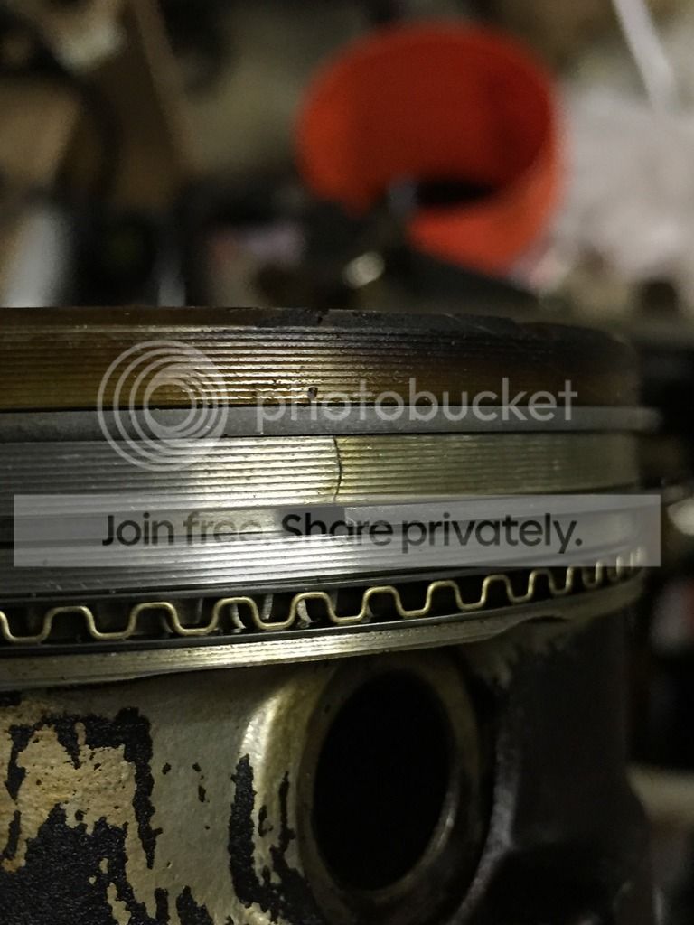

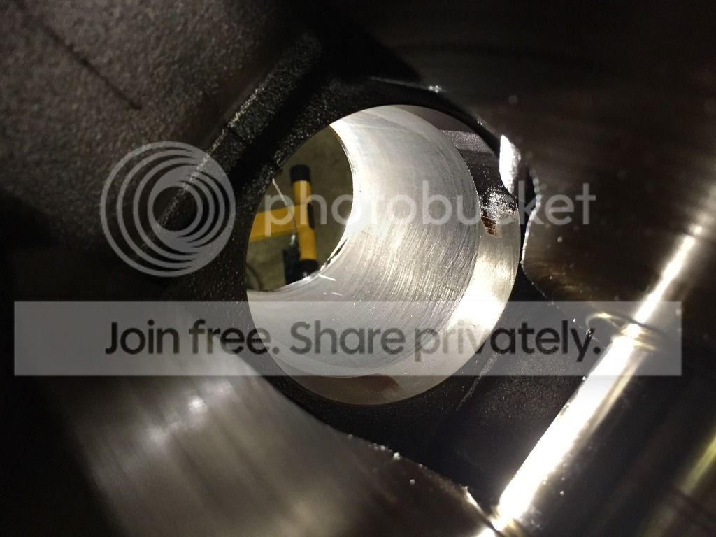

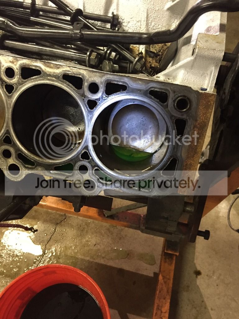

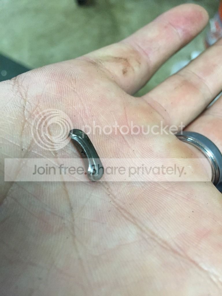

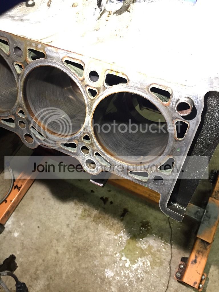

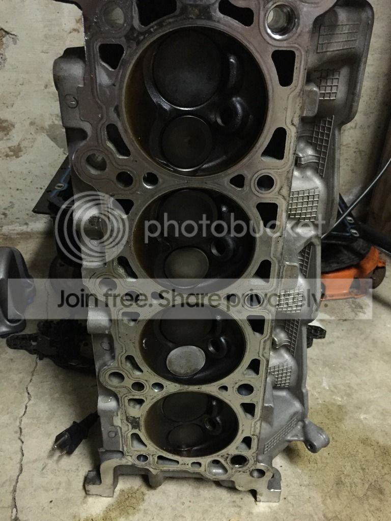

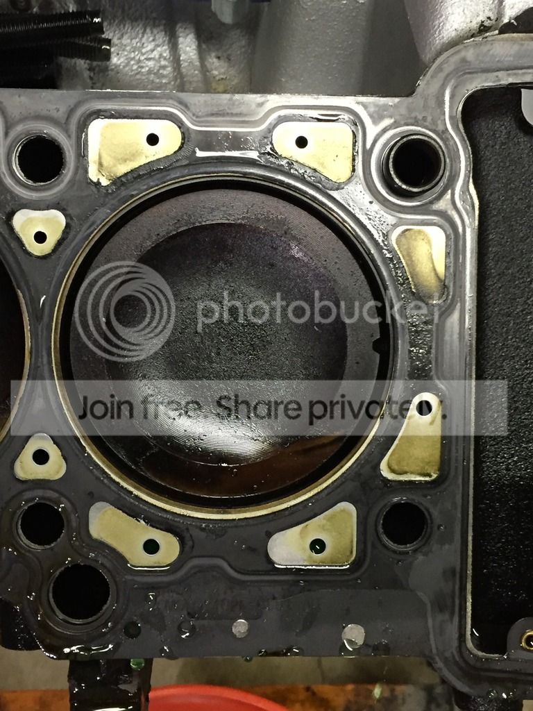

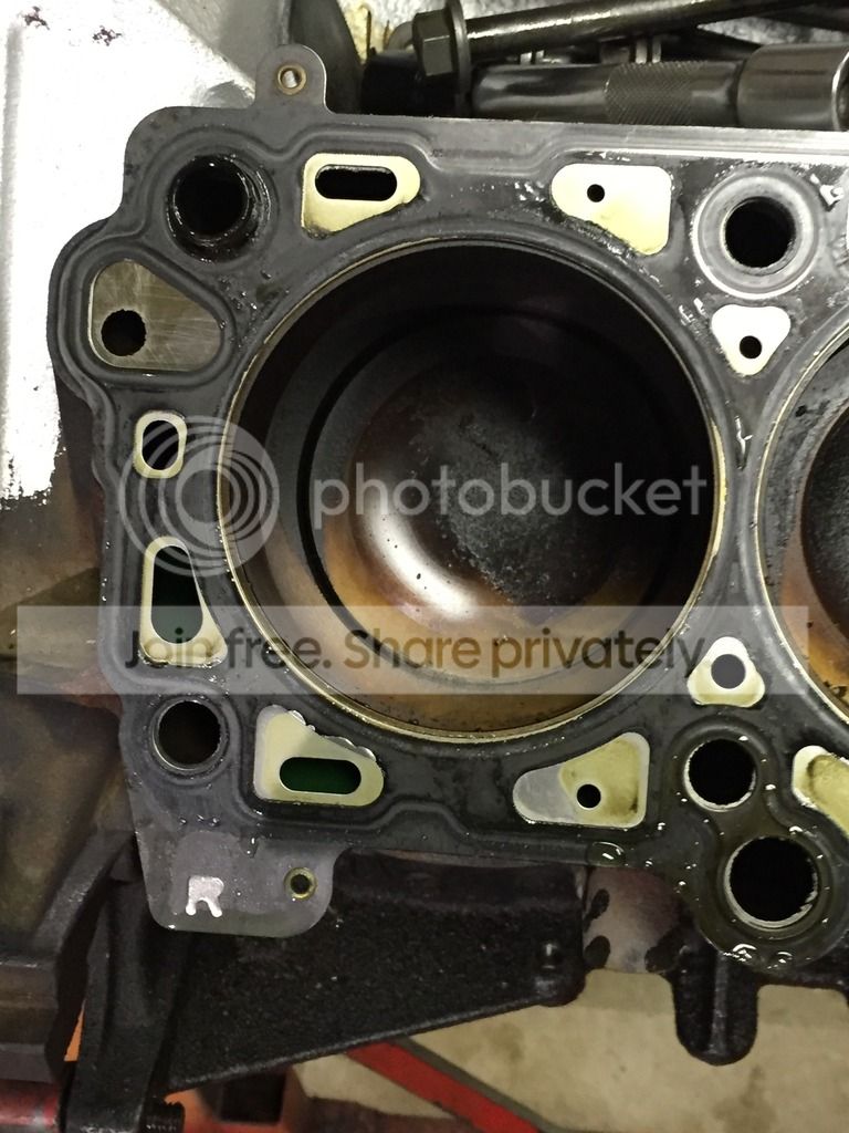

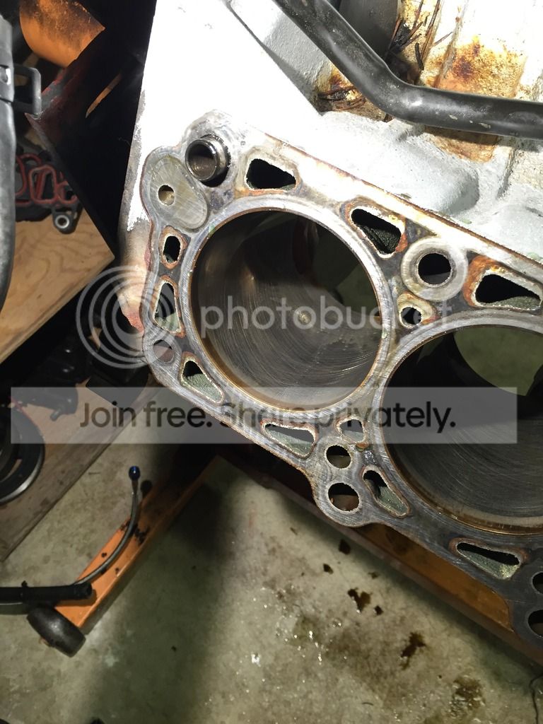

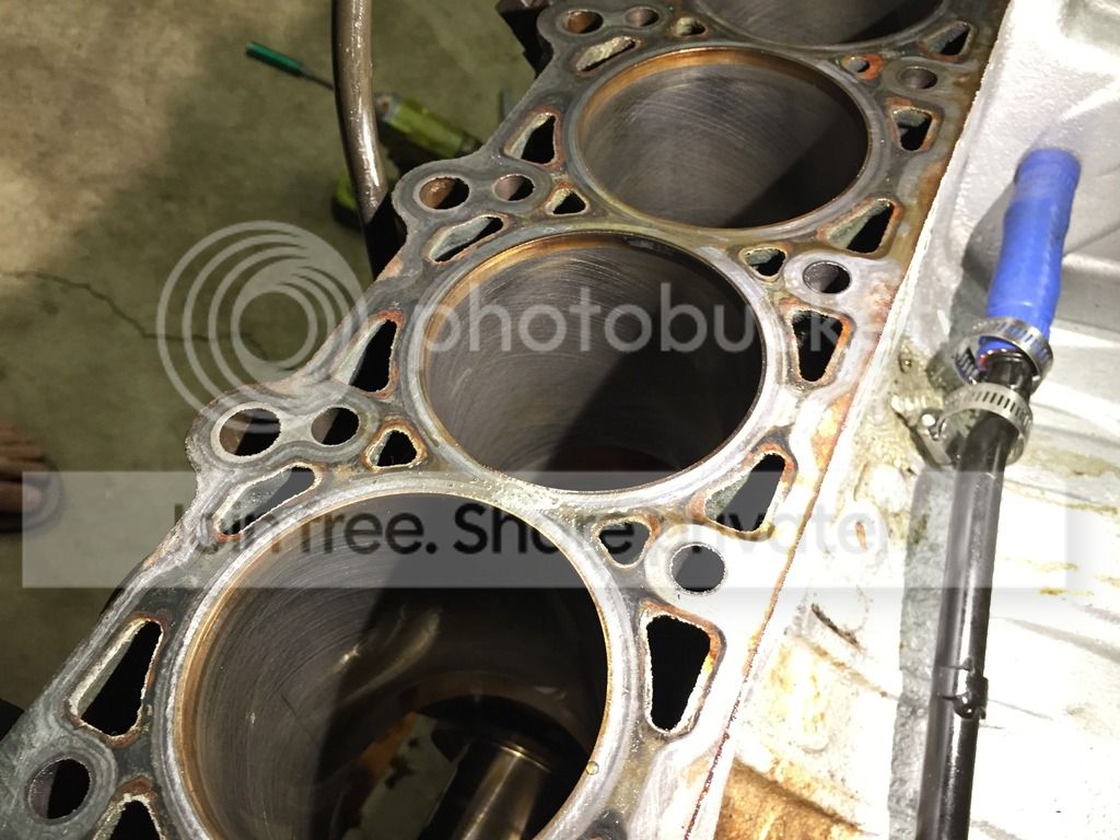

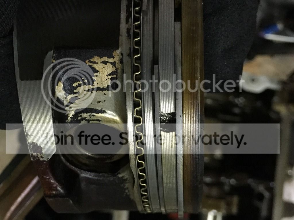

Here are some photos. I was hoping you guys can give me a bit more insight as to what you think.
These are the initial reading my buddy took with his scan tool:
Bent Rod:
HG and Piston Tops:
Piece of metal I found sitting on top of a piston:
Coolant in # 8:
Shots of the cracked piston ring lands:
Some cylinder shots. How do these look to you guys?
Shot of the valves. I really don't know what to look for regarding the condition of these:
Do my valve springs looks stock or aftermarket:
