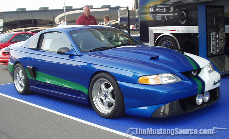

1998 and Ford fits Brembo 4 piston calipers on front and rear on the super stallion mustang

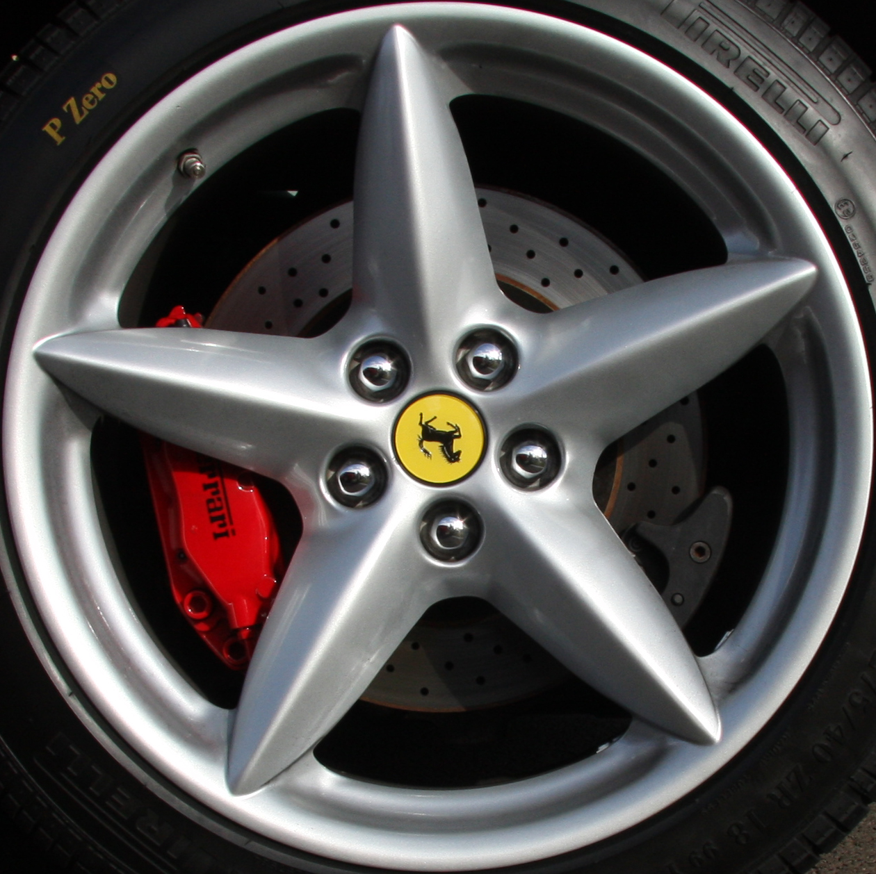

For sure, installing a big brake system on the rear of a mustang is one of those things that you either get it or you don't. I think it's cool for my car to have an almost identical rear brake system as this Ferrari F360.
