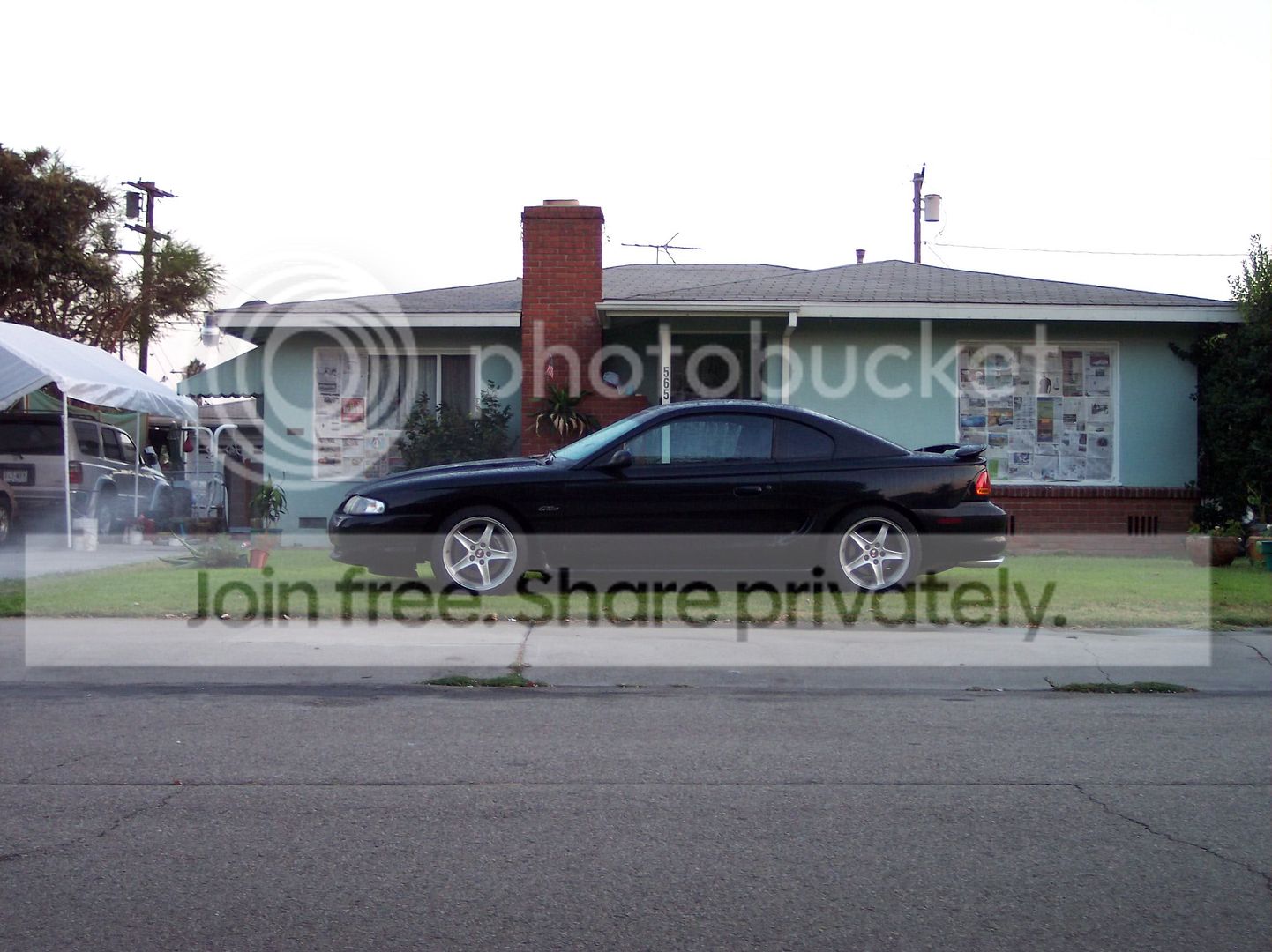

zoom in on the rear brakes to see what the 11.65" rotors look like behind the 95 cobra R style wheels:
(ignore the paper'ed up windows...was getting the house ready to get painted. and notice the front brakes as well, im sure you'll like those ;D)

yup. the front cobra brakes will fill up the front wheels pretty much the same as the wilwoods fill up my front wheels (except for the calipers, of course), and the rear ones are the stock rotors. whatever you do tho, get the stainless steel braided lines. my friend got them on his 240sx and it made a huge difference. i have them on mine too, but i installed them at the same time i installed the wilwood kit, so i cant really compare the before and after effect of the lines alone.
