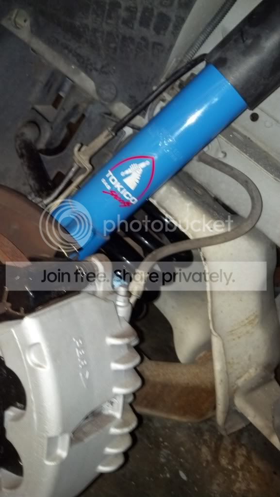

-tokico shocks and struts (blues)

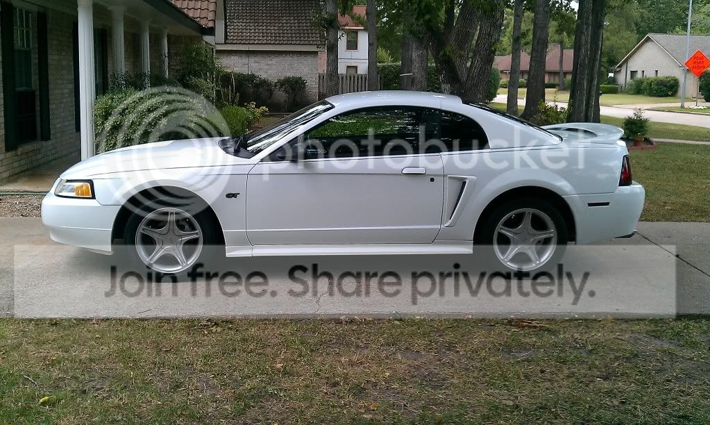

Completely bone stock with 85k on the clock

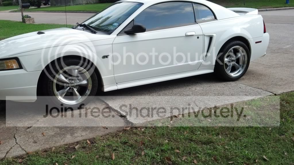

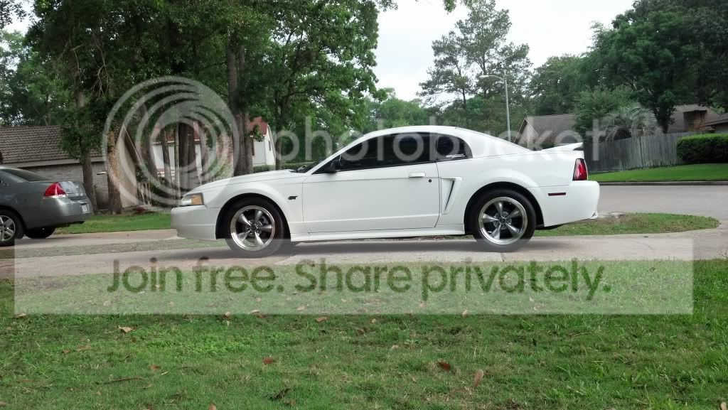

How it sits today.

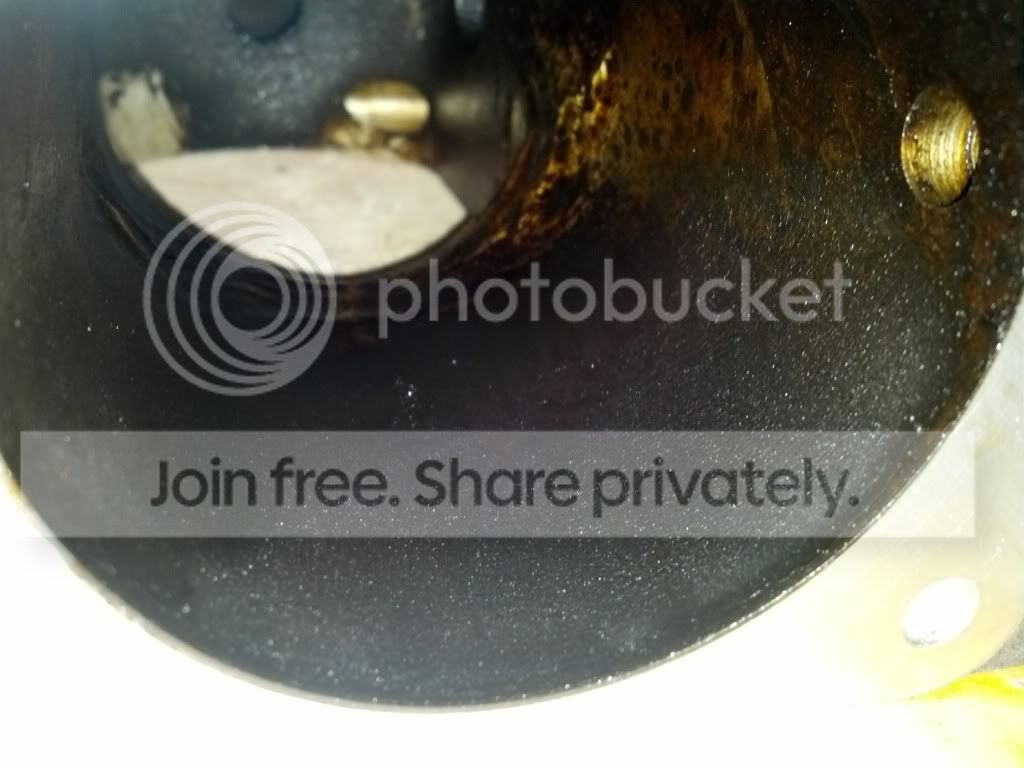

Springs are on hold. car decided to take a sh*t on me today. It idled at 2500 and wouldn't drop lower than 1500. I couldn't find anything wrong, so i dropped it off at the shop :(
C
Cpotts13
Mar 11, 2012
1,594
36
Biloxi, MS

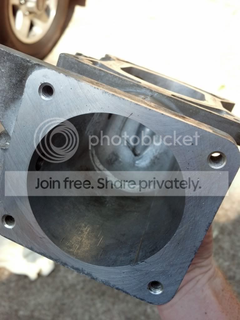

Alot has happened since I lasted posted, the idle problem was solved by cleaning the throttle body and plenum with som carb cleaner and all new gaskets for everything..
Like i said, it completely solved all my idling problems.
Also had the time to install my lowering sptings and caster camber plates, took me and my friend about 5 hours at a slow pace.

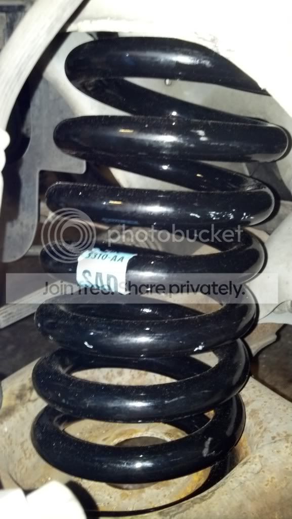

Alright, ordered a set of J&M lca's, and some polyurethane spring isolators. Ive realllll gotten sick of the squeaky bushings on the factory lcas and the "clunking" from installing lowering springs without isolators!!
JRad405
Dec 1, 2010
769
15
Central NJ
For the clunking check if the springs are seated properly. I had clunking on a different car and it was only because of that reason.
The car looks good. My car was bone stock when I got it with 85k on the clock too.
C
Cpotts13
Mar 11, 2012
1,594
36
Biloxi, MS
i will find out soon! haha. The parts should be in saturday.
JRad405
Dec 1, 2010
769
15
Central NJ
Sounds good. I run ISO's on my B springs (similar drop to C springs). Honestly I think it's worth it and I don't really notice much of a difference. Plus I live in pothole land.
