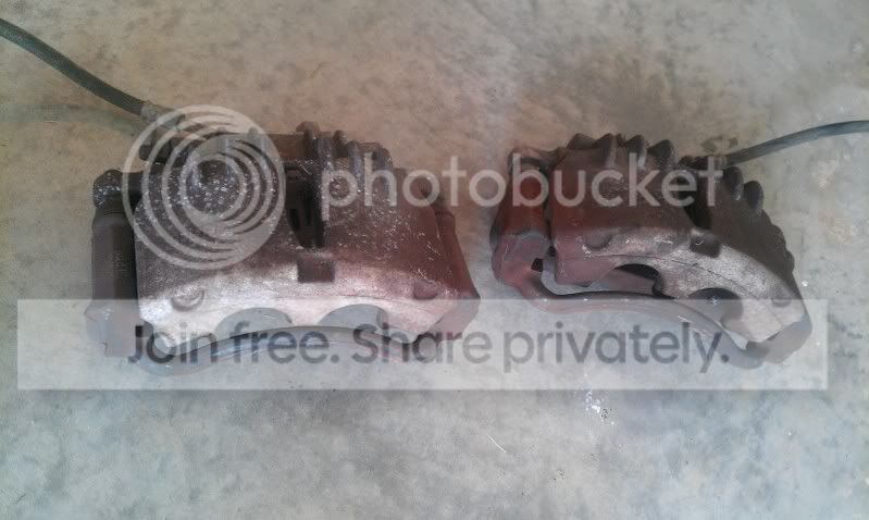

I went to the junkyard to find a couple upper control arms that would be easy to snatch with no luck, but I grabbed some pbr calipers and a good pony emblem. Mine has a broken pony tail lol.
