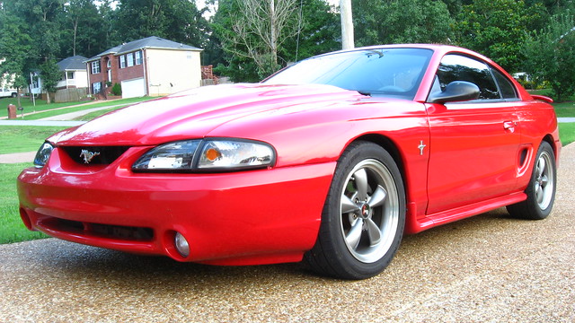

I just put my fog lights in. They are off of a Bonneville, and only cost $4.
Sorry about the crappy pics. I need to get my real camera out. :/

Can you tell I'm bored today lol. I did the fog light mod so they come on with the parking lights earlier, and I put in some 885 bulbs in the fogs as well.

Yeah a 200-2002 Bonniville, and they were really easy to install too. The brackets have 2 studs sticking out the back, so I just drilled some holes in some straight stock and bolted them to the factory holes.

The 885 bulbs melted the lens on the fog light housings. They are ridiculously bright though, so now I'm going to try and find a set of glass fog light housings that will accept the same bulb. These lights increase my night visibility by 50%. If I can't find any, I will swap back to the stock bulb, which will suck :/
