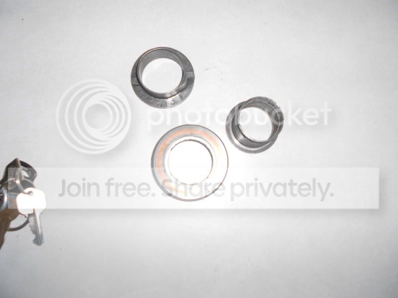

Here is the carnage of the throwout bearing. This is how we found it when we pulled the motor.
Hhahahaha. I got the FRPP one to replace it along with the FRPP pilot bearing.

Yea Ive read that using any throwout other than the FRPP one will result in this happening.

luckily changed mine before it exploded. i took it off and I literally was able to pull it apart by hand.
