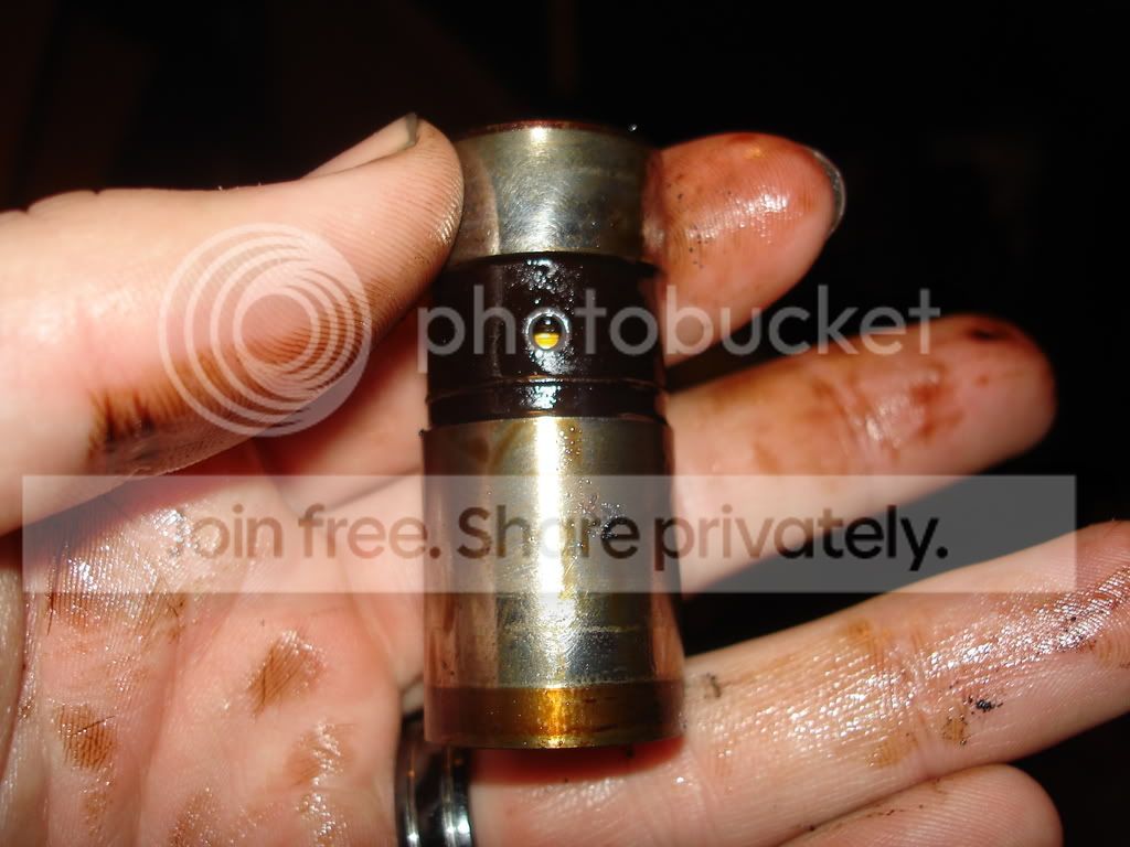

It's official. I just pulled a rocker and pushrod, then yanked the lifter out....
It's Hydraulic... woohoo!!! Less money, easier to find cams, more lift, and more power! plus the fact i won't have to adjust every so often.

Paul said:
Are they hydraulic roller or hydraulic flat tappet?
damn man... keep busting my bubble... LOL... I don't know, how do i find out? what is the visual difference?

Post up a couple pictures of the lifter for me and I'll help you out. :hammer:

Ok, gimme a few... as far as the hydraulic lifter, it has no spider thingy... the black metal piece in the middle betrween heads, there isn't one... so i guess it's hydraulic, but it's not the same as a 302...

Those retro-fit lifters are very expensive. You can drill and tap the two holes yourself and use OEM Ford hydraulic roller lifters. Roller lifters will have a roller surface on the bottom of them instead of the flat surface like the ones you have. You can get the spider, bolts, and dogbones out of any 5.0. This is how my silver convertible is set up and it works fine.
