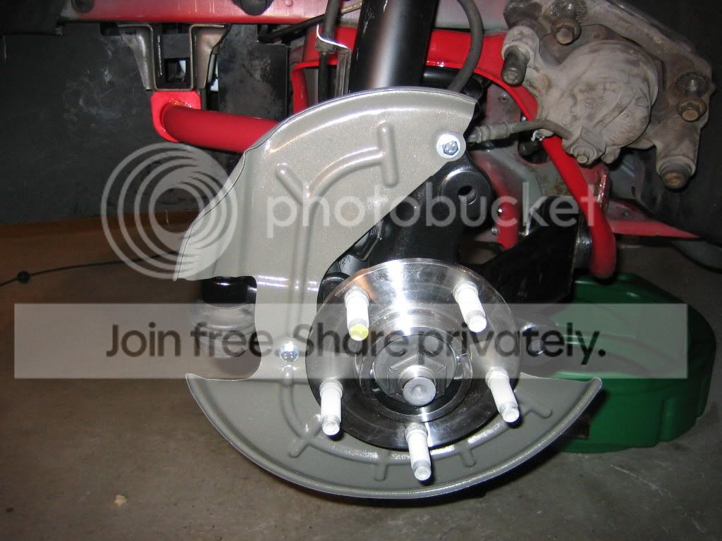

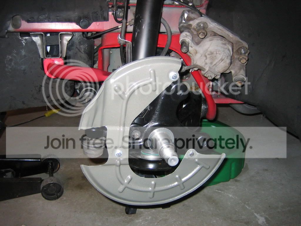

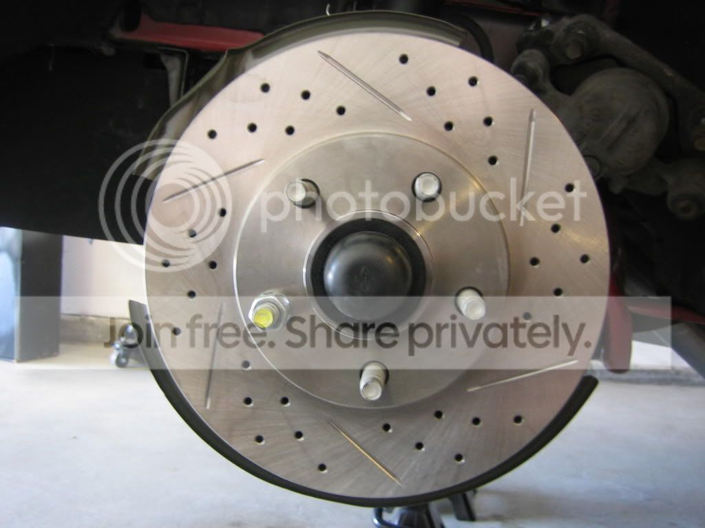

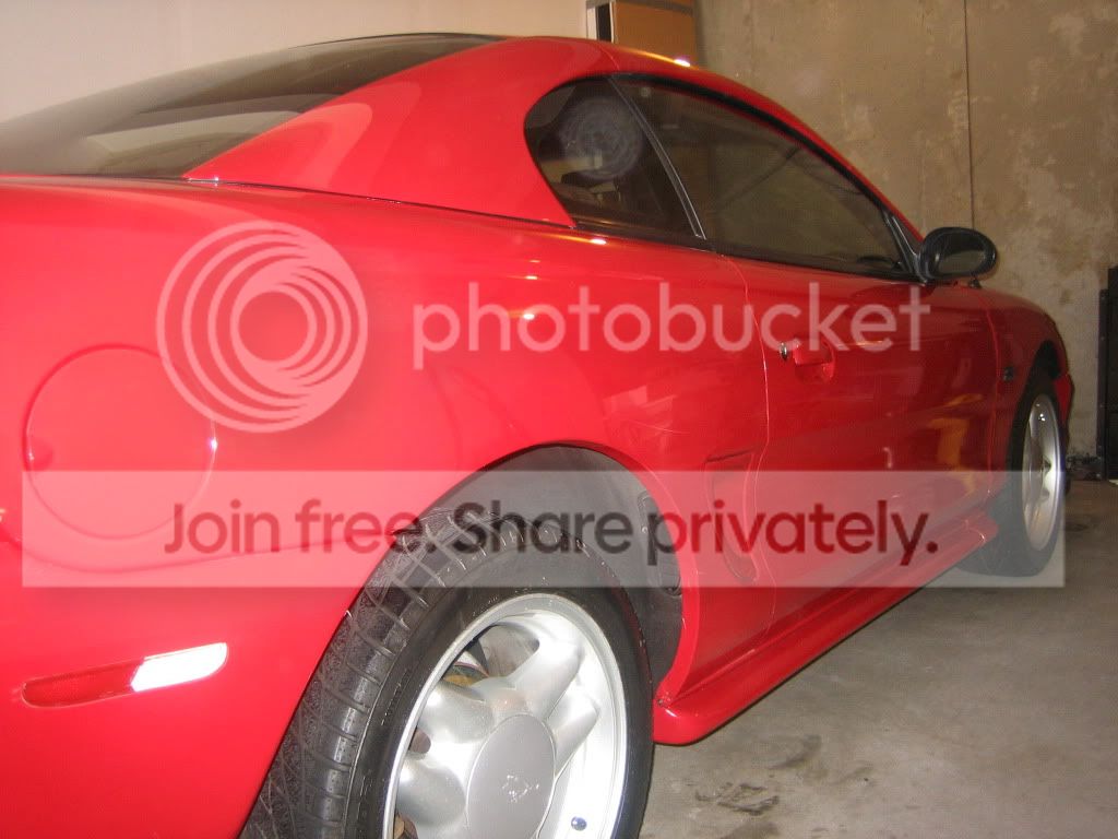

I have been hanging around for a while, but this is my first post. I installed a new Eibach prokit, new bushings, ford racing upper control arms, mm lower control arms, mm caster/camber plates, new wheel bearings and 03 cobra front control arms. I'm also that guy that cleans, paints or polish everything. Here is a few pics of the front. What do you think?
After
Before

Cool. Your first post but looks like you really did your research before hand. Great set of mods and certainly dont the right way. You car looks very clean. Kudos to you sir

+1 Well done, looks like you have great craftsmanship and an eye for detail! Very clean ride

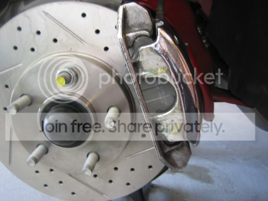

5.slower said:
How did you polish the calipers?
The Dermal tool was pretty helpful in this. I sanded (a lot) and then polish with Mother?s metal polish. Checkout the polishing post in ?good how-to?s? it really got me motivated polishing parts.

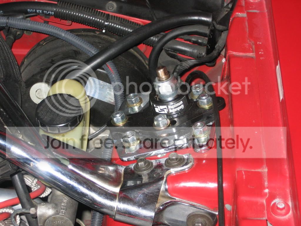

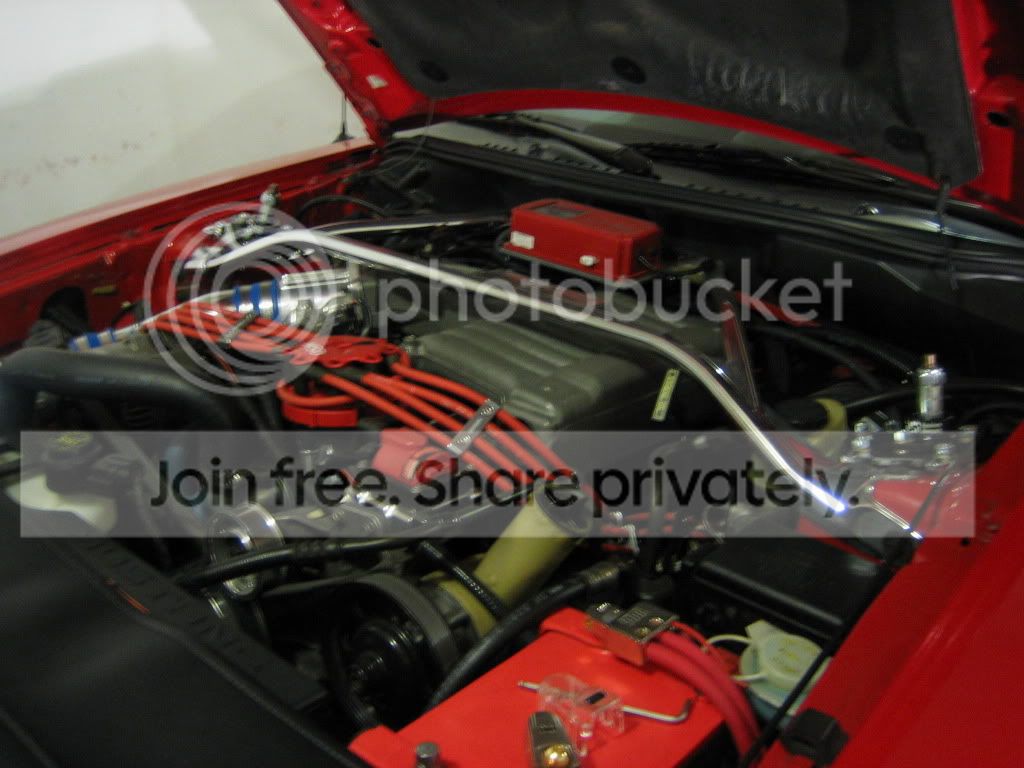

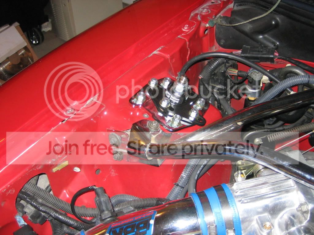

Sorry this is a little off topic but does your hood hit your strut tops? Your CC plates look like they have too many spacers up top.
The rest looks great!
JPOTTER
JPOTTER
Nov 12, 2007
12
Utah
I hadn?t tried to close the hood when I took the picture, but they did hit the hood. I original use the recommended spacer set up, one small on bottom and two big/one small on top. There was just no way it would work. I change it after reading others post that had the same problem. It looks much better and everyone I talked to siad it doesn?t make any difference.
Here is a new picture.

I don?t know if my setup is going to work correctly. I?m running the spacers for stock ride height, but I have the pro kit that lowers the car. As stated earlier I didn?t think the hood would clear with the 2lager/1small spacer on top. My question is should I change it now that I had a front end alignment? Should I try putting the spacers back?
