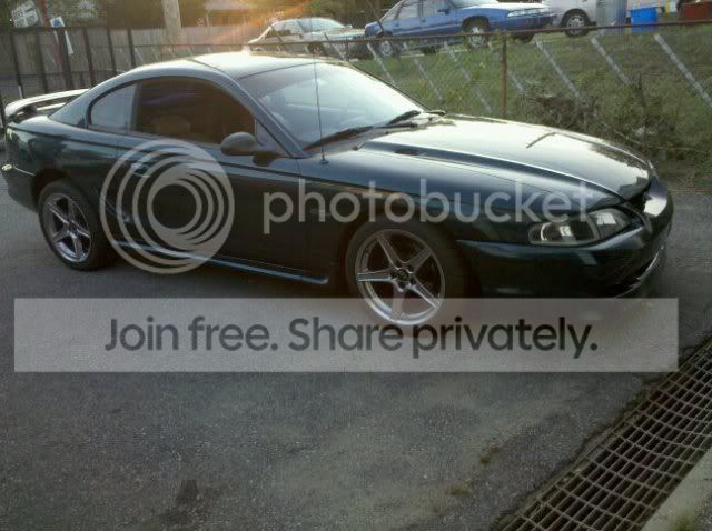

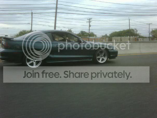

i had the shocks/struts/springs and cc plates laying in my garage for about 2 months now and finally dropped it..
i only have the front due to i ran out of daylight and have no power in my garage to run lights on.. tomorow i will finish and update with more pics
i have
-eibach pro damper shocks/struts
-h&r ss springs
-mm caster camber plates
before
after front drop only
full front and rear
my brothers car and mine
