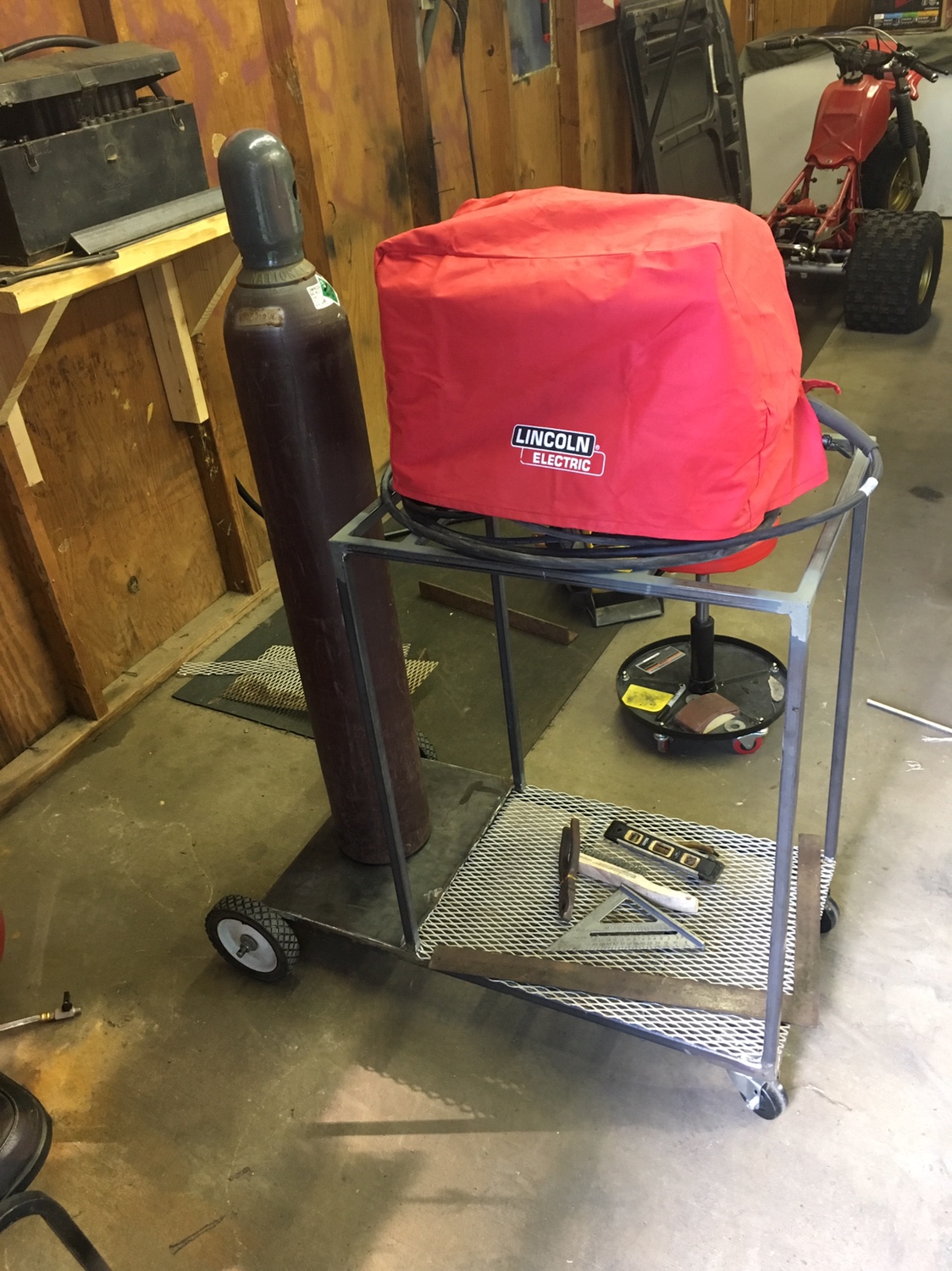

Not much progress made on the car yet, but I've been working on another project in the shop I thought some of you might like to check out.
Since I have the car at the house now, I no longer had access to a welder and still had a few things left to weld up before I can get much further along on the engine bay. So for my birthday my dad and I went in half on a new Lincoln Easy Mig 180. It's a 220volt welder so I scored some free wire at work and came home that evening and added a new circuit in my shop for the welder. The next day after work I went and picked up a bottle and some metal and got started on my first project - a welder cart. I didn't take many pictures when I started, but the base is made of 1" square tubing, and the rest out of 3/4" square tubing. It's pretty simple, and I'm still not done yet. I ran out of material and didn't get to build a shelf in the middle. But here's what I have so far:
I made the axle out of 1/2" all thread and all thread couplings, then drilled the ends so I can put cotter pins thru them and keep the nuts from ever backing off.
I'm by no means a good welder, but I did surprise myself since I haven't used a welder since high school.
This is how it sits now. The top shelf has holes drilled in it so the welder will bolt to it. I have a piece of sheet metal to put over it and rivet to the shelf after I'm done with the rest and have it all painted.
All I have left on it is to fix some mounts so I can strap the bottle down, add some handles and hooks for rolling up cords, and build the middle shelf. I haven't made up my mind yet if I want a fixed shelf or a slide out drawer. I have plenty of slides if I decide to go that route. The shelf is gonna be about 18" above the bottom rack, high enough that I'll be able to set my chop saw on the bottom rack.
Atleast now I'm able to set the welder and bottle on the cart and roll it around the shop. I didn't want to just get a brand new welder and go straight in to welding up some thin metal on the engine bay. So I figured this would give me a chance to be creative and get a good feel on how the welder works and reacts to welding different thicknesses of metals. I'll add some more pictures whenever I get finished with it.

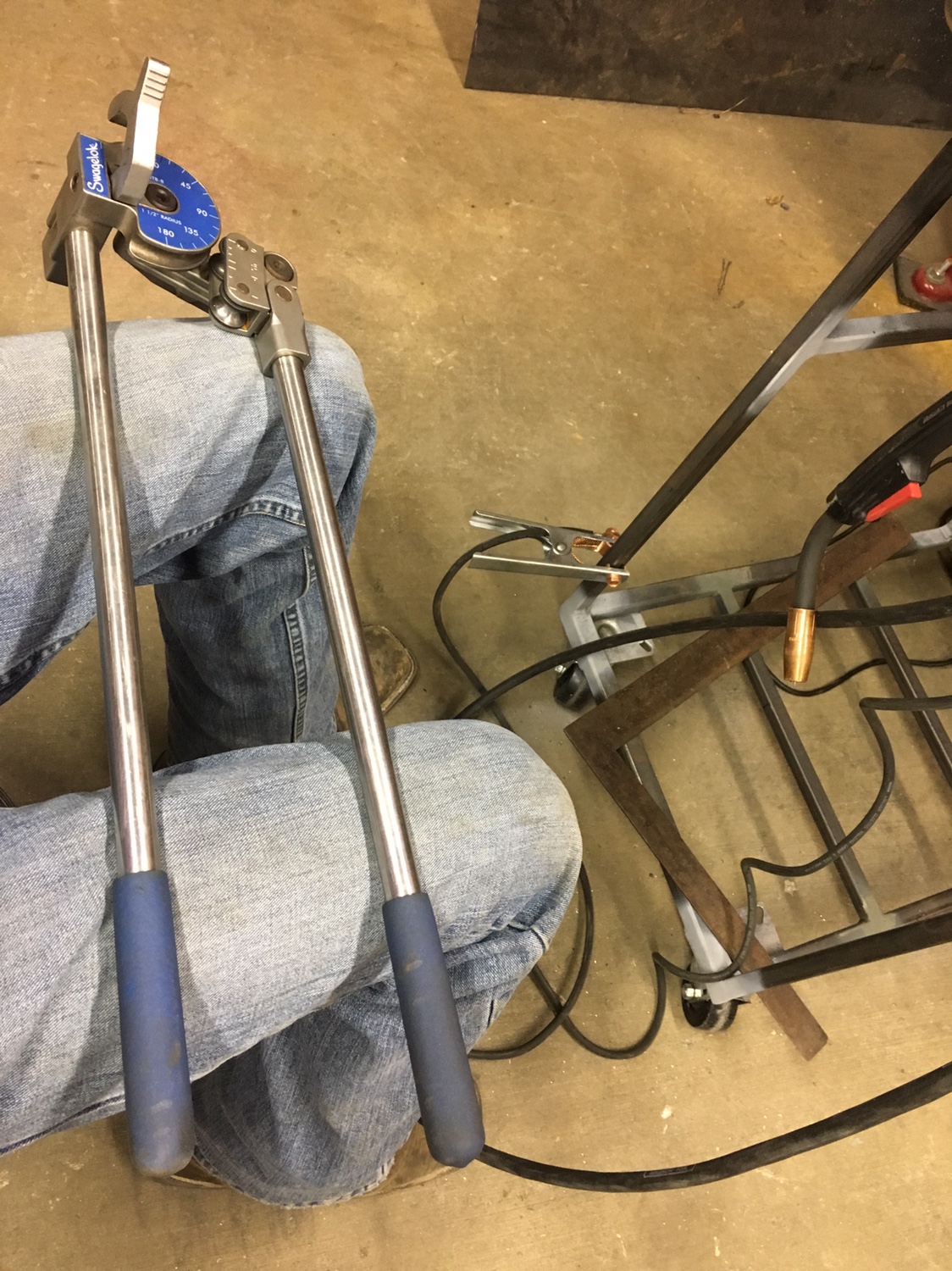

A little more progress on the welding cart. I brought home a set of tubing benders from work and used them to build some handles and hooks to roll up leads on etc. Also made a small rack to hold my can of nozzle gel. It was a little tricky using the wire gun to weld the stainless tubing but I finally got the rhythm and made it all work.
And finally got the sheet metal for the top
cut and riveted to the frame, and the welder bolted in place.
