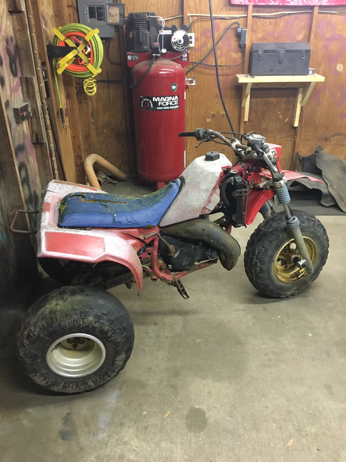

In January I got an 85 Honda ATC 250R that belonged to a friend of mine and began trying to restore it for him, which led to even more time that the car went without being touched.
It was a heap when I brought it home but that has always been a favorite of mine, it's gonna be an ongoing project but it's on it's way to looking good again.

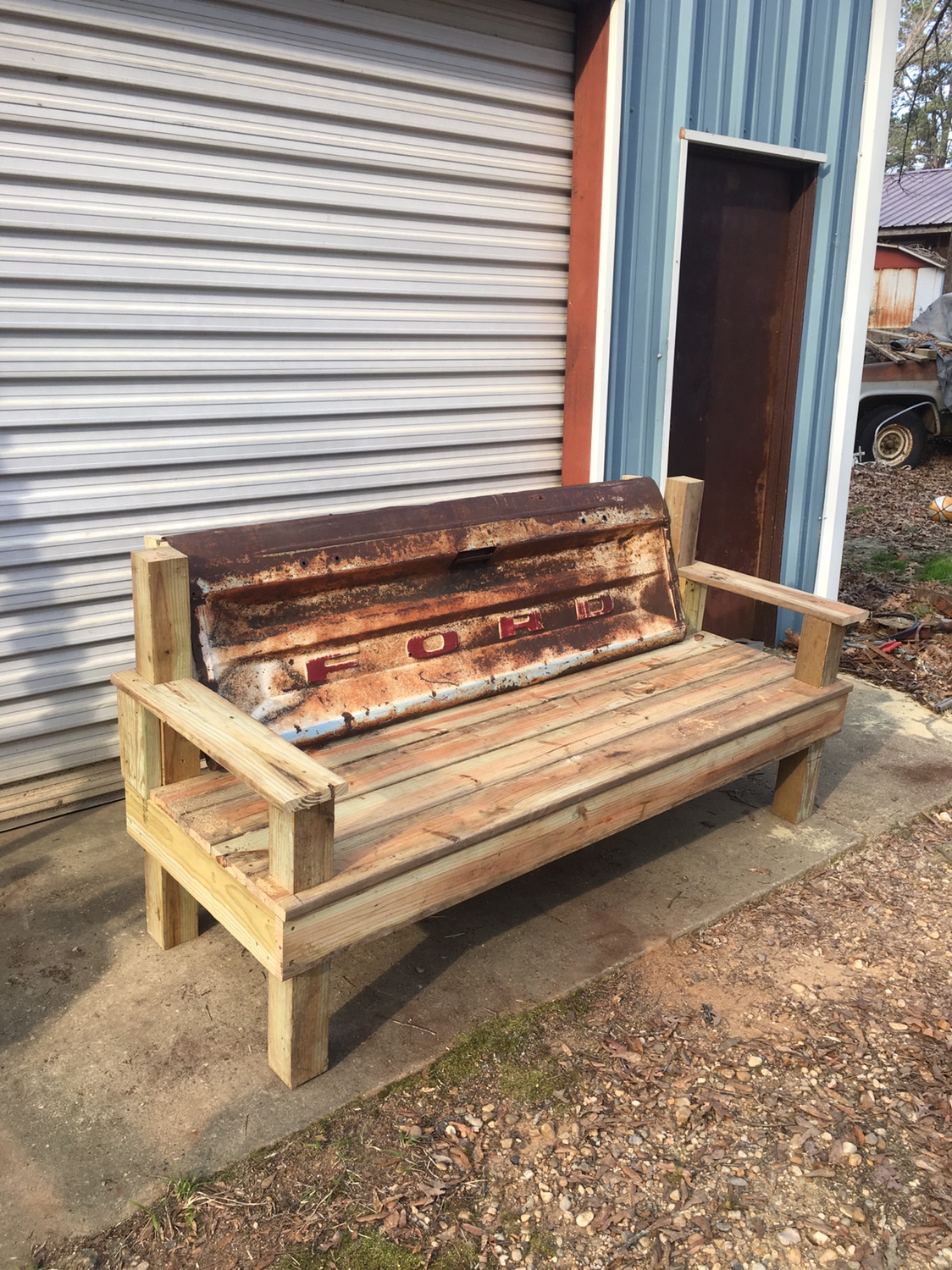

Me and my dad built a bench for my future shop using an old tailgate that used to be on my grandpa's 76 F100.

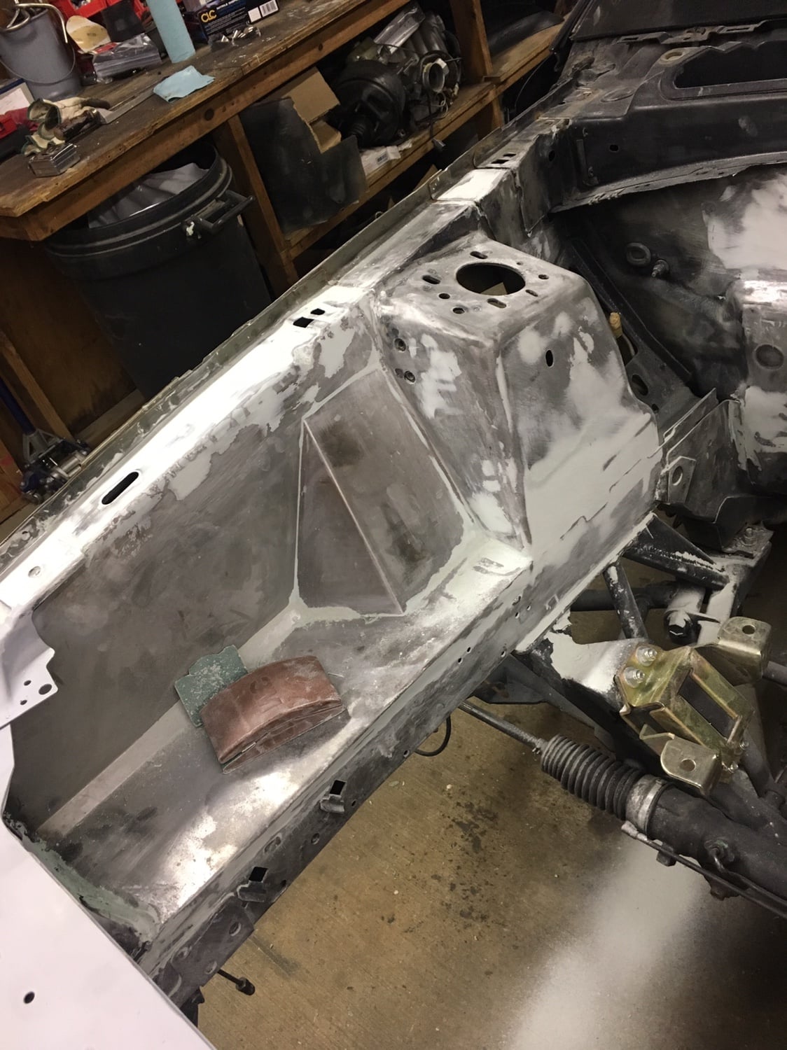

The last week of March/first week of April me and a buddy got busy working on the car again. I can finally say that all of the body work in the engine bay is now done.

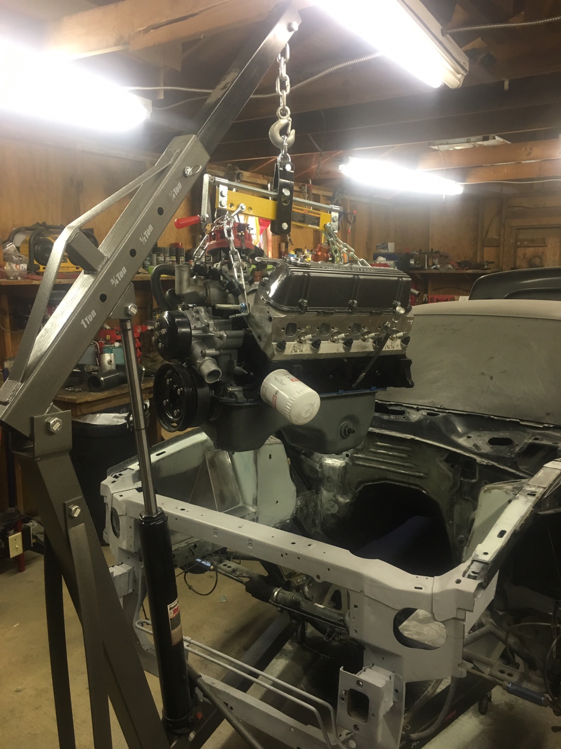

Shortly after that, I set the engine in the car and mocked up the intake and cold air pipe to see where I needed to cut my whole through the Scottrod panels.
For now, when the car is done I'll just use the intake pipe as I had it before. But in the future I want to get a solid pipe made, and get rid of the rubber sleeve in the middle. Buuut I don't want to pay the outrageous price for an Anderson power pipe.

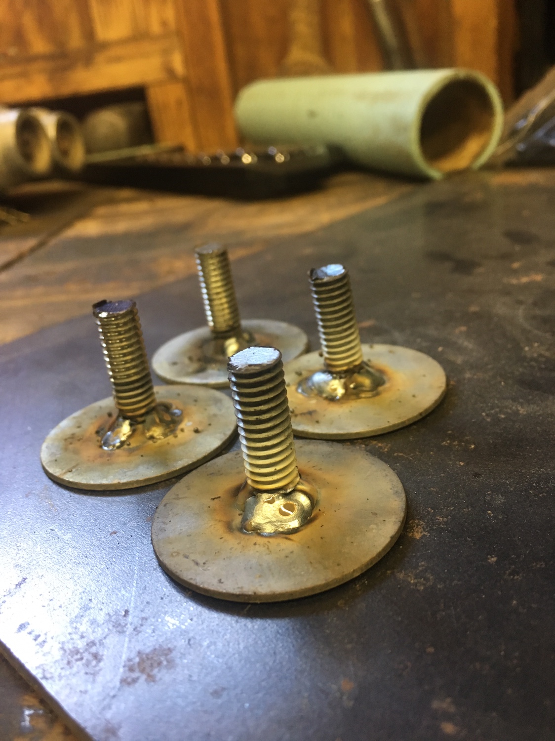

Last week I started on my battery relocation project. To start off, I got some big fender washers and welded some 1" long pieces of 5/16" all thread to them.

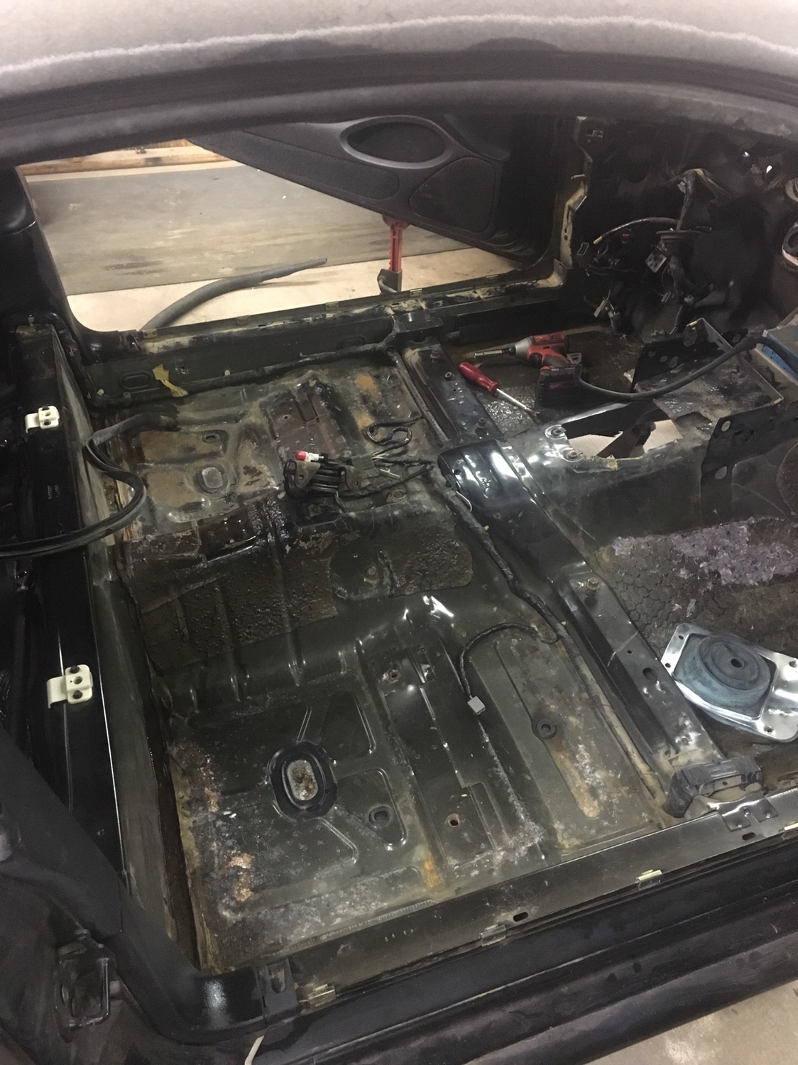

Pulled the seats, harnesses, and carpet out of the car for a good cleaning and to be able to run my battery cable through the car. I'm gonna try to sell the SVE seats and the harnesses. I want to go back with some better seats, and 5 point cam lock harnesses.
^^^that was about an hour ago, now we're back to the present lol. I finally cleaned all the mildew and crap out of the interior that appeared while the car was in the other shop too. I need to pull the engine back out of the car now that the hole is cut. After that we should be ready to prime and paint everything, then I can start putting all of this massive puzzle back together.
