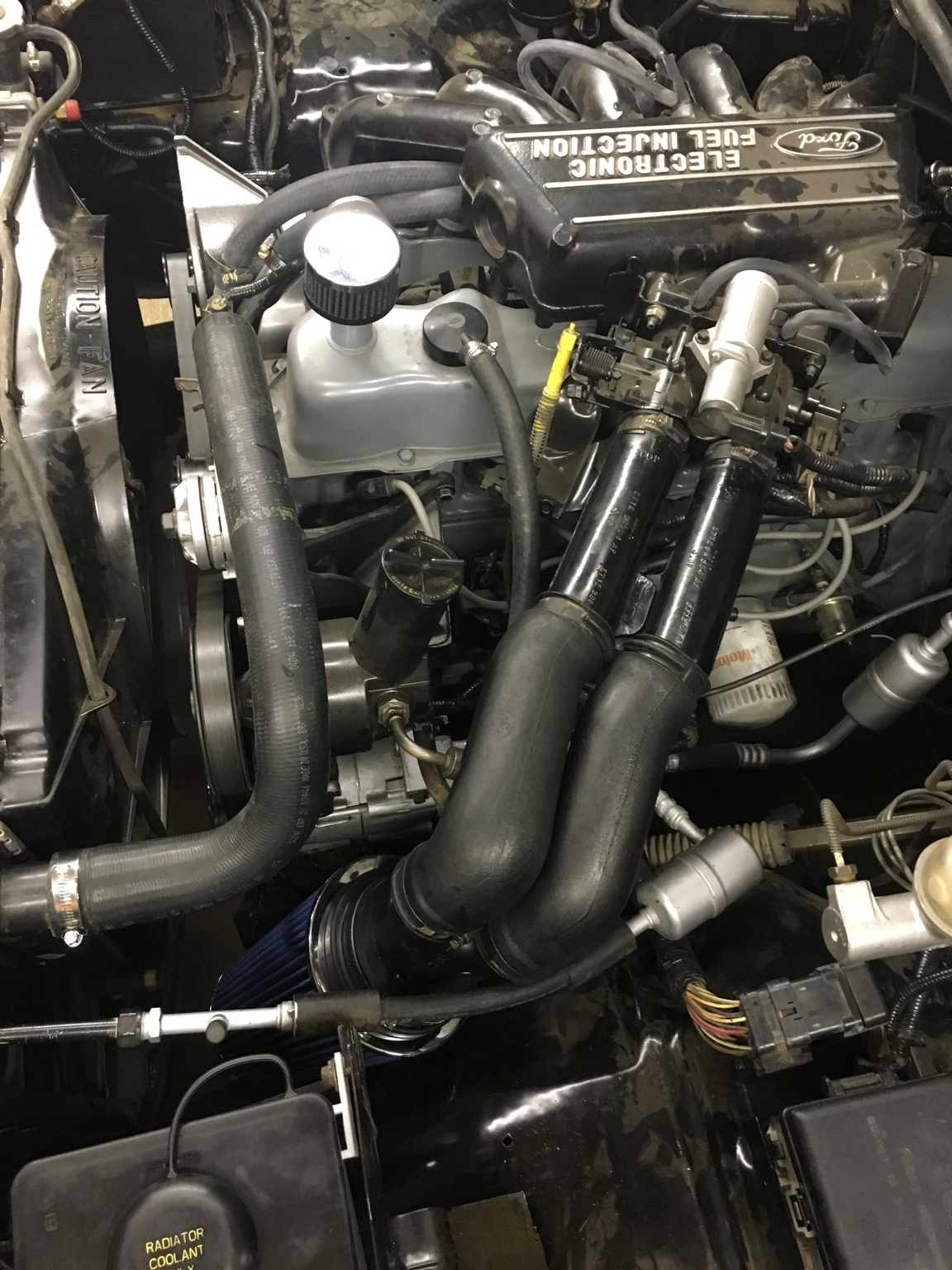

Closer to running but still no cigar. Sunday night we hooked up the starter cables and put a brand new battery in and tried to fire it, but could only get it to run by spraying ether in the intake. Checked the injectors and the spark plugs and both are firing so that leads us to believe it's a fuel pressure related issue...probably either filter or regulator since the pump is new. We haven't had a chance to look into it just yet. But we were able to bolt the bed down and put the interior back together, as well as finishing up the new brakes in the front and checking that all of the new front suspension was tight. Front wheels are now back on and the truck is on the ground again. And I changed my mind one more time on the intake tube setup, it's a little bit of a twist on my original idea but I really like how it turned out and will hopefully be staying this way now.
