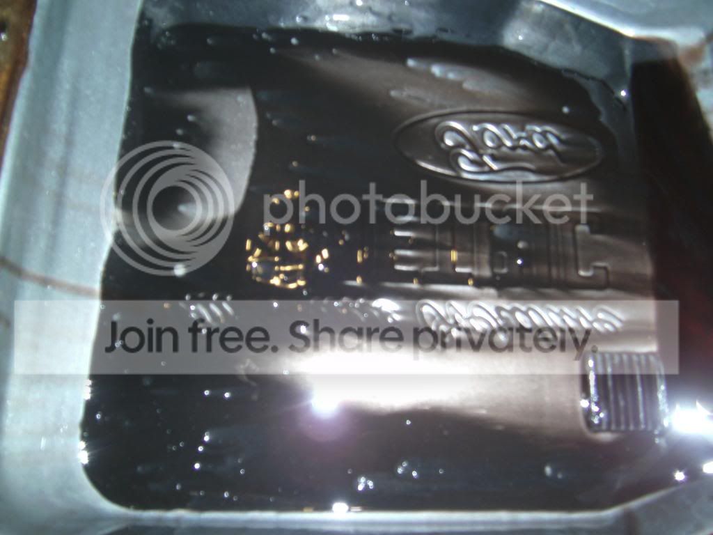

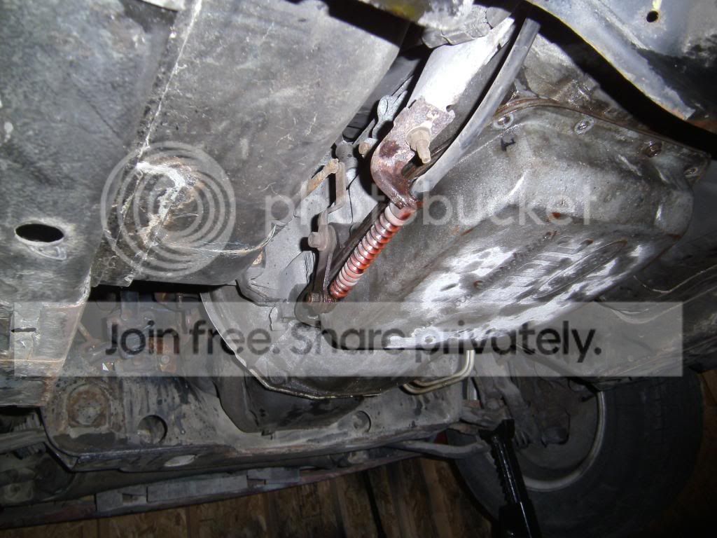

I used some ZEP on all the bolts after I got the car on jacks and then I sat around and smoked a few cigs. I pulled the trans pan to drain it and see in the pic how much sludge was in the bottom and it smelth like a wildfire..Then I got the exhaust studs with no problem actually which is a 1st on any car ive ever worked on and took off a few of the braces underneath...only worked at it for about an hour and half and I think getting this trans out is gonna be pretty easy. Friday im going to go after the drive shaft which requires me to lower my gastank a few inches so I can slide it out and ille probly end up getting at the trans its self if not have it out by the end of Friday night...

metal in the pan is baaad.

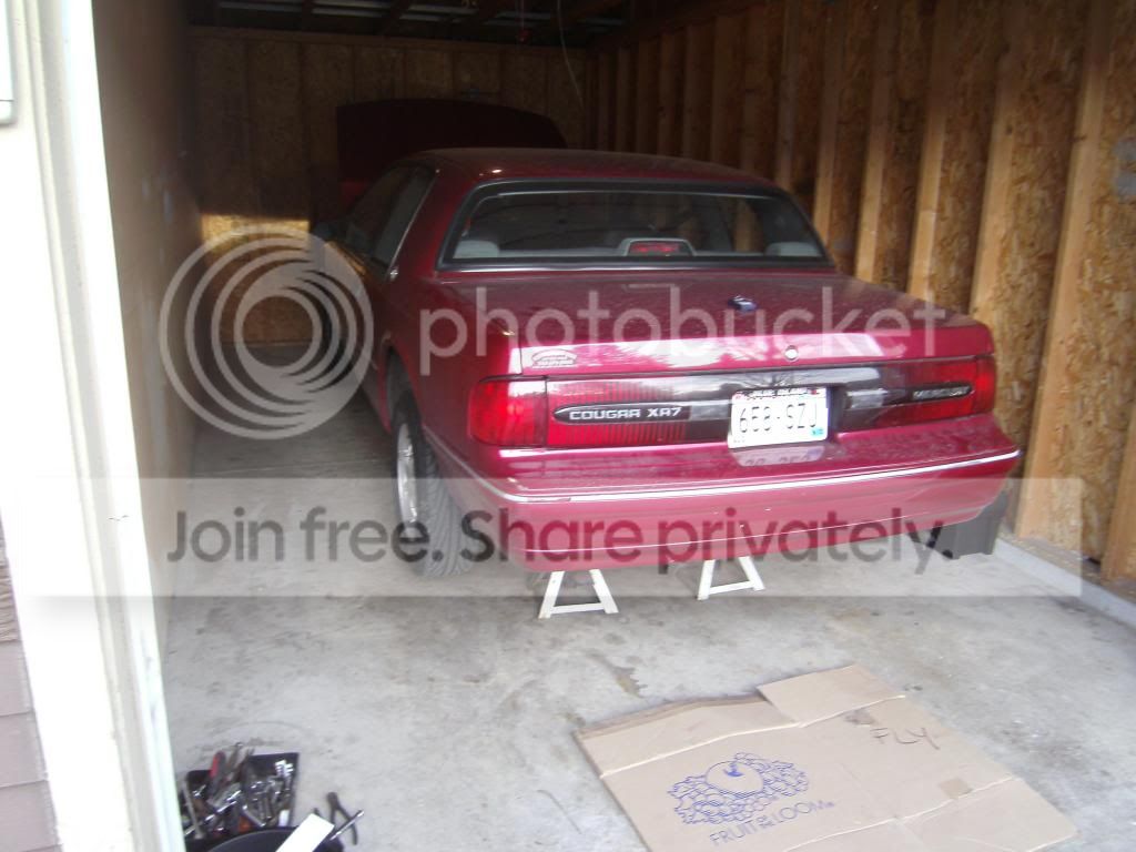

It doesn't look like the car is high enough. At least the front anyway. If it's not hi enough then the trans won't slide out from under the car.
Your going to need help and a floor jack at least. You'll need another jack or jack stand to support the front of the engine after the trans is removed.
Don't forget the torque converter bolts too.

If your pulling the driveshaft Mark where it's at so when you install it you can line it back up. If you don't your gonna **** some shit up, you'll feel like your car is trying to shake itself dry.

A coulple mn12 5.0 guru's ive been talking with said I wont have to remove my drive shaft or gas tank, I should be ABLE to disconnect the driveshaft from the tailhousing and it should move around enough to slide the trans out and back...
and I got the cafr on jacks, and yes it may need to be raised abit more to get the trans out from underneath but ille worry ABOUT that when its time to get it dropped, that the highest my jack would go..ille have to use another one when the time gets closer..i still am amazed at how easy that exhaust was coming off, usually those exhaust studs into the headers on stock systems are horrible,i just tightened it like a 1/4 turn and it broke them free no problem..
I also had NO metal material in my trans fluid or on that magnet in the pan just a bunch of sludge at the bottom and the fluid was brown not even close to red..

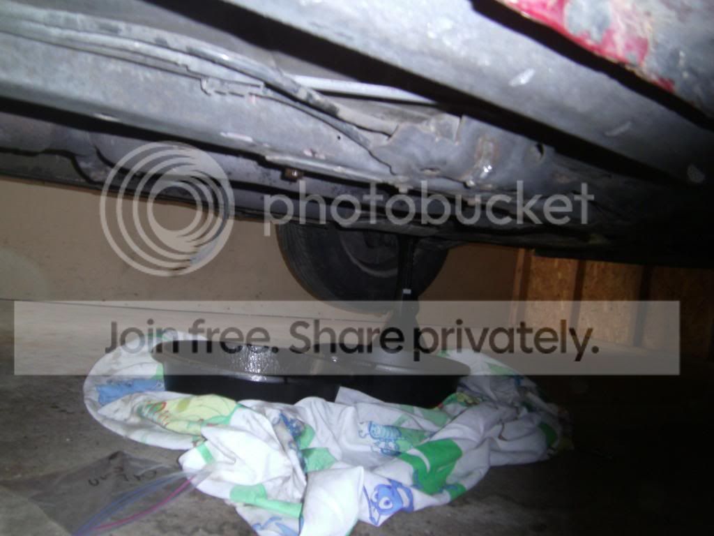

Mission 1 accomplished. she out with not one single problem, and honestly I don't think I even cussed at it or got upset once...woooooow something is wrong as car work NEVER goes this easy for me.Ive spent this long changing front pads on my old blazer, the trans I could lifted by my self even, buuut I did drain the Tc last night by removing that liittle bolt init since it was exposed and about another quart or two came out atleast...
