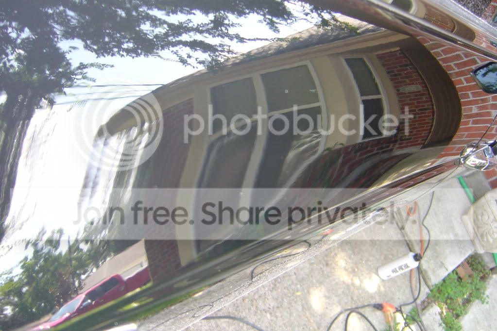

Finally got around to fixing some scratches.
daves94vert
Nov 24, 2009
193
Our dog got a little excited when the rear window was down. My daughter approached the car, while picking her up at a friend's house, and our dog (Lucy) went a little crazy.
Before:
Started with CG scratch and swirl then switched to M105 and an LC orange pad with the makita rotary.
Finished with CG Pro polish on a LC white pad with the flex 3401 Haven't waxed yet. I'll do it this weekend (it's a lease car).
I'll probably seal with some blackfire then wax with a little wet obsession.
