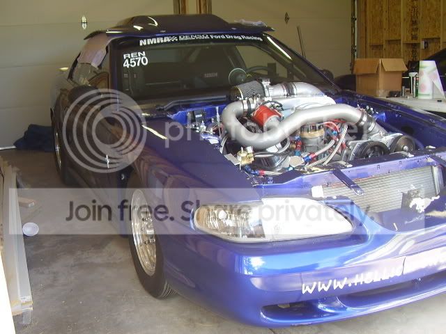

Ahh, finished...

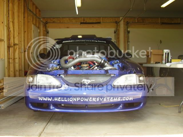

Sits nice
Reppin' the ProCharger powa!

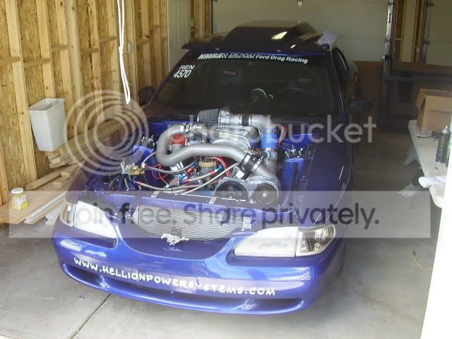

Motor shot.

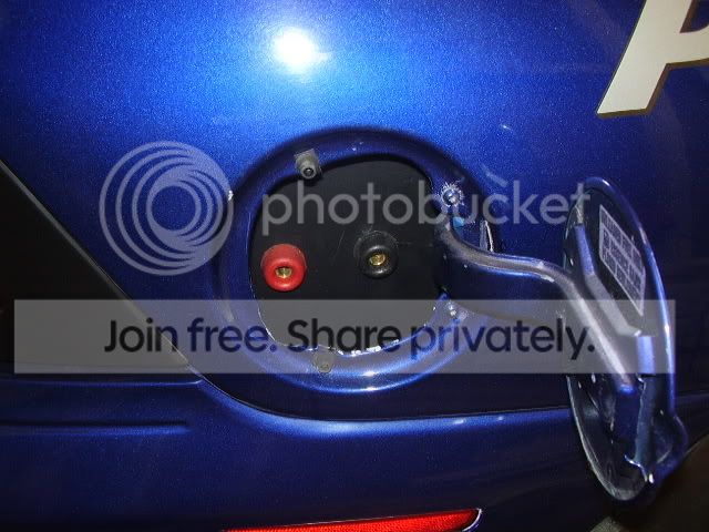

battery charging posts in the fuel filler door.

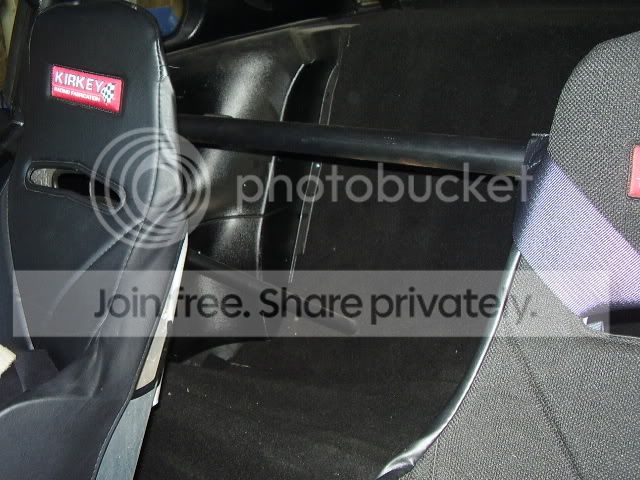

Finished interior

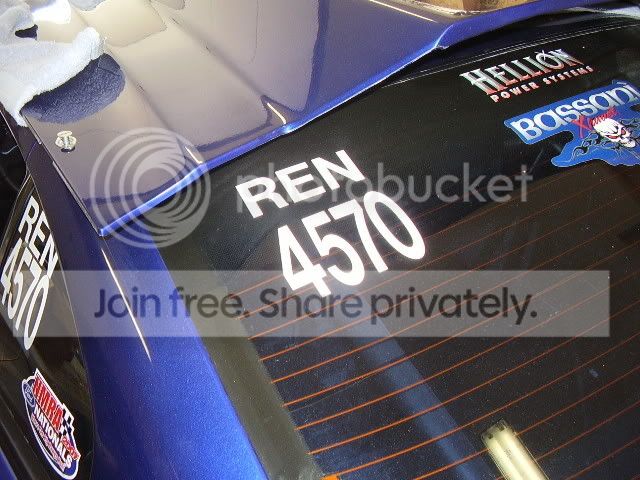

Renegade number 4570...
