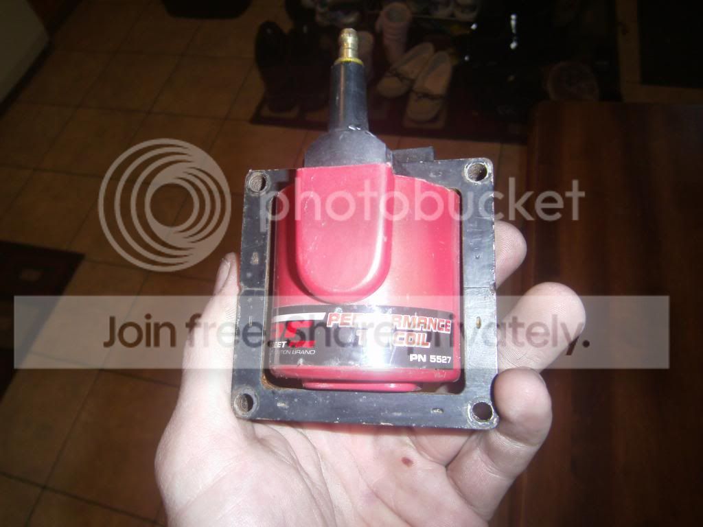

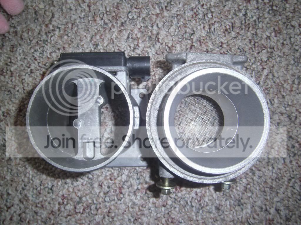

look what I got today for 40 bucks, SCORE !!!!! I sold my painted gt40 for 200 and got this stuff and have some left for other stuff I may need, also my side skirts came today in the mail !!! I also put the 70mm mafs on and adapted it to the stock air box,deleted the air silencer and put on the msd coil, lol and actually I feel a difference and the car runs great..I will do the gt40 swap when I get a 70mm throttlebody
WOW, look at how small that 5.0 mafs is off of my car, that opening in it cant be larger than 50mm and it has a screen in front of it too..Cmon ford..

Make sure you get your MAF recalibrated or your car will run for shit.....

nightmare, yes my lower looks exactly like that with the offset runners, mine is an explorer gt40, not gt40 tubular...same flow number but I think mine will provide m1-2 less HP,lol....don't get me wrong those tubulars are very sweet looking but I cannot afford one..and are you shur ille need to calibrate my mafs???? why?? I know its larger but that little bit it is cant the ecu compensate for?? its on and running great, actually beter than with the other stuff on and more power and better engine growl.

I believe you should still have a form of the a9l computer. That is still what is considered an "early" form of mass air, and you will need to have the sensor recalibrated for what ever injectors you want to run at the sensor its self.....You change it up so often....never know if you are running the stock 19's or stepping it up to 24's, 32's or 36's.
