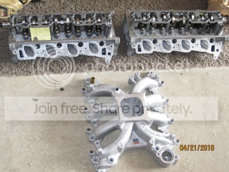

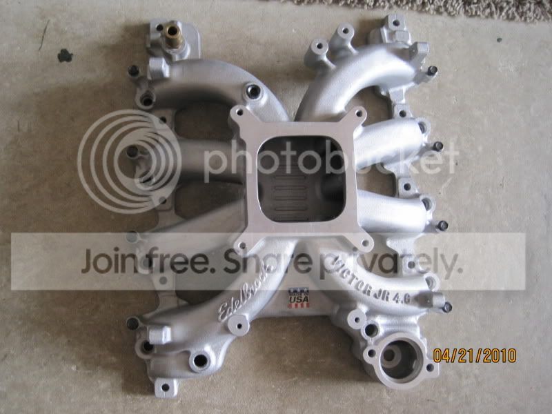

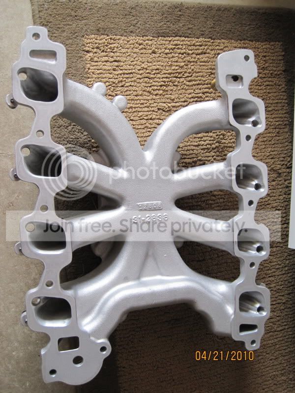

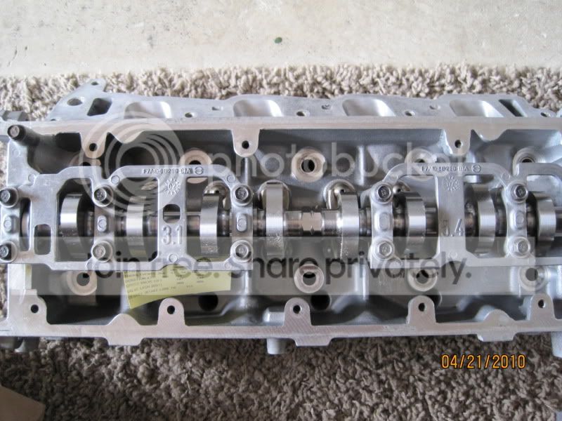

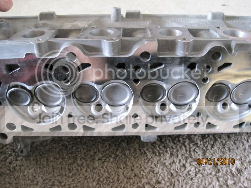

Well after waiting some time, finally got my heads/cams/intake back. I had sent stock PI heads to MMR for their Stage 3 port polish job. They also port matched my Edelbrock Victor Jr EFI manifold, installed my CMS Stage 3 blower cams, installed Crower high lift valve springs, and installed new lash adjusters.
Within next few weeks, I will be ordering my rods/pistons kit. I already have a forged 8 bolt cobra crank with 8 bolt flexplate, so once i get rods/pistons i can start putting the motor back together. I am getting my block .020 over as well.
