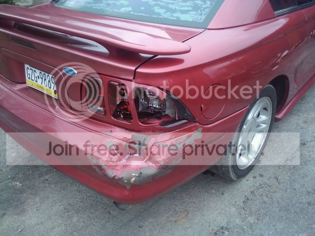

Yep I had parked mine in front of my buddies garage thats on a slight hill. Had it in gear with the parking brake up alil (never felt like it held well), bout an our later I look out hi window to see my car sitting in front of his barn. On the way down it hit his Ranger and stopped on a old drit bike 3 feet from hitting his 91 GT, thankfully the bike and Ranger stopped it. All in all damage was somewhat minimal and no major sheet metal damage was done thankfully. Heres the after pic,
