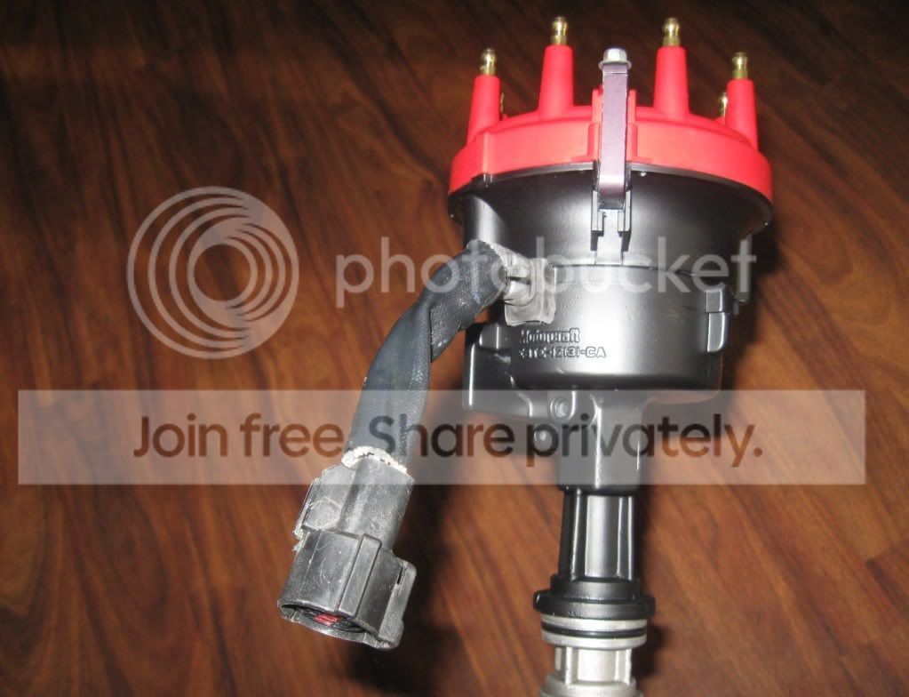

Got around to repainting the dizzy today. Going to have all the brackets and everything else looking nice and pretty soon enough. Also decided to go with a set of 240cc Trickflow High Port heads set up by Ed Curtis for the new cylinder heads. Should be buying those when I get my tax return back.

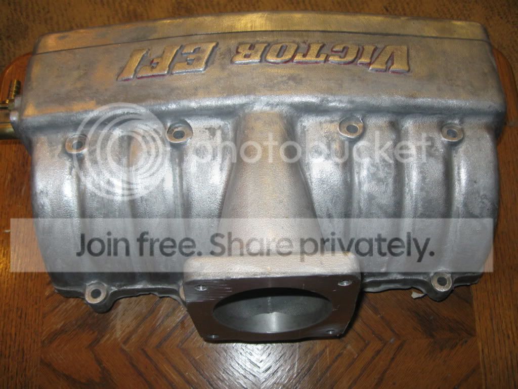

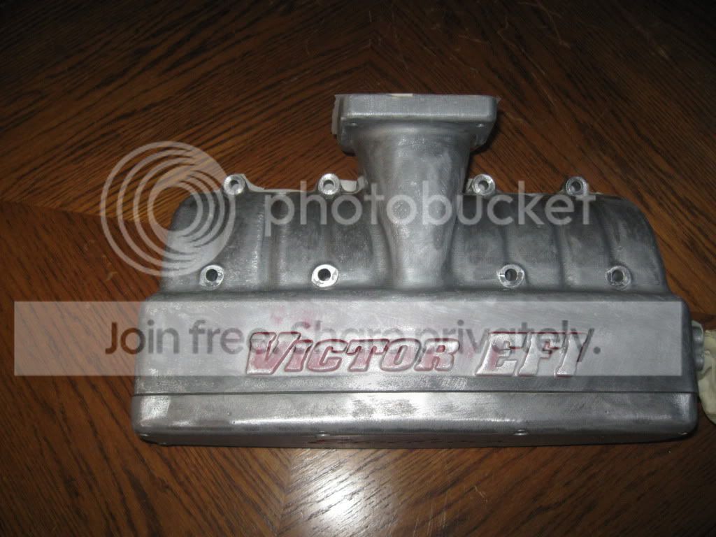

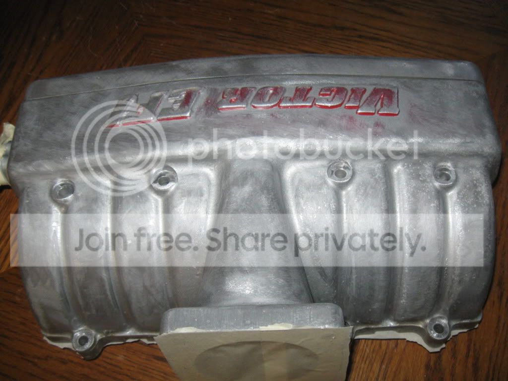

Started to strip the upper intake today to save some coin when it comes to powder coating it.
These are just w/ the stripping wheel on a drill
This is after 3 coats of aircraft stripper and some more stripping wheel and wire brush work
