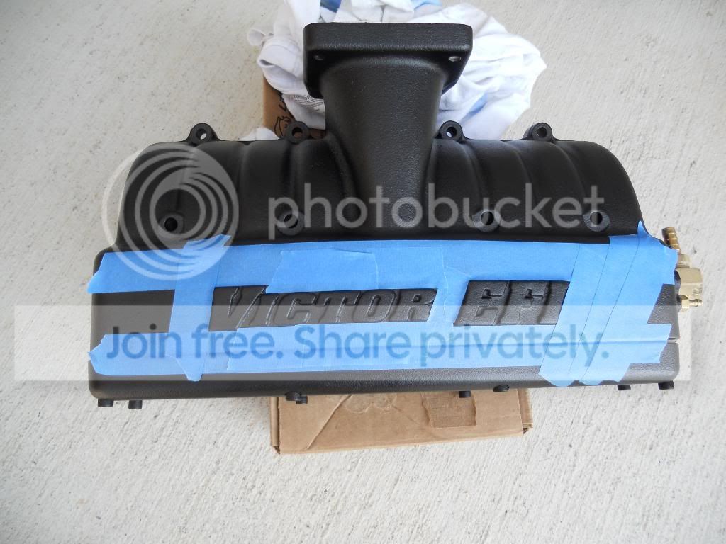

The Upper/Lower intake and accessory brackets have been sand blasted and should be getting powder coat soon

All going to be wrinkle black but the lettering on the upper will be polished

Powdercoating looks good. Shoulda sanded the stuff down first though - would've given you a nice, smooth finish and more sheen.

I was happy with how everything came out, plus I got it for free minus the cost of shipping and sandblasting. Just can't wait to get it all back now

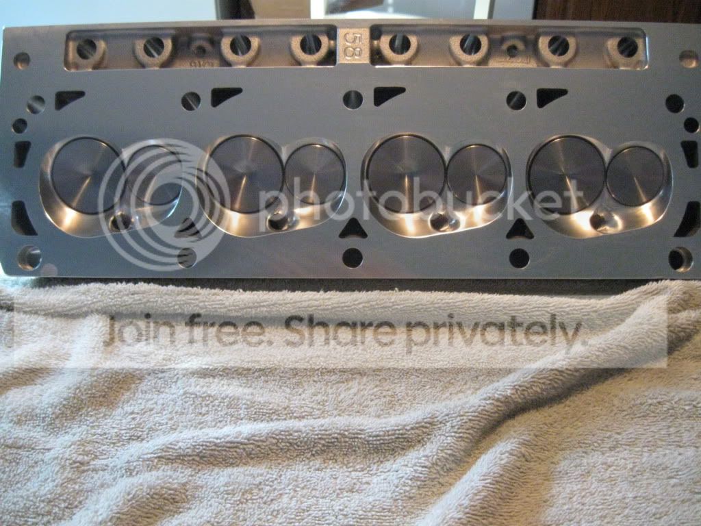

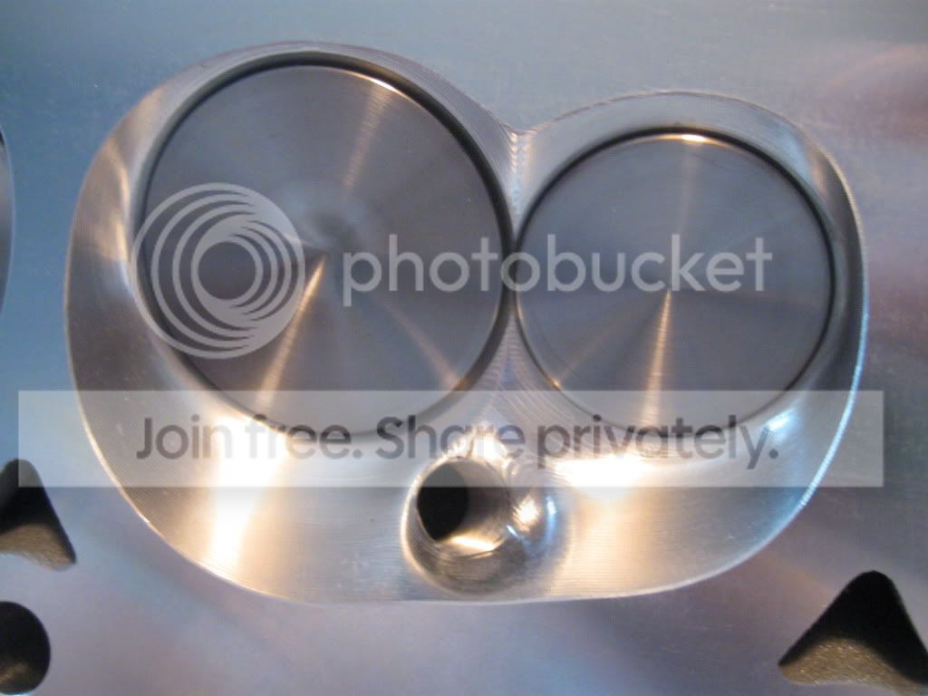

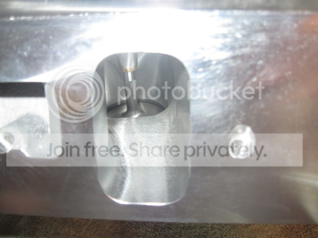

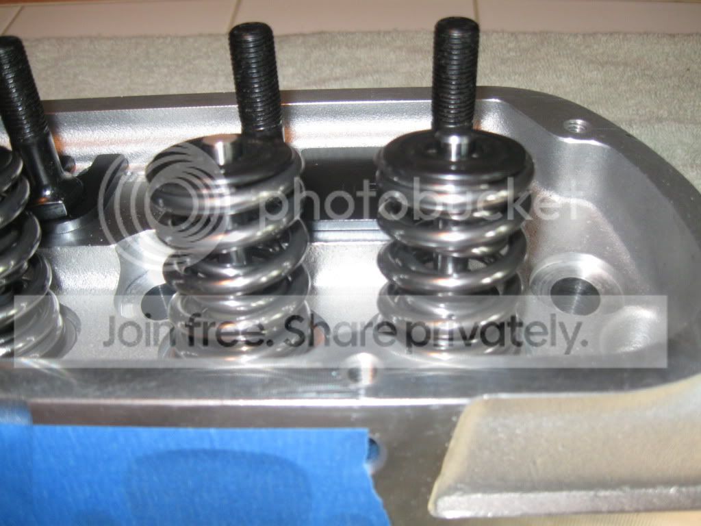

Well after 3 long months the cylinder heads are finally done!!!!!! Ed shipped them to me yesterday. He said he enclosed a "gift" I was hoping it was a free set of roller rockers but I found out later that its an additional bill for $140 lol thanks Ed.
Here are the head specs below.
TFS Custom CNC Ported 234HR High Port Heads
2.055? x 5/16? Super Alloy Intake Valves
1.600? x 5/16? Super Alloy Exhaust Valves
Lunati 73925 LSX Dual Valve Spring Kit
TFS Hardened Guide Paltes for 5/16? Push Rods
ARP Pro-Series 7/16? Rocker Arm Studs
Only Pics I have so far.

Well the heads came today. I have set of stock rear springs coming tomorrow so I can get the car back down on 4 wheels again and the powder coated items will be here saturday. Just have to order some head gaskets and then I can start to work on the correct push rod length and the PVC.
Here are some long awaited pics of the new heads.
As far as some more info on the heads here are the flow numbers.
Lift Intake Exhaust
.100" ..80 .58
.200" 142 115
.300" 196 150
.400" 258 190
.500" 304 215
.550" 320 220
.600" 333 222
.650" 340 230
.700" 334 236
.750" 340 238
The heads also use 5/16" valve stem, not the standard 11/32" stems. These valves are over 20% lighter then the competition. As quoted by Ed. He said this valve train with the correct push rods will spin up the lower 7K range. They are also 64cc Combustion chambers.
