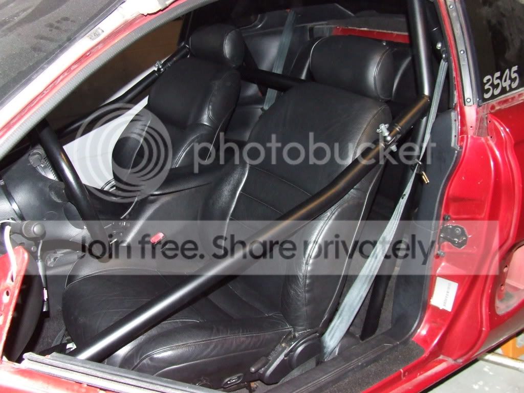

i want to do something a little different with my roll bar, but i also want to see how everyone mounted theirs. id like to see pics of where you welded them to the floor.
this is just a mock up but i am considering to do something like this; welding the roll bar to some custom plates on the torque boxes. not sure if this is the best idea or not but i think it would look clean

just a suggestion, if you cut the panel BEHIND the bar it would not stick out so bad. From the seat belt notch down rather then the bottom up.

in that case i would need to cut the roll bar down the middle and lengthen it about an inch. thats what i was going to do but i decided against it

cutting the panel from the top down would make no difference on the length of the bar nor need for the bar to be cut. It would just make the bar cover the cut made to slide it over the bar.
37,643
7,761
start at the top of the panel where the seat belt comes out and cut down into the hole you made. Now when you slide the cover over(from the front which would seem easier as well) the line you cut will be directly behind the roll bar.

i considered that and like i said, this is just a mock for now. my main point of this thread was to see where and how people are mounting their roll bars to the floor
