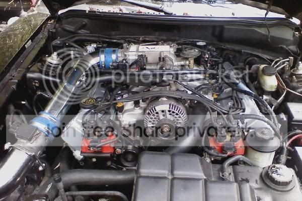

ON thing is your itake setup you need to take into view, If I read it correctly your running an Edelbrock intake manifold with an upper shark plenum. I thought and I could be wrong but those intakes are not that great when it comes to power making unless you ride that bad boy in the high rpm range. I would say thats why your torque is so low. Would like to see a dyno sheet and also get some pics of your engine bay.
Where are your peak numbers happening, at what RPM?

this is the only picture i can find right now, and now its dark at my house lol, will pose more current pics tomorrow...thats before the shark tooth plenum...but yeah man i never thought about how that intake operates at such high rpms...damn...you think a stock pi intake would of been better??? and i cant seem to find my dyno sheet :BangHead: but if i remeber correctly it made power all the way to 6k and had to let off of it b/c of the rev limiter i believe...

it looks like you have a stock upper plenum and tb with an aftermarket lower. there is a big restriction for you right there. after all you still are running stock ford heads i wouldnt expect too much from it even if they are " p.i " heads they are not that great
No i got an aftermarket plenum that pic is old is why u see the stock plenum and yeah p.i heads made a good bit of difference on the 96-98 Gts raises compression to 10:5:1 so it makes a differnece and i agree i'm gonna try the p.i intake the plastic one probably and a different plenum and see where that puts me...thanks guys...
