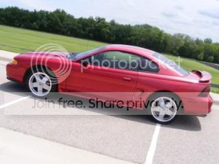

hey guys. just got lowering springs. their the eibach pro-kit. says that it lower my car and 1.5". is that true?
i have 18" wheels and i was wondering if they would rub. sort of scared to put them on and find out they do.
has anyone lowered their car and have the sized wheels? heres some pics

18 x 10's on the wheels
and 245/40 on the tires

you will be fine.
For the front, i have 18x9" saleen, 245/40 tire and coilovers. With the coilovers, my car has been lowered overall about 3"-3.5" (cant even stick my index finger between the tire and fender) I do rub, but then again, i am about 2" lower then the pro kit.
For the back, i have the eibach sportlines which lowers it 2". im running an 18x10" saleen with a 295 tires and don't rub at all.
So, you will be fine with prokits.

You will be fine I have sportlines front and back. Running 18X9 265-35 in the front and 18X10 285-35 in the rear. I have a 2 finger gap with no rubbing.
