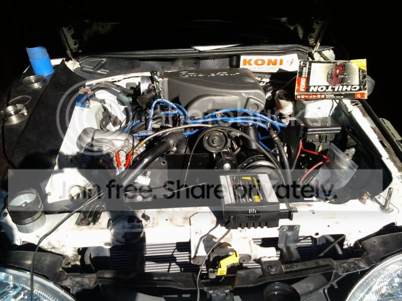

The engine bay, mostly done, need to organize the wires, plumb the oil cooler and new radiator, and general cleaning
Big ass t/b! Got a 80mm Accufab Foxbody throttle body and cable, then made a bracket to hold the throttle cable. works great, clears my tall valve covers with room to spare. Had to port the TFS track heat intake to fit, it had a good 5mm lip all around.

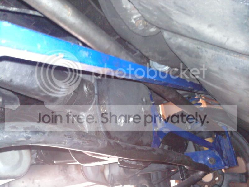

Panhard bar is IN! Gotta put in the upper control arms that came with the panhard bar, its going to have the Steeda 5 link in it when im done. probably go with some Griggs lower control arms with rod ends. Dont need the spring perches.... wonder why?

Didn't you already have a trick rear suspension setup back there?

No, just had drag race uppers and lowers and Koni coil-overs, 250# springs... suprised I didnt rip out a torque box. its all going away now....
