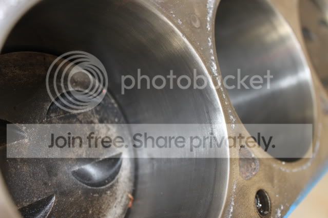

I'll be the first to admit that I don't know a lot about building motors so bare with me haha. That's what I was told when I bought the motor. I know I have receipts for the headwork but I cannot be sure that I have receipts for the motor being bored any. However, the pistons are def not new. I took some pictures of the piston walls, maybe you guys could tell if it looks as if it's been worked over any or not.

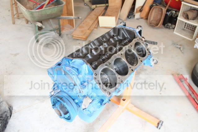

Here is the motor as it sat after I got home with it:
Here's some right after I got the heads off.
Also, what would be a good way to clean out the cylinders before I bolt all of this back together? I share a shop with my dad who does a lot of woodworking so I'm sure some dust got into them just from while I was pulling it apart but I plan to be putting all of this back together at a buddy's shop.

It does look like the cylinder walls have been at least cleaned up.
Only way to tell if they've been bored is to measure with a caliper or mic.

Use compressed air and just blow the bores out. Itll be fine. You have some run of the mill rebuilder .030 pistons in it. Had the same ones in one of my old 302 motors.
