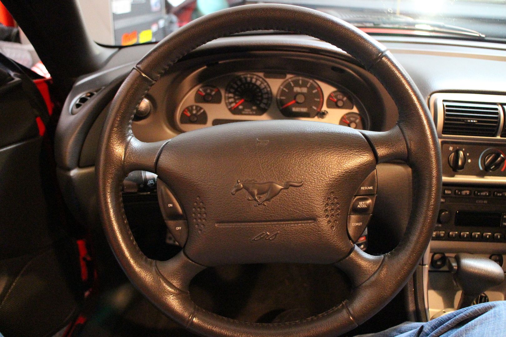

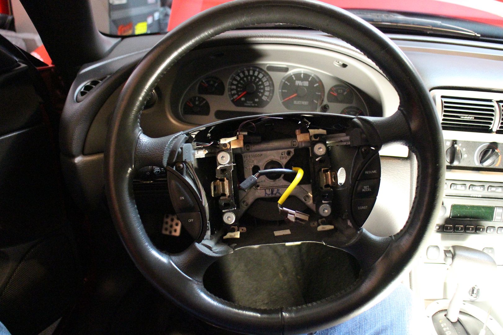

Also installed my Cobra steering wheel. I had this on a former 2002 Saleen project and kept it when that project sold (put the original wheel back on it).
I like the feel of this Cobra wheel, so it's gonna be staying in the Mach for a while!
