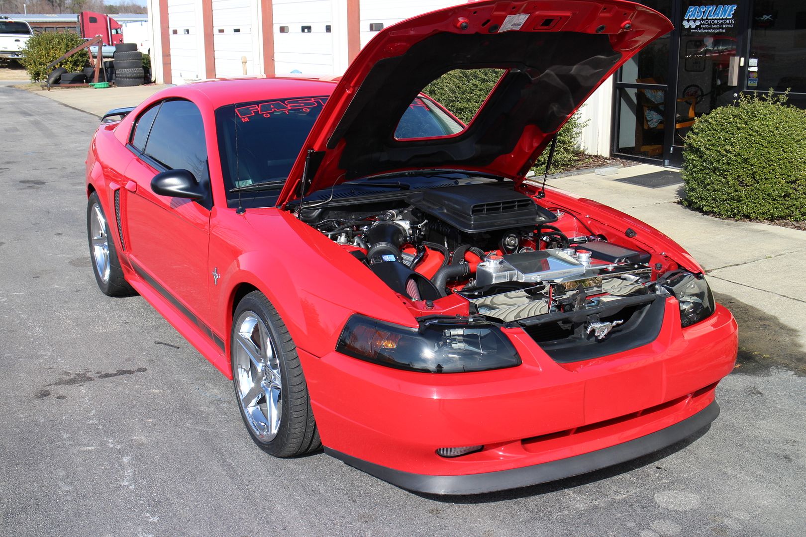

Right off the street with my start up tune, the car laid down 400rwhp and 8 pounds of boost.
I swapped the 3.0 upper for a 2.8 upper pulley.
Caleb adjusted the tune by adding more timing.
Air/fuel was around 11.2. Timing was 17 degrees. Final boost was 10 pounds.
Car responded with 472rwhp and 400rwtq!
I was very pleased with the results. Considering I am running the underdrive 6.5" lower crank pulley!
Car drives like a champ! I love it with the 4.10 gears!
Video coming soon.
