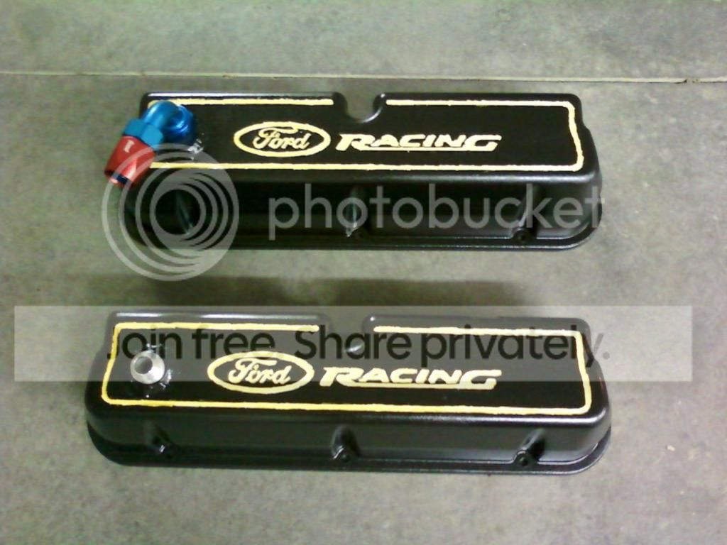

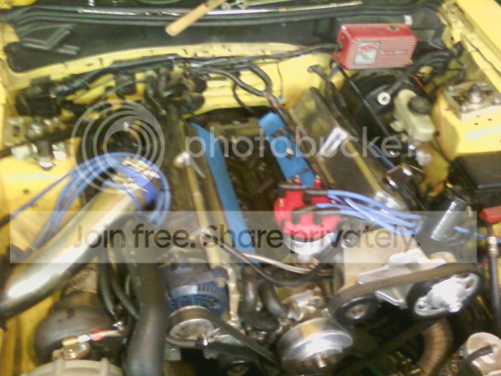

Been quite a while since I updated this last. Havnt driven the car much due to blow-by issues. Been busy with school and work to get much done with it but over the past week I ordered all the parts for my catch can set up and went to work....
Wire tuck in progress....
Welded bungs on my valve covers and catch can for the AN fittings...
And painted the valve covers wrinkle black.....
