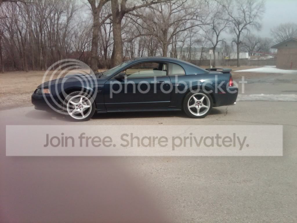

I I JUST PUT ON A FULL KENNEY BROWN SUSPENSION KIT ALONG WITH FRAME CONNECTORS AND SWITCHED REAR END OUT TO 01 COBRA IRS. I HAVE EIBACH SPORTLINE SPRINGS ALL AROUND AND NOW THAT MY CAR IS LOWERED THE FRONT WHEELS LOOK LIKE THEY ARE GOING TOWARDS THE REAR OF THE CAR IT HAS BEEN ALIGNED AND DRIVES FINE THIS JUST BUGS THE CRAP OUT OF ME CAN SOMEONE GIVE ME ANY IDEAS AS TO WHAT TO DO. OH AND CAPS IS STUCK SRRY :drunken_smilie: HERE IS A PIC OF HOW IT LOOKS AND YOU WILL NOTICE IT.

help us help you.
get us a pic with the wheels straight. Also, get down a little lower so its more of a straight picture. And keep your thumb out of the lens :p

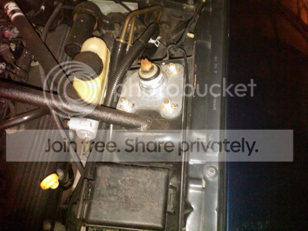

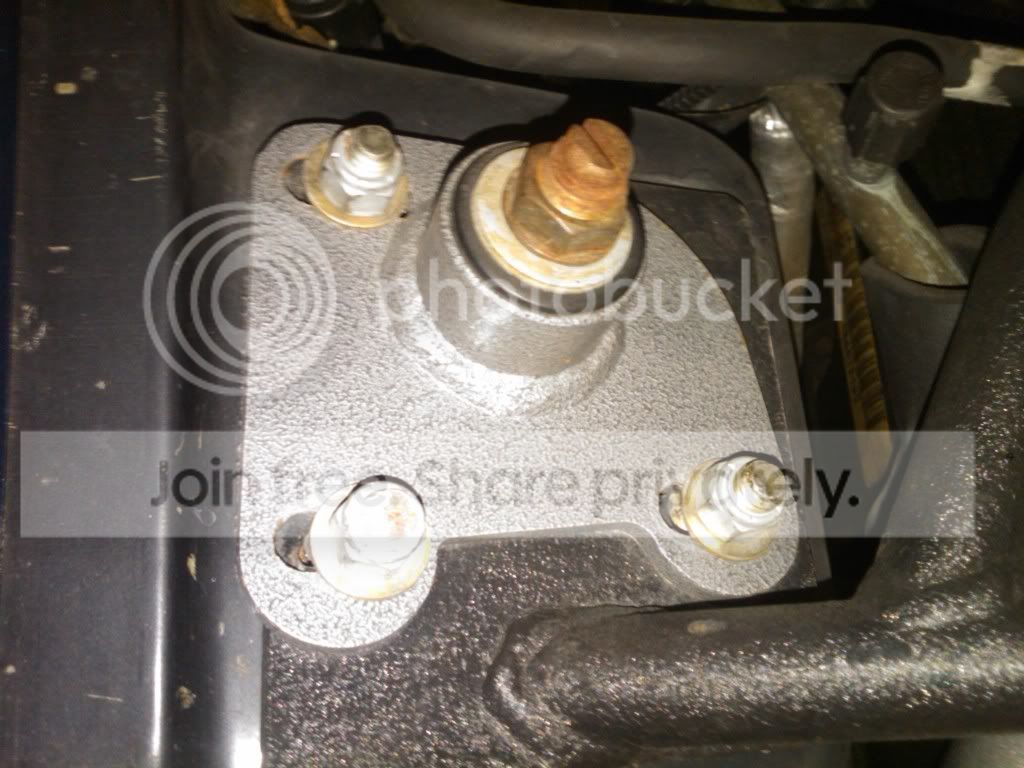

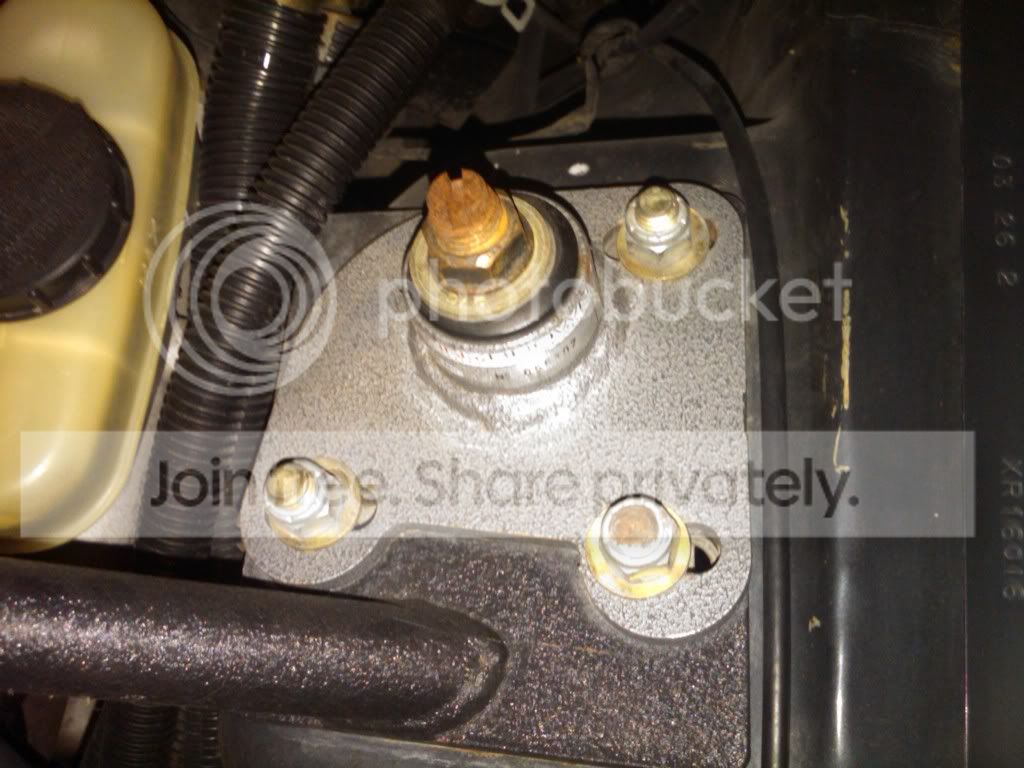

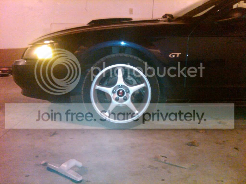

these are the pics i could get of the caster plates and with the wheel strait. ill get it in the air to get pics of a arms and k member , someone told me the other day i needed forward a-arms cant find anything like that.

ditch those camber plates. get something with more adjustability. i know youre balling on a budget but search the classified for MM camber plates. or double adjustable with 4 bolts.

I'm thinking it's in the K member/bottom arm mounts.
CC adjustment wont do anything to change that.

putting a arms on backwards is *probably* possible, but the sway-bar endlinks wouldnt fit.
if your a-arms only have 1 location for swaybar endlinks, and you have swaybar endlinks connected from your swaybar to your a-arm, your arms are on the correct sides.
as its been said, our K-members have a 1/2" of play in them. their is one "pivit bolt" that has 0 play. it is the *TOP* *REAR* (i think) bolt taht holds the k-member to the frame (under the master-cyliner, basically) the rest of the bolts have room to allow proper alignment of the k-member.
without additional pictures, i suggest crawling under your car with a tape measure and start taking a few measurements to ensure that your k-member is aligned properly....

frame is off! been there my 95 was salvage and the frame was not aligned correctly looked the same way!
x2 I had the exact problem.. Couldnt tell from the upper rail but underneath it was back about a inch bothered the crap out of me...
May 18, 2010
122
you were correct on the fram deal i put it on and used different measuring points was off 13 mm pulled and fixd as for the k member im gonna pull that forward a lil bit aswell.
