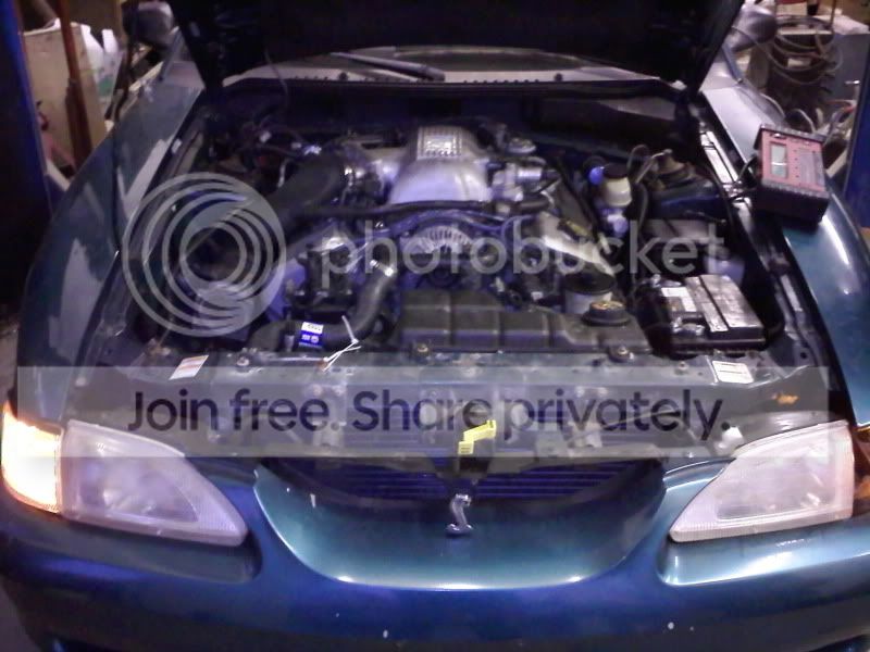

Thought the car was trying to run hot all this time. Radiator stopped up or something. but it turns out that the temperature sensor for the gauge in the cluster is the only problem. we hooked up a snap on diagnostics scanner to the car and it was reading around 190. the car was saying that it was hot as fire on the cluster for temperature. so i hooked up a test light on the e fan plug because we also thought that was part of the wiring that was different. well when it reached 207 degrees, the light lit up to my surprise. so i hooked up the fan and put it in its place (with zipties for now, ran a 96 radiator on a 98.. 96 is shorter) and it started operating fine. had to go by the scanner though but it was deffintaly not lying like that cluster gauge was. Glad that is behind me, that was starting to be a pain, and getting kinda hard to figure out what the deal is. just one of those things you never think of going bad on you.
and here are some recent pics of the motor, also a video of it running with the scanner readings vs the cluster reading.
